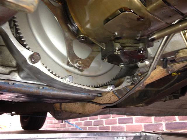

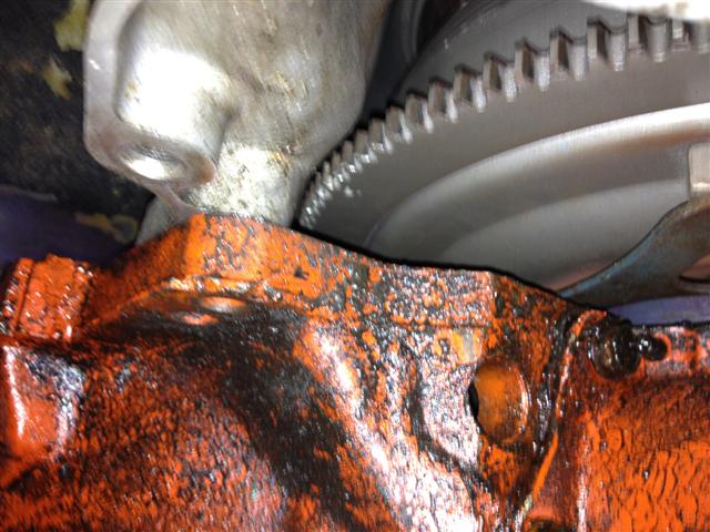

Hi all, hope you are managing to get out and about in this cruising sunshine 8-) I had a loud metallic knocking this week and found a bolt half out on my flex plate. The bolt was a stainless steel one and it was too long so appears to have reached the torque converter before tightening fully on the flex plate. Anyways, its stripped so ive successfully installed a helicoil and the correct bolt and loctite :thumbright: the info i've got says to torque them up to 270 inch pounds but I come up with different numbers when I convert it to Newton meters or foot pounds as thats all i have on my tourque wrenches. Now I accept I might be being a bit thicky McThick from thickshire but can any one :help: Oh and the second photo show a missing bolt from the engine to bell housing :shock: I presume there should be one :lol:

Photos are the wrong way round :oops: first one shows empty bolt hole :thumbright:
