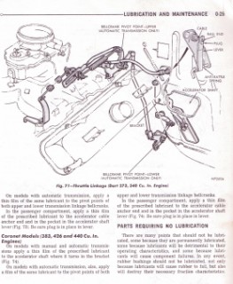

i think you will find your high gear clutch is goosed, try the band in case the timing is out, also be sure your linkage down from the carb is on and set correctly,,,,,,

cheers dunc ,ill climb under it in the week ,would it be worth running around the block with the kickdown disconected to see if it changes anything
terryr wrote:cheers dunc ,ill climb under it in the week ,would it be worth running around the block with the kickdown disconected to see if it changes anything
I wouldn't. It would only make things worse. Just check it is adjusted correctly. Also tighten the band until the adjuster is just snug and back off 2 1/4 turns.

Ad Duncan says even though the fluid looks OK it seams like there is to much movement in the top and reverse clutches. It a week point on the 904 the intermediate band and the clutches. The kick down linage control's the pressure in the box so if that not adjusted properly you will have problems
KICKDOWN1 [320x200].jpg (29.49 KiB) Viewed 643 times
