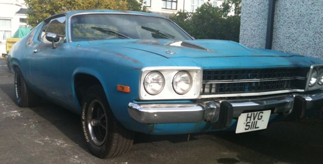

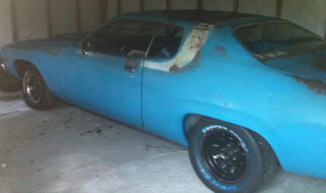

Hi chaps, I reckon my front end is sitting way too high. I fitted mahoosive rear tyres look to see if a 15" rear 14" front would give the desired look, but thefront remains obstinately high.
Sooo, lower front via torsion bars?
Also, reckon rear springs are pretty saggy and wonder if expensive mono springs would provide a better solution.
Opinions welcome :thumbright:

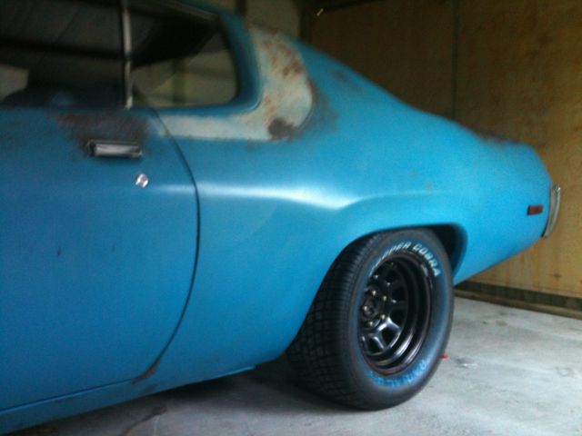

rear side

On a serious note, try lowering it by the bolts on the K frame first as it may have the desired affect asthetically to the rear

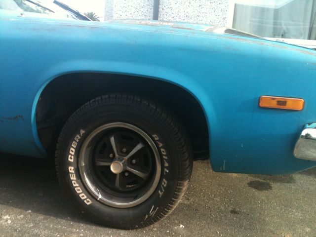

Mine is down as low as it will go on Torsion bars and looks like this with 15's and 235/60/15 on the front

turn the torsion bars down 3 turns run the car around to get it to settle re do trackng the back looks perfect to me just fit top quality shockers

Carl wrote:Mine is down as low as it will go on Torsion bars and looks like this with 15's and 235/60/15 on the front
Drop the front with the torsion bars , jack the car up first :thumbright:

Posts: 5235
front looks way too high
adjust it as per the service manual like this …
http://www.forbbodiesonly.com/moparforu ... ide-height
setting the correct ‘difference’ between the adjustment blade and the steering knuckle is the way to go as it doesn’t matter what wheels/tyres you’re running
I would do it this way then go up or down from there, whatever is your poison
