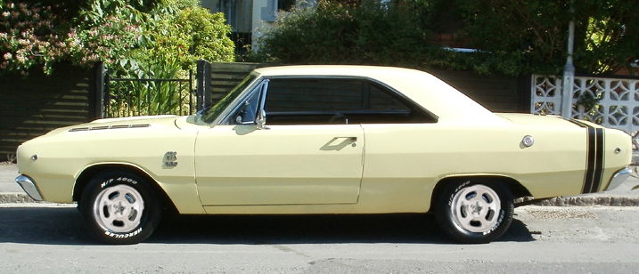

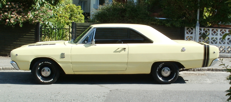

Have steelies on the car, also have dog dishes (not on at the mo, prefer the look). Fancy a set of ansen mags. Small bolt pattern. 15 x 7" 4" backspace, 4" PCD. Would these fit all round or would 6" on front be better? What do you think. Thanks, Gerry

I'm going to be massive hypocritical now.
But those dog dish wheels look the stuff!
Proper mean stance. :thumbright:
Posts: 1134
but summers coming, want to show a bit of leg!

The dog dishes look better I think, and im not a fan of the DD but they look great on yours 8-) :thumbright:

both look good :thumbright: Rallyes look good also :thumbright:
