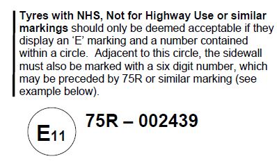

E markings are considered at the MOT test. If a tyre is marked with " Not for Highway use" it will pass at MOT if it has the following E mark. I think Matt is spot on though just because the tyre passes the MOTand you won't get a fine your safety has to be number 1 not to mention all your hard work and determination on the car going to waste. Listen to Duncans Pinto experience :thumbright: Swop onto these tyres when your at the Nats
not for highway.JPG (34.73 KiB) Viewed 1385 times

Yup, they are legal over here.... They are not in the UK.... By all means use them. Have an accident in them, you will not be insured! This whole thing came up a few years ago. They are DOT approved, but not for UK use.
You are right there Jeff. The insurance company would take one look at those after an accident and laugh all the way to the bank.
