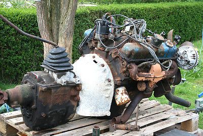

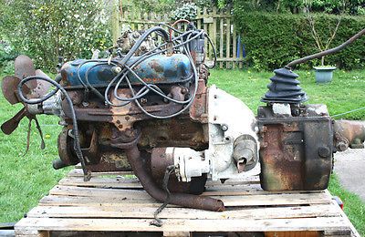

Ive had a quick read, and it looks like the box on the end of the 360 is a np435 not a A883.
Is this box less desirable ?
looks a bit big,although looks like an alloy bell housing.
If I buy it , I was planning to sell the fly wheel ,bell housing and gearbox , to help fund the engine.
But if it won't be easy to sell , I'm not sure what to do .
Any one got a cheap 360 ?
See pics.
Oops. Just noticed " manual "
Forget earlier post. Sorry :oops:

Yeah just seen that pic of the tranny :shock: ......... that ain't no good for a passenger car or even a pickup, that's a proper 'truck' transmission ;)
Although the bellhousing will fit LA blocks it probably won't bolt up to an A833.

Adrian Worman wrote:Yeah just seen that pic of the tranny :shock: ......... that ain't no good for a passenger car or even a pickup, that's a proper 'truck' transmission ;)
I think my idea of buying the engine and box, and selling the box, to help fund the engine has been scuppered :roll:
If I can't sell the box, as its not desirable, I might as well look elsewhere for just a 360 engine.
