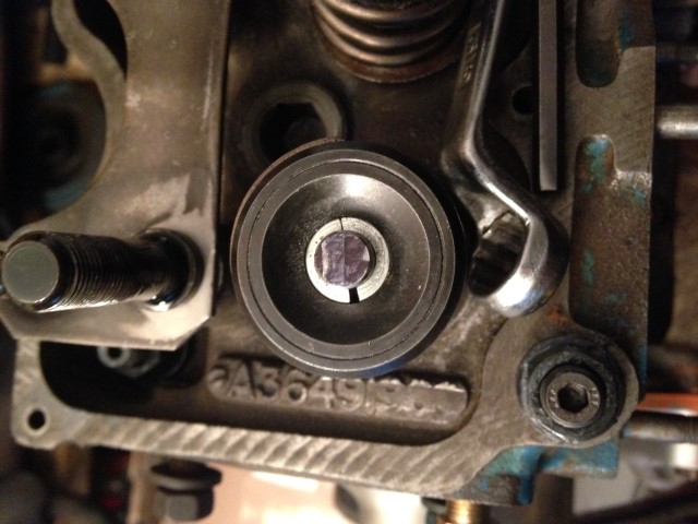

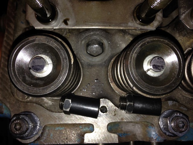

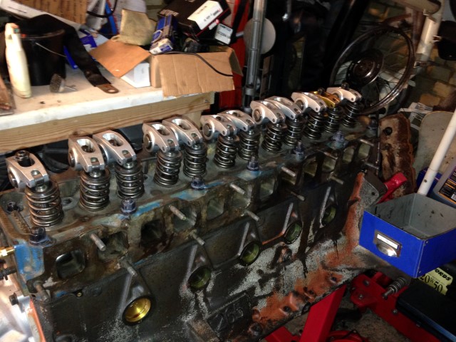

rockers
well gemeotry appears to be ok
kinda hard to see if it is going off the edge of the stem at no lift
but based on the centre of the roller tip pin being just left of the centre of the retainer think its ok
fine at the other extreme
i think i'm alright
need to paint top of value with wet marker and see whats what
any views

If the geometry is good the roller should move either side of dead centre only a fraction (like 1mm each side of centre) and go no where near the edges.
You might need to put shims under the rocker shaft if you have too much one way.

Of course. Opened my eyes now and can see. Not easy on a Monday morning for me. :D
So it should be easier with studs to go up or down with the rocker height?
Don't worry about pushrod length just yet. As long as the rocker adjusters end up a few threads showing on the underside of the rocker.
Try the rockers at 50% lift. Should be dead center on the valve.

adjusters are no problem, there are none in the rear of the rocker. nice simple pressed in seat in back of rocker. its the lock on the rocker stud that provides adjustment, it lets the trunion/mini shaft ride higher or lower i.e...they float up to the lock balanced on the valve and pushrod end. perfectly stable under tension. not stable at all when not
set the lock too high and it clacks and you risk the pushrod popping out hence need for longer pushrods if all is not well .
my valve stems are thinner than mopar standard 3/8 inch hence concerns, just ran out of time, thought a photo with flash would aid in the dark...didn't help much :) needed to show some progress :thumbright:
put the old pressed steel none adjustable ones back on the car. what a racket i'd forgotton how badly it clacked. reground cam and no adjustment doesn't work well.
want to get tins/sump on and painted this week.

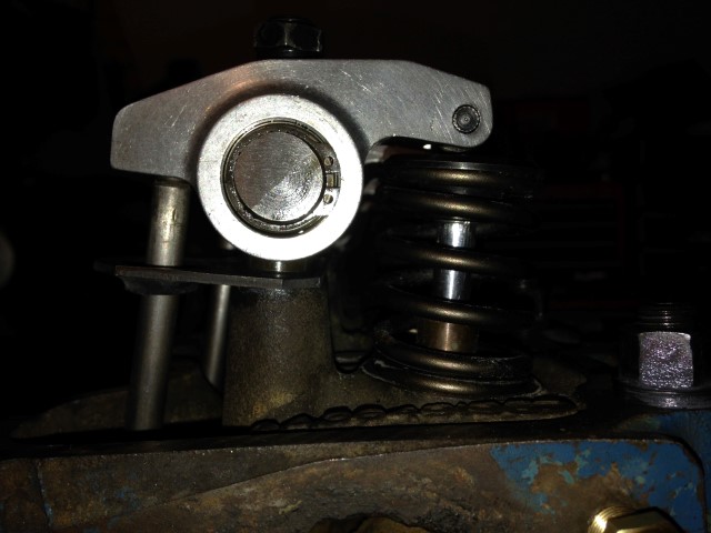

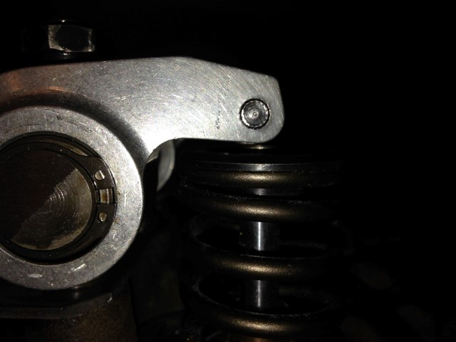

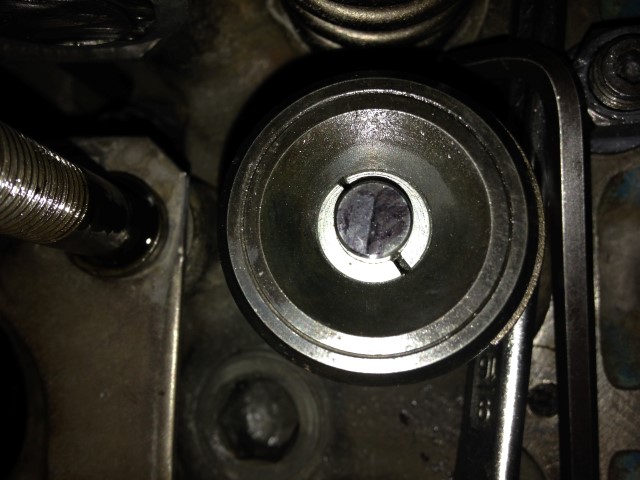

arrggh
pattern a smidge too wide and off centre
roller tipped rockers. no scrape minimal side load
thinner than stock valves
cam grinders reccomened springs
cam grinders reccomened lifters
cam grinders reccomened rockers chevy rockers rebuilt with hemi 6 specicifc conversion parts.
cam grinders reccomended reatiners dished by 10 thou for extra spring
cam grinders collets
lift is 0.605
inlet valve length tollerance 4.964-5.000
exhaust 4.995-5.010
all valves 5.010
so issue valves to long or seats too deep in head
yes the flat face of the spring sticks out.....
the wipe of the roller is off centre to get it more centred the rocker needs to sit higher
if the rocker sits higher it rolls more centrally
to sit it higher i probably need longer pushrods
to do that job properly i need 2 checking rods becasue of the hemi head config
because if i raise the rockers more than 1mm due to the semi hemi head the exhaust rocker on 1 cylinder hits the inlet rocker from the next at the trunnion and as they are floating rockers this presses the pushrod into the guide plate and alters it so the roller is not covering to total width of the valve side to side
options
buy some of these and longer pushrods
http://www.ebay.co.uk/itm/330898169570? ... 054wt_1037
but PRW have a reputation for some of the wrong reasons. but do a very narrow ball mount roller allowing more up n down adjustmnet on canted valve head with stud mounts so close
even then if i have to raise the rocker too high i will run out of thread on the mounting studd and my rocker tin won't fit
I might just leave it. this still has to be a million times better than the ball mounted pressed steel scrapers in there before
but i don't want to compromise having been at least careful, sensible or cautious with everything else.
Think based on not very good methods that i need pushrods between 35 and 50 thou longer to compromise with a slightly better pattern but still not ideal.....
would'nt mind paying if i needed 1/2 and inch extra

Yeah I thought the ends of the valve stems were going to look like that. :(
Hot Rod engine combos always throw up little issues like this. You have to expect them and clearly you know what the issue is and how to rectify it. :thumbright:

yeah but time and money probably doesn't add up to that much benefit
i loose a little lift and i worry about the fact that i didn't change it when i had the chance
vs no expenditure, probably a good life out the valves and guides and i get the bloody thing fisnished without another 2 week Postage and packageing delay.....
will consider options

Posts: 12076
Post by latil »
Is it possible to shorten the valve stems by the required amount?
