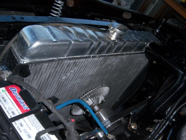

Thinking of using that 40 year old fan?
This happened to me years ago. I switched to a leccy unit

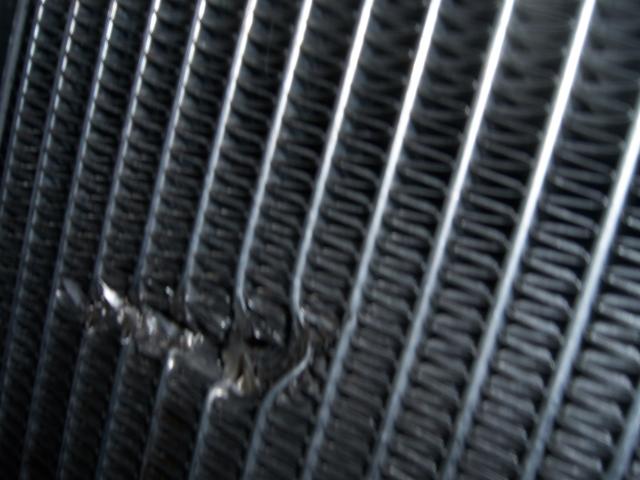

I found this on a yank site .
They can grenade and cause some serious damage, this guy was pretty lucky
