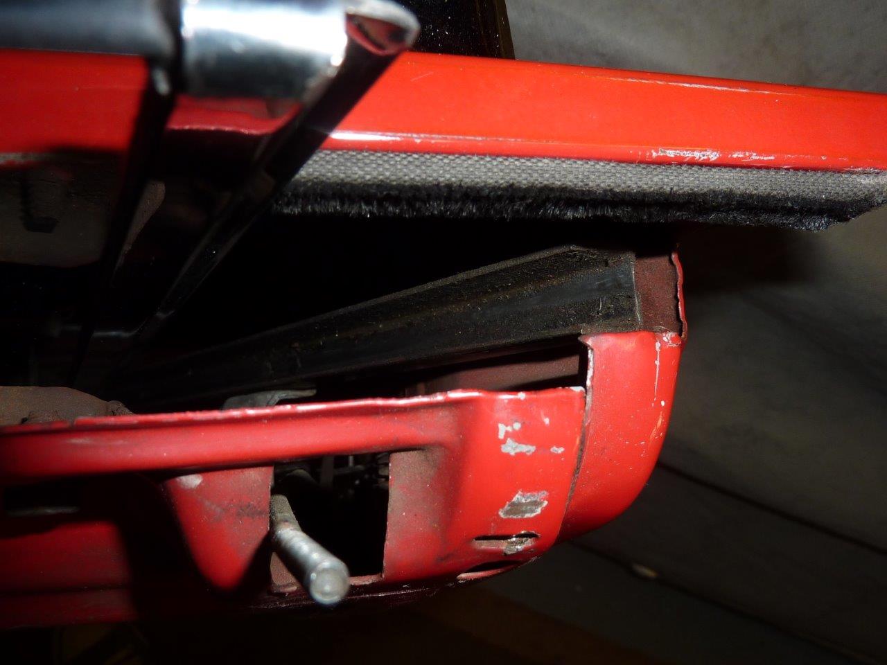

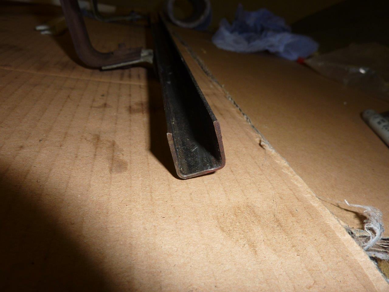

While I've got the door cards off to change the catch, thought I'd look into why the windows rattle so much.
I've fitted new fuzzies both sides of the glass and also the 'windlace' weatherstrip that goes all around the door opening. But I've noticed that at the trailing edge of the door, there's a lot of play between the glass support and the channel it runs up & down in.
Should there be something inside the channel? I think it might be called 'Run Channel weatherstrip' but as far as I can see it would guide the steel glass support, and not the glass itself.
if there's anything missing I'd like to fit it before I put the panel back on.
TIA.

Not factory but could you not run some felt down the groove, should help cushion any vibration?
Of course that will depend on how tight the glass sits within the groove!
Dunno how you'd get anything in there - I presume that channel is fixed in position inside the door?
If there was something that pushed or clipped in, it might be easy enough but trying to get a piece of felt or something 'floppy' :shock: in there and fixed into position could be a pain... :-k

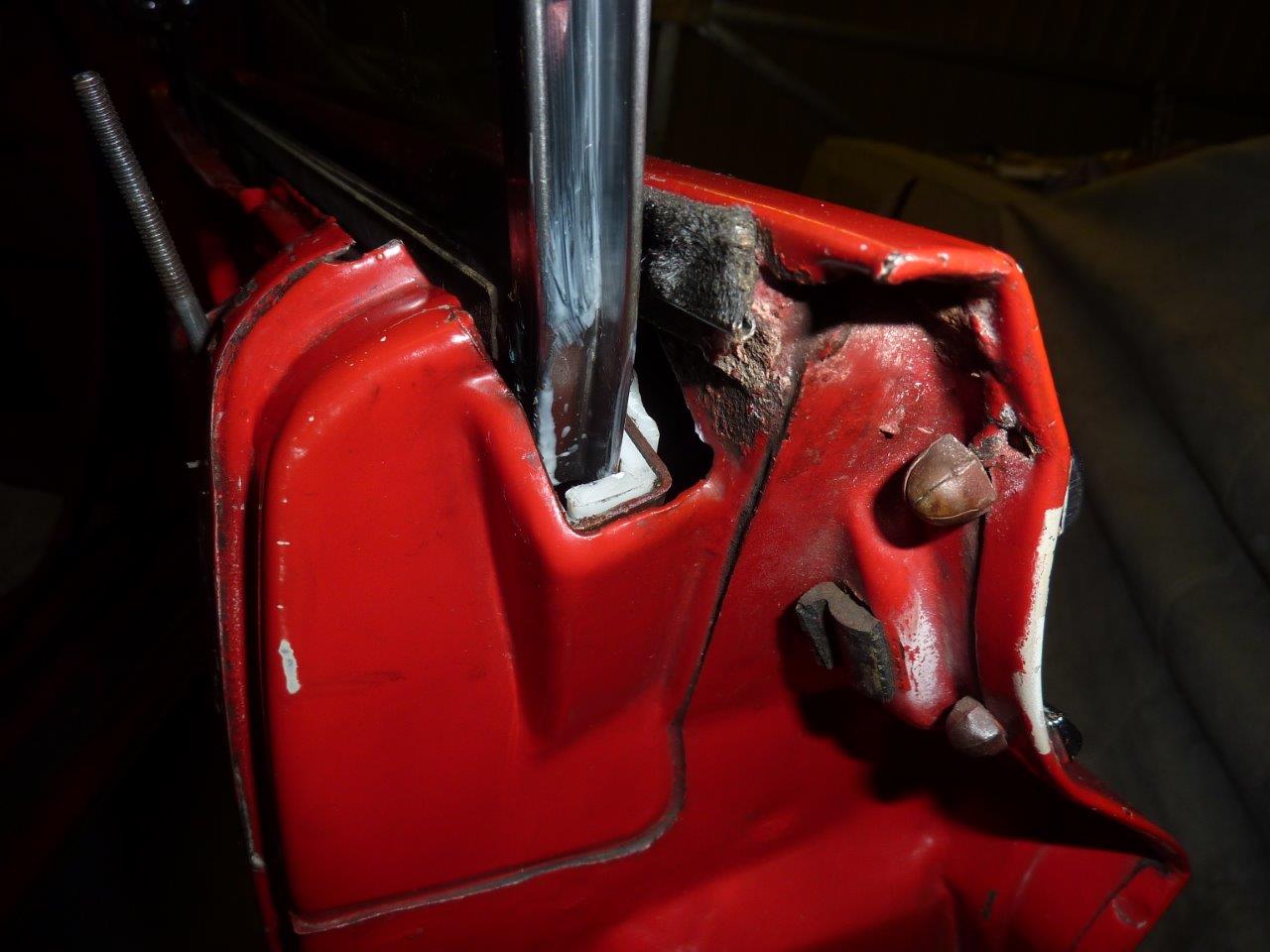

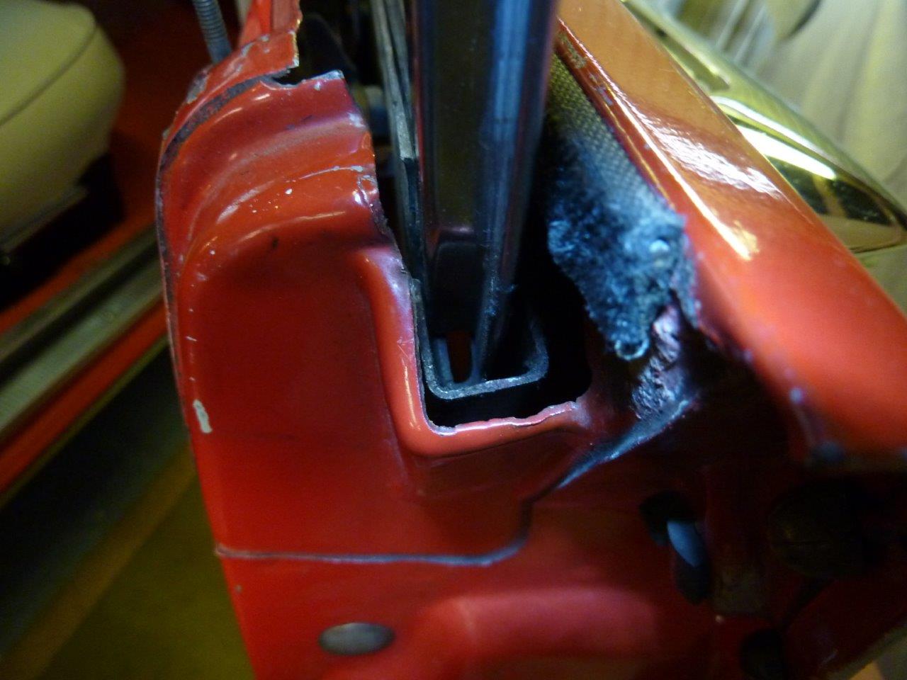

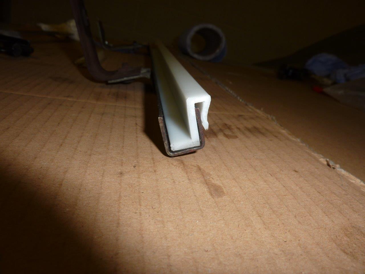

Thanks chaps, I did manage to 'find' some low friction nylon (UHMWPE?) channel we use at work. Seems to fit ok with a couple of c'sk M3 screws, but the window is a tad tight to wind up/down. Even with some white lithium spray.
I might see if it'll loosen up / wear in.
see pics.
I the felt would likely work better but I'd need to check the widths as it's not the glass that is guided, it's the metal glass support.
