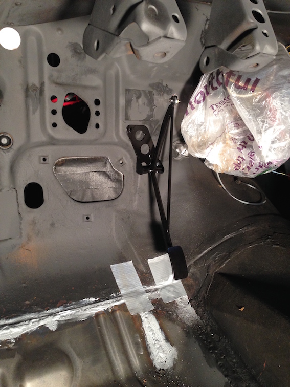

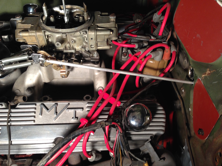

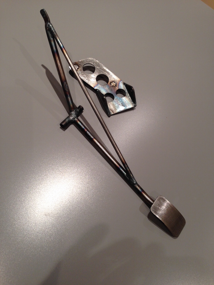

Knocked up a new throttle pedal from some lightweight tube, as the motor is solid mounted, a rose jointed rod will replace the cable. There will be an adjustable pedal stop on the floor to prevent overstessing anything.

In case you thought I'd been slacking, throttle pedal and linkage all done. Just need to figure out the best way to do the pedal stop and it's done. Been working on the brake and clutch linkages too, rose joints are flavour of the week....

Might pay to be a bit more direct with the throttle linkage :lol: Loving your work :thumbright:

Very interesting Blue, I have never even considered a solid connection to the carb (no cable).....what is the benefit of this and excuse my ignorance but how exactly do you fine adjust it??? If its direct to the carb, Im thinking that as long as everything is cut and fitted as accurately as you have, then it wont need any adjustment, just a new rod if you ever change the carb...:read2:
Sorry if Ive missed it but with that set up, I assume you use solid engine mounts with no engine 'flex'. My ploptop computer is taking ages to load the pages (it is second hand and 15 years or so old :oops: :oops:) so cant back track your thread to check for myself...
Great work as always...
Cheers Steve :thumbright:
Yes Steve, solid mounted. it's the neatest, most direct, bombproof and lightest both in weight and action. You screw the rod ends in or out to fine tune the length and that's it set for good. Actually Mopars are in the minority when it comes to throttle cables, most other US cars of the era use a multi piece rod system.

Why not thread the outside of the tube on the engine side of the throttle rod and then use a nut to stop against the fire wall as your pedal stop. Light and simple.

Pedal stop needs to be under the pedal pad Anton, otherwise you are putting strain on the rest of the linkage. Stopping it right at the bottom of the pedal means the only resistance the linkage sees is the return springs on the carb, so I dosn't matter how hard you stand on it, it can't move any further.
