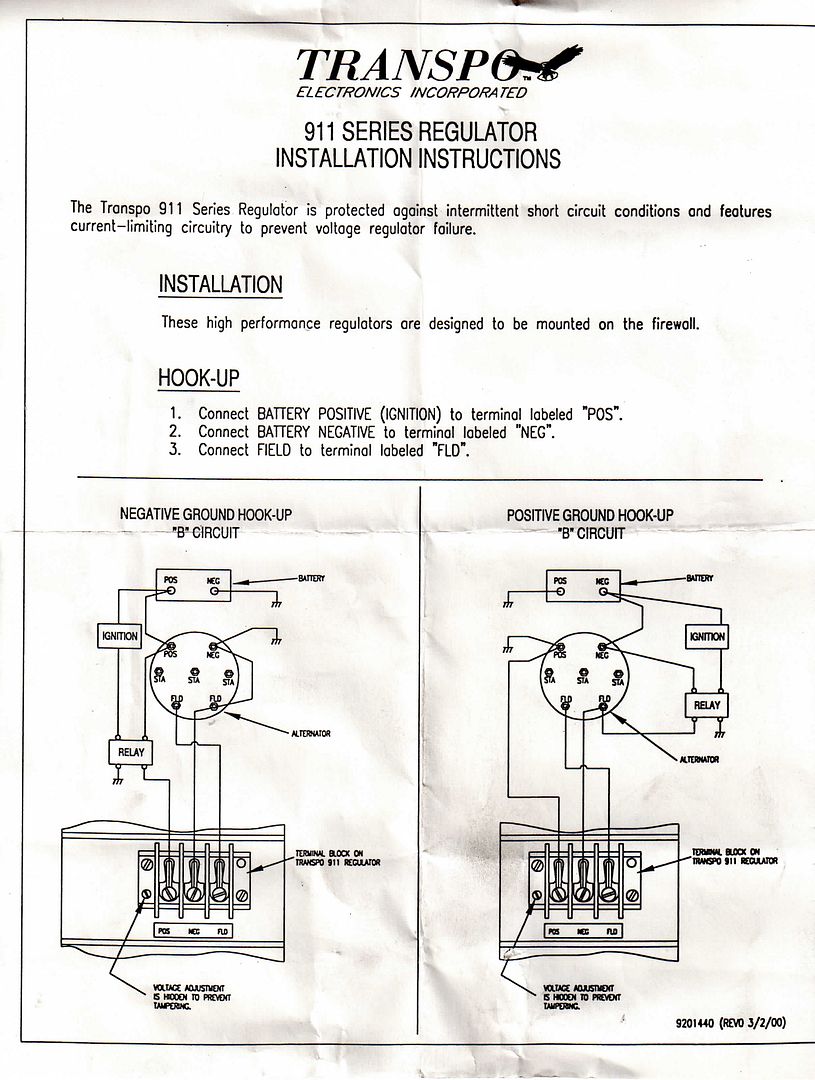

i think a bosch 55 will work as per diagarm 2 with your alternator
looks like it has 2 field terminals
if you wanted to use it with a mechanical regulator i think you'd need to loop one of them to earth, diagram 1 doesn't show this becasue its done inside the alternator or the alternator has an unused field connector on the outside of the case that has no insulating washer under it....so its earthed there.

Will sorry about pic I can't resize it but live feed from fuse box to 1 connector and batt charger light to the other then main charge cable to starter or battery, Earth will be through body to bracket. Shaun

you need a 2 pin regulator

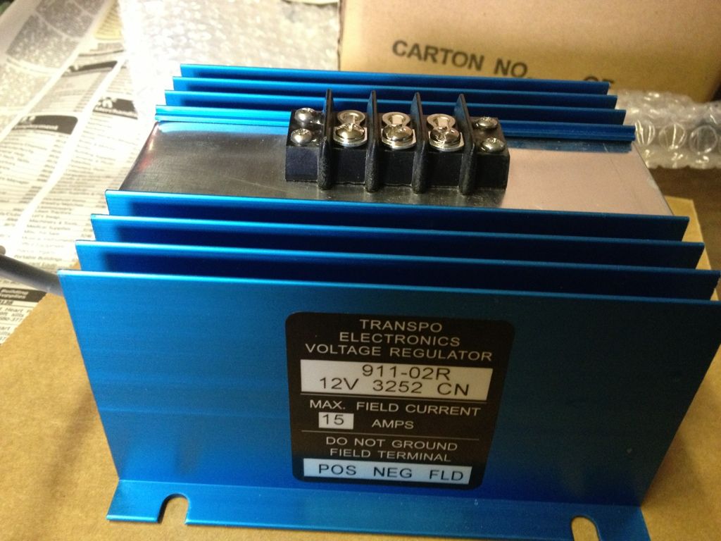

Gone for a Transpo 911
seems to be what all the big stereo boys go for.
Its a very high quality external regulator which is used in alot of light aircraft
if this works it could be a great alternative to the orange box or mechanical Mopar unit that i always here bad things about.
