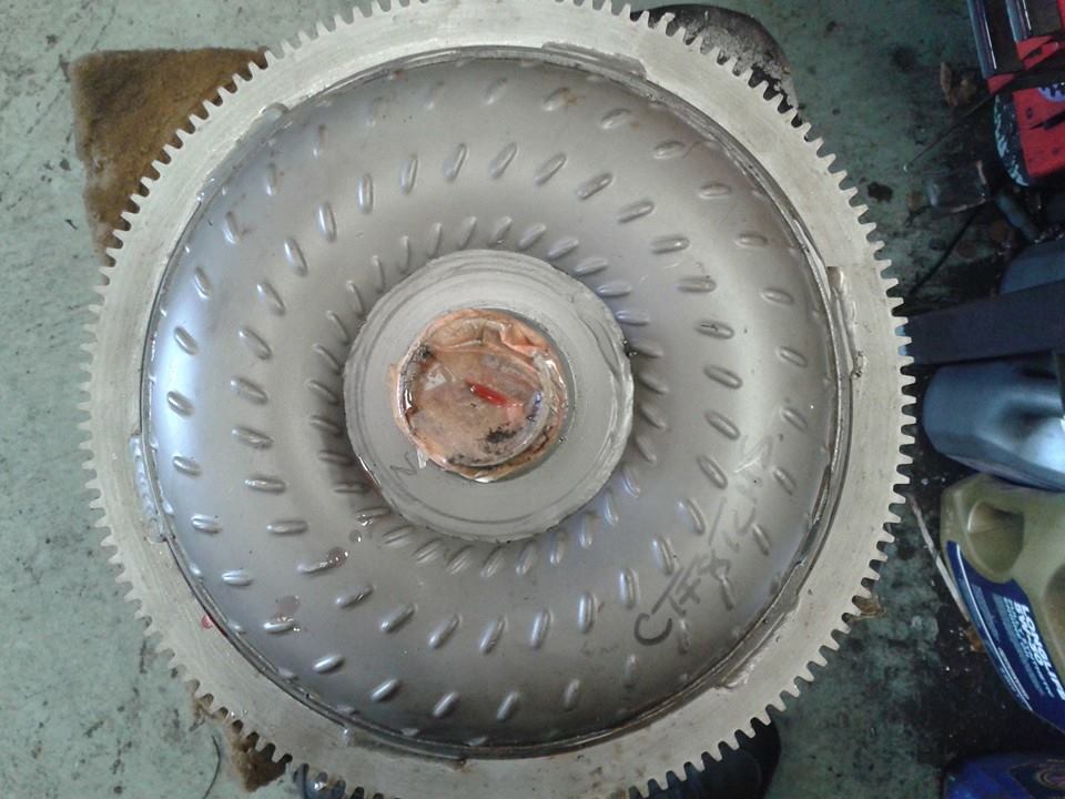

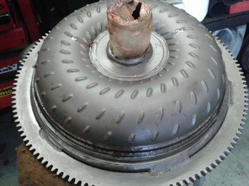

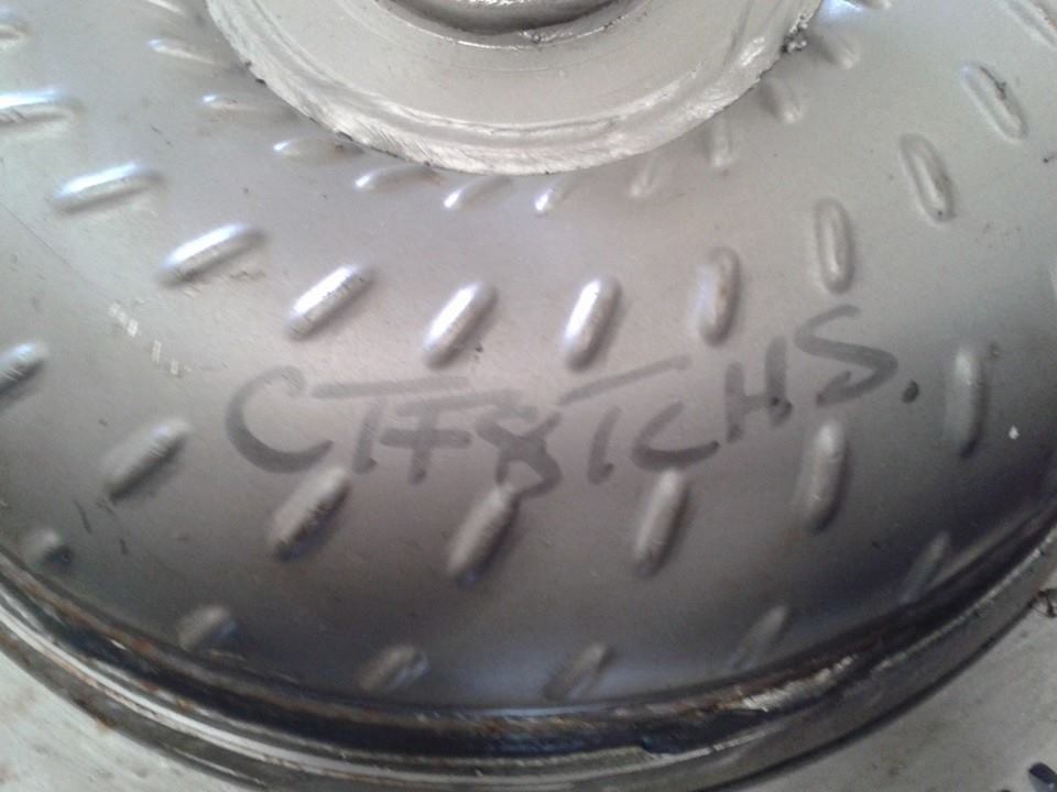

Post by challenger »
can anyone help i,d this converter,i took this out of a car 2 yrs ago believed to be either 3000 or 3500rpm stall got some numbers on it i cant match up, first lot are written in black pen CTF8TCHS then stamped on the ring gear 5h11 and chrg130

Stab in the dark here, CFT8TCHS could be Chrysler Torqueflite 8 (727) Torque Convertor High Stall, chrg 130 = tooth count, don't know on the 5h11, could be 11 inch? I'd say it was 3-3500 stall judging by the size.

thanks rob, i guess stall speed also depends on power output of motor too, cant work out whether its a tci unit,looks identical with there pics

the black marker is just from it having been rebuilt at some time at a verter shop,,,,

that makes sense dunc, certainly looks like its been apart at some point

challenger wrote:that makes sense dunc, certainly looks like its been apart at some point
It could be possible.
I bought two Convertors at the same time.
One threw a Convertor bolt (despite torquing and loctiting) on the 3rd pass.
It actually got loose and it damaged a thread so I sent it to Sussex Autos for a repair. I hoped it just required a helicoil but I guess because it was a blind hole they took it apart.
It must clearly be that one.............
