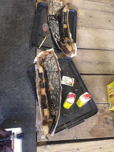

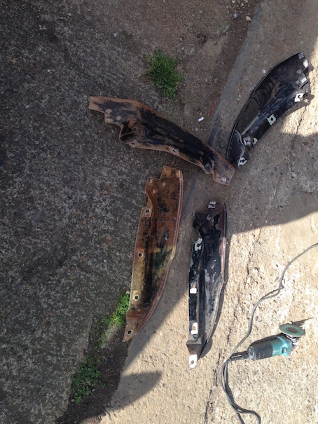

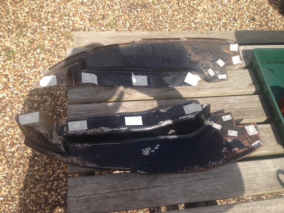

Up to my arse in fibreglass this week! I've never tried to make fibreglass parts before, so I thought it was high time I had a go. I made some inner fender splash shields, and because they are not dimensionally critical I used the inside of the original part as a mould. I gave 'em a quick wire brushing, taped over the holes and applied some mould release wax.
I wasn't sure how many layers of mat to use for "race weight" so I guessed at 2, it worked out about right. I drilled all the mounting holes before taking them out of the "mould". They were a bit of a bugger to get out, I'll use some sort of mould release agent as well next time. All in all not a difficult job and I'm happy with my first attempt.

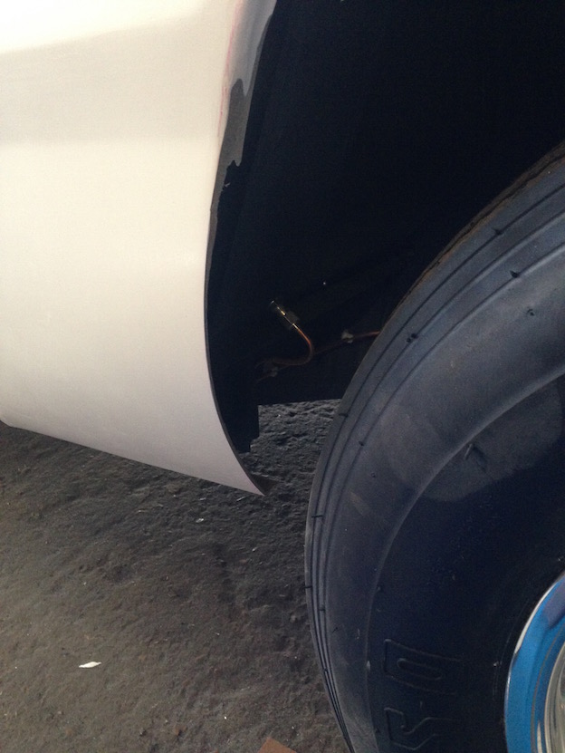

Tyre clearance was a bit tight at the rear of the front arches, no doubt because I've dialled in a fair bit of caster.

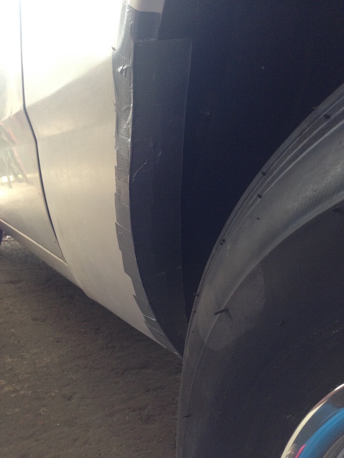

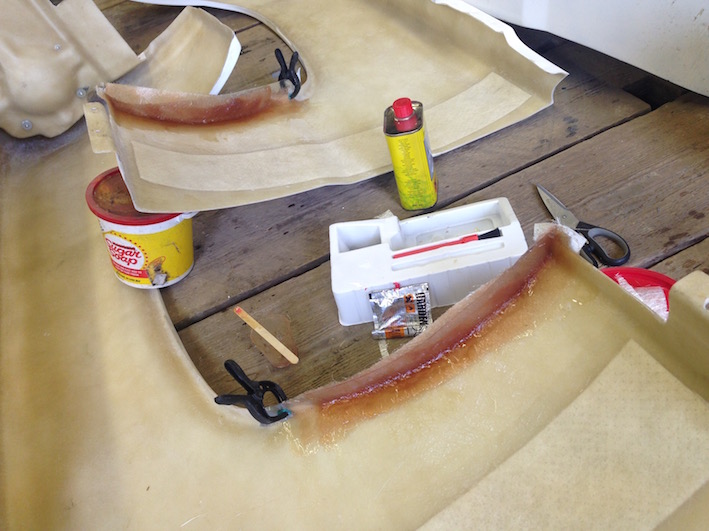

I marked out the new shape and took a slice out. Shaped a thin piece of ally sheet and taped it on tight till it looked right. I ran a bit of P40 around the inside edge join with my finger to stiffen it a bit and also to seal it so the resin doesn't run through when I mat it up from the back to form my new lip.

New arch lip all laid up. All ready to do a final trim to fit and the wings can go back on for the last time.
