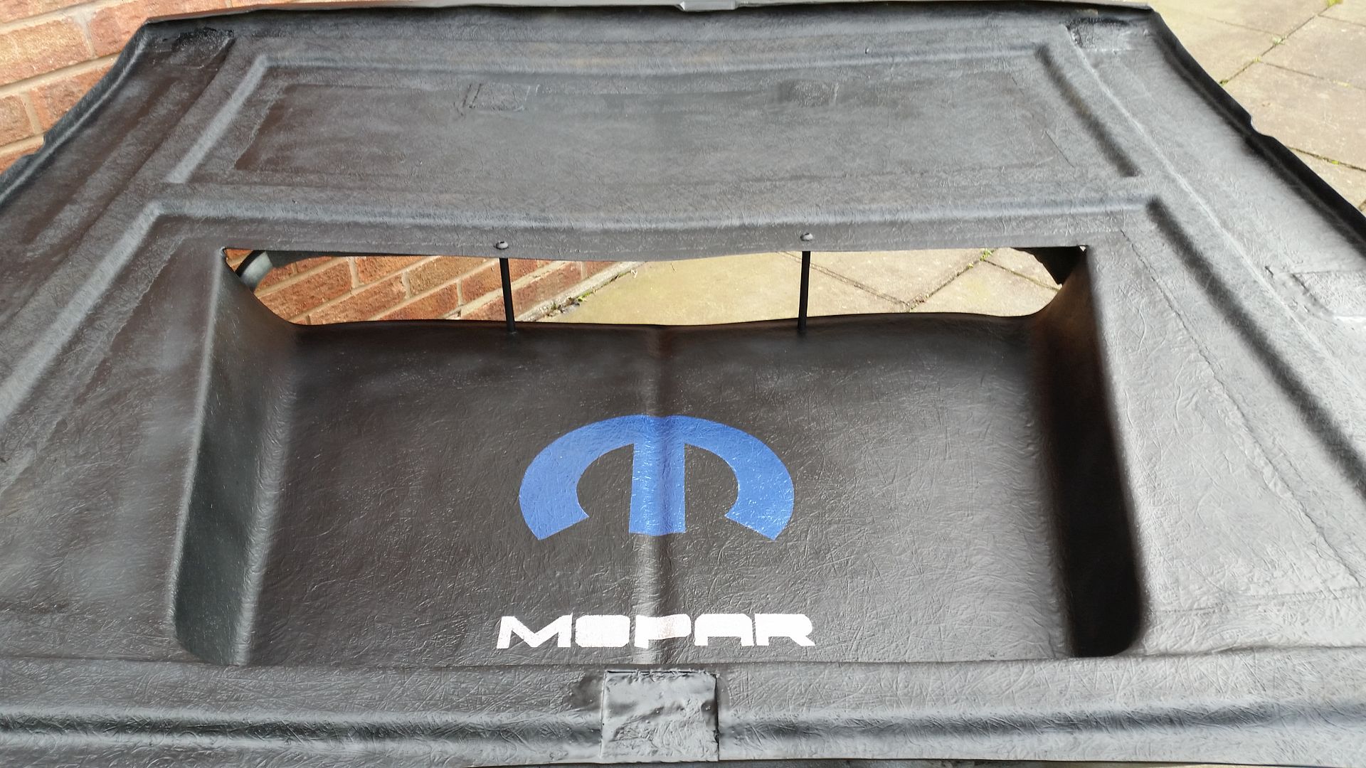

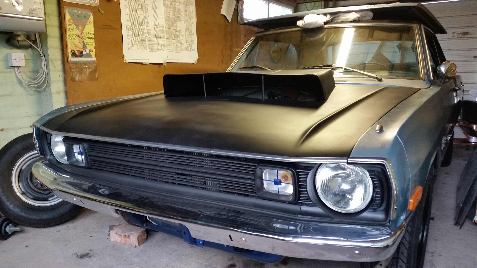

So trial fit time.......
More personal touches:
Placed on:
Inside View:
Front:

Cool scoop Dave :thumbright:
RobTwin wrote:Cool scoop Dave :thumbright:
:withstupid:
HORAAAAAY !!!!!!!!!! =P~ =P~ =P~ =P~ =P~
Looking good fella, that's a fair bit of weight off the nose.....

Scoop looks awesome!! Is there anyone who is able to do fiberglass parts?

Dave, looks like we are all going steels + dog dishes, although, I still love slots. That scoop looks great too. Chris
