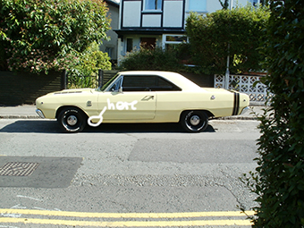

No help but that side profile of your Dart is fantastic. What a great looking car....perfect shape =P~ =P~
