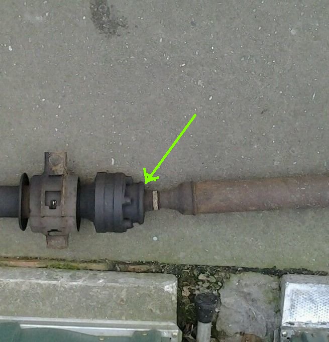

A guy has asked the following on Facebook. Any ideas??
Quick question for any Mopar people on here,I need a propshaft boot for my '63 Chrysler 300.. anyone in the UK likely to stock them,is it a case of order from the States or has anyone used a steering rack CV boot or similar that does the job?

yes ive seen that propshaft , before , it has a rubber gator covering the front UJ , instead of the normal slip yoke , , think a trip to a local motor factors would do , have a measure up , may be a universal cut to fit one .
there is a similar type of boot from memory on a capri 28 injection prop , on the front , of the rear section where it connects to the constant velocity joint , not saying this will fit , but , its similar sort of set up , cant take a picture , long since sold all my two eight I capris
edit found a picture on ebay of said capri prop , incase anyone was wondering what I was waffling on about :lol: :shock:

I would suggest calling up a prop specialist with some dimensions would be the best bet. They are likely to have stuff like that sitting on the shelves.
Try GKN drivelines? I've used them in the past and found them helpful and efficient.

It's a CV type joint so a universal gaitor kit might go on there.

try propshaft services in Feltham

http://www.ebay.co.uk/itm/Mopar-Drive-S ... 1707762456?
orginal styleeeeeee
I think
but it is in the states
latil
Posts: 12076
Post by latil »
That is the small one,there's two sizes. Double check first.
