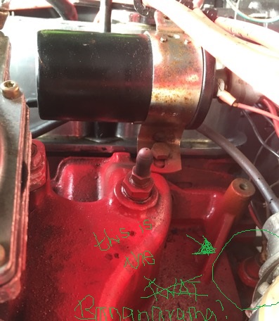

So after getting a shiny set of three mechanical gauges, getting a pair (big 'n' small ) replacement oil senders and a T-fitting, ordering copper capillary pipe to replace the brittle plastic tube, deciding where the binnacle will sit, I got my tools and headed off today to install said set of gauges.
Thankfully, I started at the sharp end and didn't start feeding stuff through the firewall ...
(just so you know, sender sits at the back of the engine in my Challenger, against the firewall)
God only knows how the sender was put in, but I'm guessing it was while the engine was out, which would explain the spray over from the red paint the block is coated in - after removing air filter to gain access, its made no bloody diff' !
Do I need to remove the dizzy ? the ONLY aspect I have on it is from above, and I'm guessing (again) that the hex nut I need purchase on is below the "bell" - there seems to be a "stepped" ring around it but I'm not sure that it would mate with a socket.
To be fair, considering calling the whole thing off or taking it to someone who can ......
Currently, the idiot light doesn't function and although the levels are good and she doesn't overheat, I don't want to tempt fate.
Am I stupid to think there MUST be another port available to plumb into - if so, I'll just disconnect the old sender and leave as is ?
Any help appreciated, if you're close by and fancy a crack @ it, I'll buy the beer/wine/cider ......
Garp

Post by Dart Vader »
dizzy out will help, mark the position and ensure it goes back in same place
wide socket will go over oil sender
maybe a smidgen of carefully applied heat would help, careful of wires etc
it a fine thread so shouldn't be too hard
more a case of getting enough purchase on it

Pete wrote:That's an Oil Pressure Switch not Oil Temp.

I have the correct socket to fit the pressure sender if you need to borrow it. Might be easier with the dizzy out, simple enough job.
Posts: 9563
I do believe a great big set of moles grips also works :)
however they are designed to make a mess and are a close cousin of Mr Stilsons
dave
Not much room round the back of a small block for WMD's Dave...
Posts: 9563
jings
they designed all the fun out!!!!
and left no space to drill out the stub when you snap off the sender....
latil
Posts: 12076
Post by latil »
Not even room to knock it off with a club hammer and eezeeout the broken stub. :( :help:
