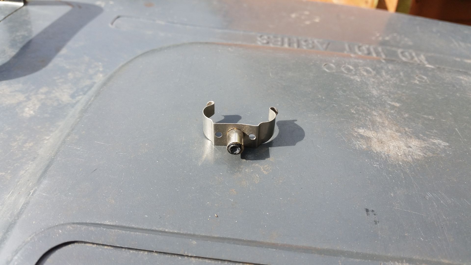

Whilst sorting the indicator issue today, I dropped the column slightly to assist in pulling the wires through. Part way through I noticed this on the floor.......now I'm sure I recognise this from the brake peddle contact, but I've got no photos in my archive to show it's position/mount.
The part:
Any ideas or photos chaps...........I'm at a loss on this one, but sure it's the reason for the lack of red lights.

The part in the pics..........I know I've seen it connected to something but I just can't remember where. The outer black face was the contact.
I'll keep it safe as it must do something.
