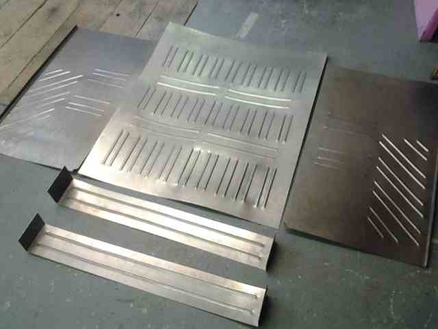

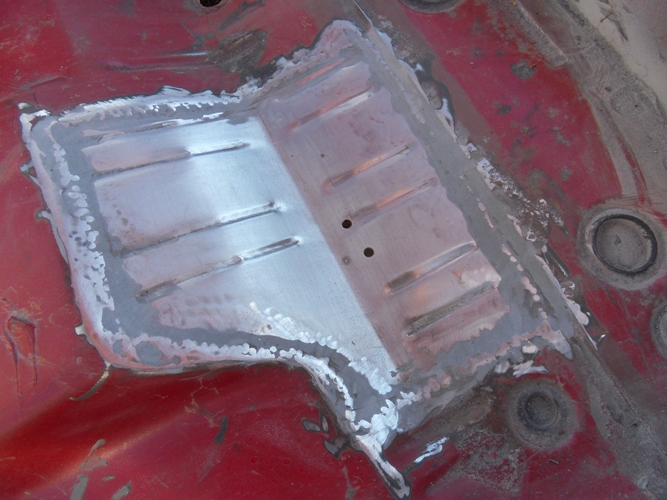

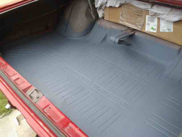

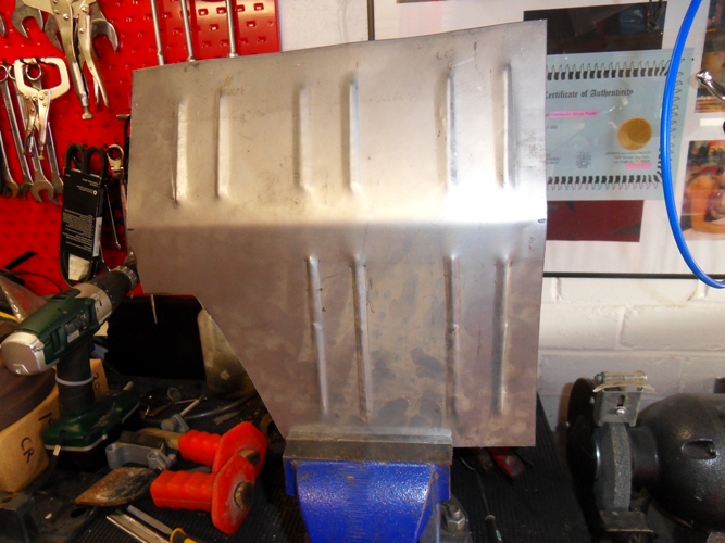

Have a go at making them...16g steel sheet, angle grinder with 1mm cutting disc and a bolster chisel...its fun and doesn't take long to do! :thumbright:
forum 52.jpg (146.05 KiB) Viewed 854 times
forum 51.jpg (202.78 KiB) Viewed 854 times
forum 49.jpg (195.82 KiB) Viewed 854 times
forum 47.jpg (203.47 KiB) Viewed 854 times
Posts: 1674
That looks a good job Steve :thumbright:
Posts: 7453
Thanks Dave. Its not the neatest job ever but it was great fun making the panels and welding them in. Thanks to Blue who very kindly gave me his old MIG welder, I learned the basics of welding and managed to do quite a bit on my old Fury. I did the whole trunk floor, drop offs, outer rear lower quarters and the panels in front of the rear wheel arches. Cost me some time, bit of welding gas and £30 worth of 16g sheet metal.....very satisfying :thumbright:
Posts: 7453
Thankfully had access to Autofetishs' bead roller for the trunk....it saved me a fortune in panels and was a great way to learn... :thumbright:
If I can do it, believe me, anyone can! :roll:
Posts: 1674
Definitely the way to go especially with the current exchange rate. Take a bit longer but lots of new skills to learn :thumbright:
