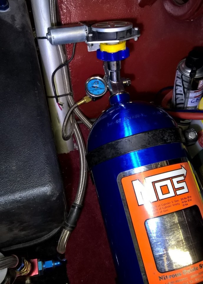

I've rigged up a remote NOS bottle opener on the Belve using a Fiesta window motor.
Mechanically it works fine, but I need it to switch off automatically after opening and closing.
The motor needs to run for approx 1 second in each direction then stop at exactly the same point each time it closes!
I've got a momentary on-off-on dual pole switch so I can reverse the polarity between open and close directions.

Does the valve have to turn by more than one revolution from closed to open?
If the answer is no then two limit switches could do it...
If yes then maybe open the valve for a set length of time (to make sure it is fully open) and sense the motor current to know when the valve is fully closed again (as the current will go up when the motor stalls)...
I just checked, it's almost 2 full turns to fully open, so I guess it's option B! The motor will hit resistance both ways so the current sensing idea should work for opening and closing?

What he says - or you could look for a (fiesta) window motor controller that would already have the current sensing circuit built in...

Electrically operated solenoid valve - on/off - open/closed
About £200 (!) from NOS system suppliers.
About £50-100 from an industrial automation supplier.
See here for DIY NOS systems - http://www.nitrous.info/nitrous-solenoid.htm
(Disclaimer - absolutely no idea if this guys info is legit).
Thanks, I did ask at my local hydraulic suppliers before my mate gave me the motor. They can do a stainless industrial solenoid that can handle over 1000psi but at over £100 it wasn't worth messing around. I've seen used proper nitrous kit ones go for around that.
