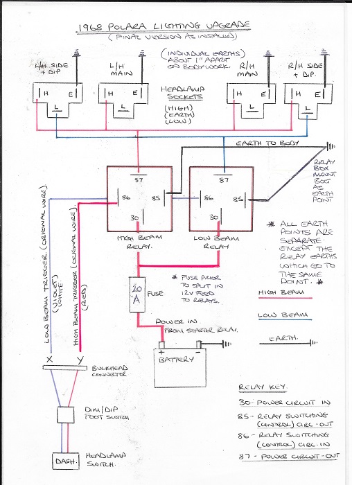

Posts: 7454
I take it your side light loom is completely separate from your dipped and main beam loom? I made my own loom and just used the original wires as trigger wires to the relays...
Cheers Steve :thumbright: :read2:
Polara relay loom resized 1.jpg (114.25 KiB) Viewed 596 times
