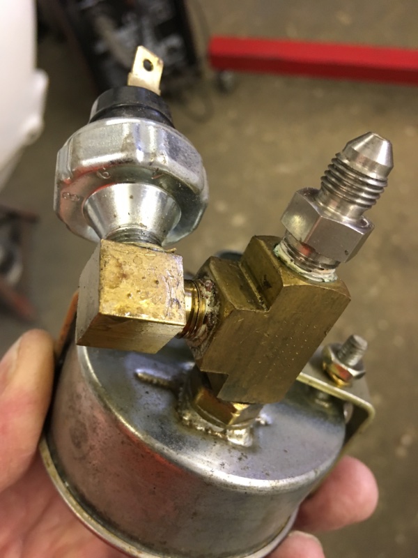

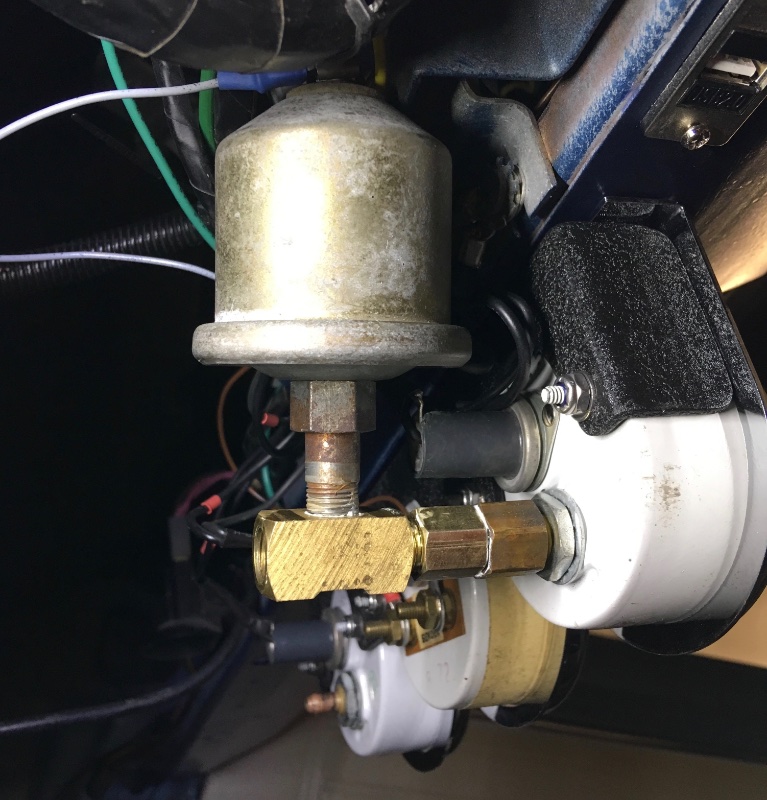

Here you go, Valiant has the small sender to operate a light, Barracuda needs the big canister to operate the gauge in the rallye dash. Both only seem to work correctly if they are upright which is odd as I would imagine they are spring loaded, so bit more difficult to do. The gauge in the dash isn't up to much which is why I wanted a proper gauge, I can't do with stuff not working though so had to go this route.
- IMG_0161.jpg (121.67 KiB) Viewed 1054 times
- IMG_0162.jpg (185.71 KiB) Viewed 1054 times

Have you used a straight 1/8" NPT tee to do that or are the ports different sizes?

That looks very heavy JohnBlue wrote: Sat May 26, 18 7:20 pm Here you go, Valiant has the small sender to operate a light, Barracuda needs the big canister to operate the gauge in the rallye dash. Both only seem to work correctly if they are upright which is odd as I would imagine they are spring loaded, so bit more difficult to do. The gauge in the dash isn't up to much which is why I wanted a proper gauge, I can't do with stuff not working though so had to go this route.

Don't worry extreme measures have been taken elsewhere to offset it...
