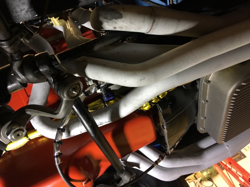

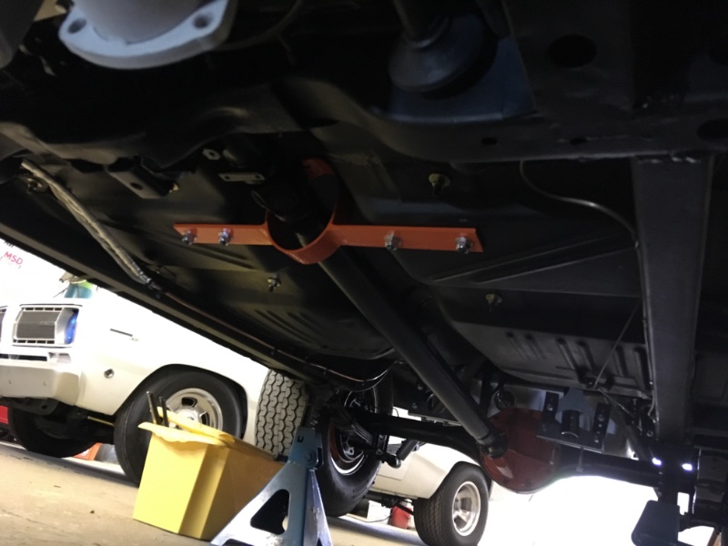

Progress has been slow of late but the end is in sight. The tti headers offer great ground clearance but jeezus does it get busy around the starter motor area. Had to make new cooler lines to clear, mod the kick down linkage and get creative with the shifter cable. Cable and cooler lines have heatproof sleeving fitted as they run so close to the headers. Mocked up the tti system, it fits very well but all needs trimming so takes a while to do, clamped the new rear pan in place to make sure the tips end up in the right place when that eventually gets changed. Will take the system in on Monday to get aluminium sprayed before final fit. Just a few odds and sods to do before I can fire it up and I should be back on the road...

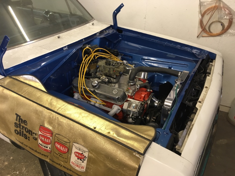

Reasonable progress, Indicators working, aftermarket temp gauge working, oil leak cause detected and parts obtained to fix it Tomorrow. Need to sort out why none of the stock instruments work anymore and get a firmer brake pedal then I can drive it and see what that throws up...
Re: Blue's Barracuda

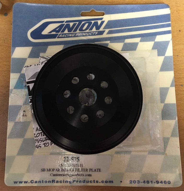

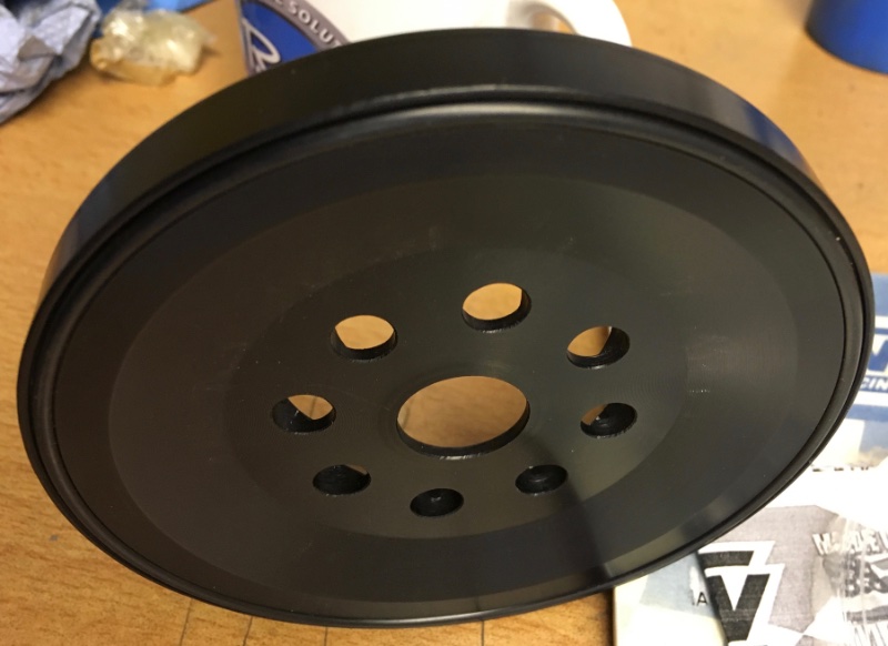

Oil leak fixed, stock pressed metal oil filter plate wouldn't seal to the block, it's a known small block issue. The folks at Canton racing products make a billet replacement which is 1/4" thick, O ringed and with larger ports for increased oil flow, part no. is 22-575. Luckily I had one in stock ready for my 408 build so I fitted that this morning, job done. When I looked for a replacement I noticed they are listing them as discontinued on eBay, others including Summit and Jegs have them. If you run a small block I'd seriously consider grabbing one now while you can.

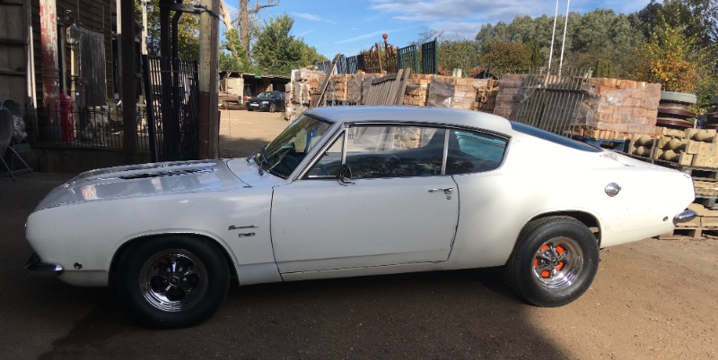

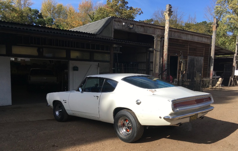

Pulled the old beater out into the daylight Today for the first time in a year, pretty happy with how it's turning out.
Nice, I do love the lines on that. :)
