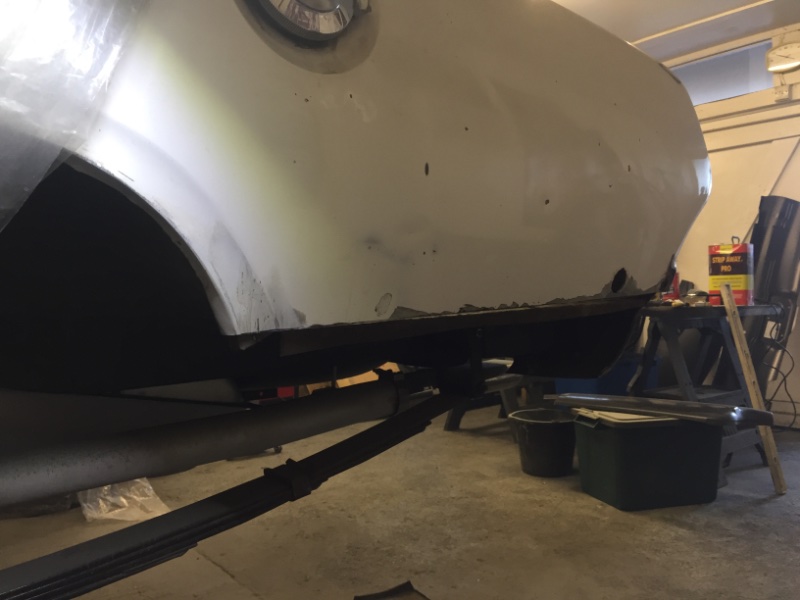

Right then this job is looming, replace rear panel, boot drop offs and lower rear quarters. All advise and tips welcome, I've not done this before.
Re: Blue's Barracuda
Good to see they have finally arrived!!
Dave Billadeau will probably be able to advise.
Alternatively, give Ash Rawson a call and talk it through with him, I am sure he will have done it before.
Posts: 6738
The good thing is that the lower 1/4 has a nice radius, which makes it much easier to lose the weld & blend the filler over the radius.
It’s harder to butt weld the panels, so might be easier to go for a slight overlap, another option is to joggle the edge of the new panel, but obviously have to take into account curve.
Panel clamps are great help, especially if butt welding, clecos can also assist depending on method chosen.
A lot easier to show n do, than write 😋
Thanks Mark, I have most of those tools. It's also been suggested I only replace the bare minimum of sheet metal cutting down the patch panel to suit and joggling it, I think that's the way forward.
Typical American "repair", brazing a panel over the rust and fill to suit, there is a lot of filler to remove ...
Are you tempted to cut it back to above the Marker Light?
Good progress, though. It takes nerve to pick up the Angle Grinder like that.
Nothing to be gained by going any higher Pete, I'm working on the basis that the lower down the panel the repair is the easier it will be to hide. It was quite badly warped by brazing but seems to have largely sprung back now that's been cut off.
