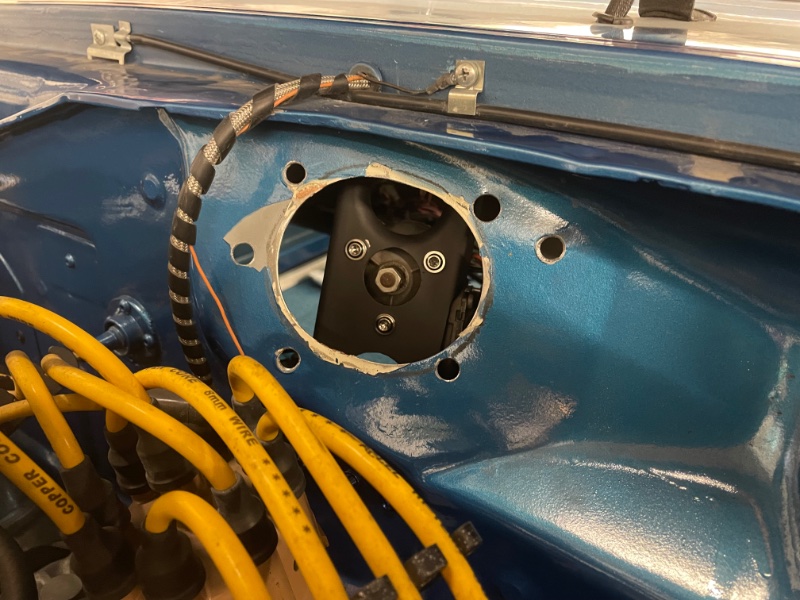

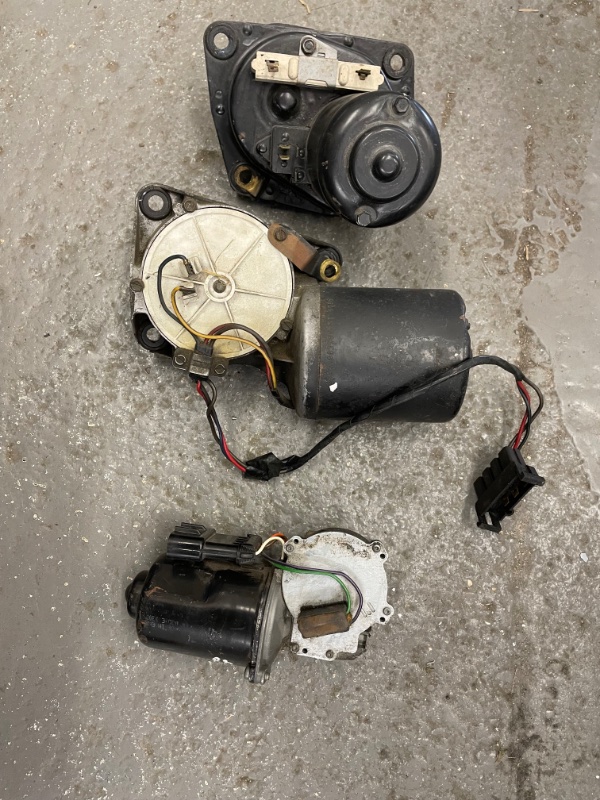

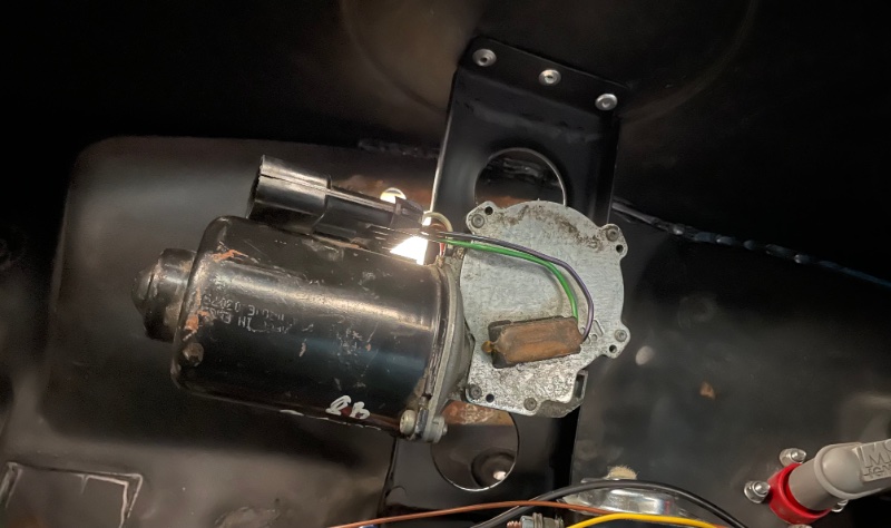

Whilst the dash is out it’s the best time to do a wiper motor mod. Mopar wiper motors are big old chunks and certainly in the wrong place on a small block A body. A Vauxhall Corsa unit is tiny in comparison, is pretty easily adapted and will fit under the dash. So I’m getting on with that at the moment.

Thanks Lee! Corsa wiper motor is in, I’ll wait until I’ve finished wiring it before bolting on the linkage.

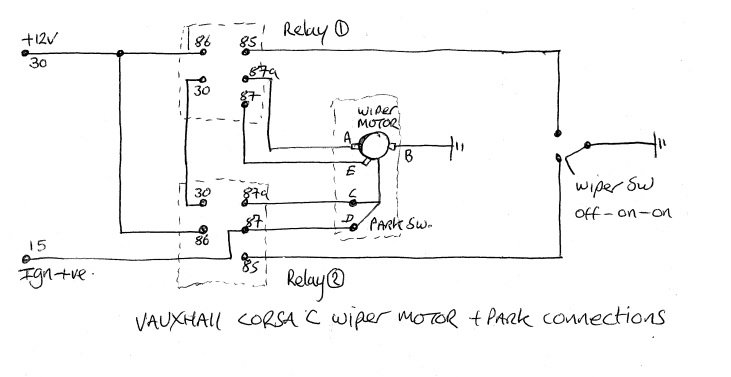

found this
never found the photos of the 2 relays wired up, of course that covered off the corsa wire colours missing from the diagram
i'll keep looking
the key to getting it to work is having the wiper motor grounded to the same thing as the switch case
and all of that onto the - at battery
and if the lever and linkage is on the motor keep your hands well clear... :) fingers don't really fit between lever and linkage or motor case

Yes I still have that Dave, next job is wiring it!

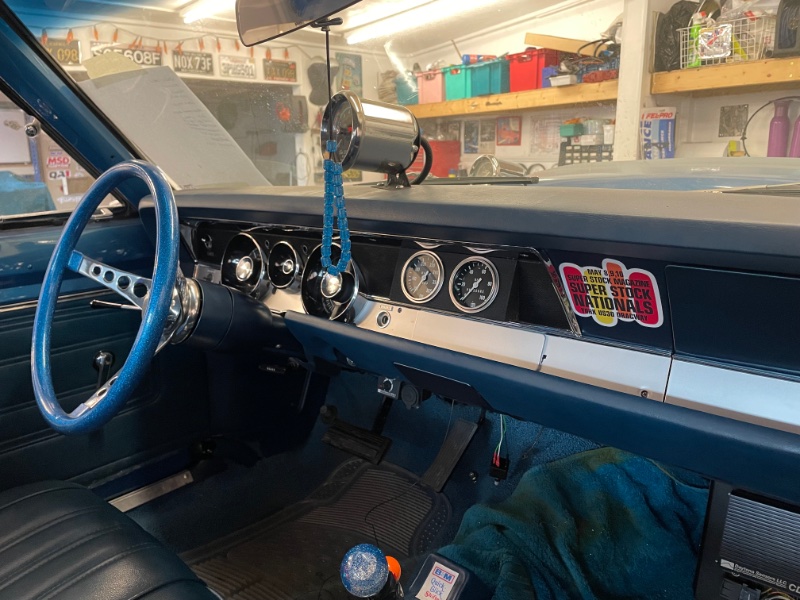

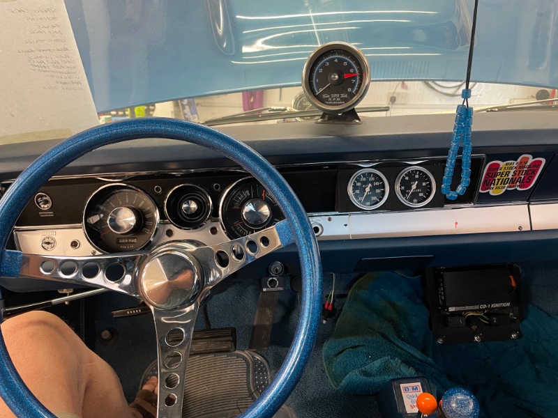

Dash back in, just a few more jobs to do but it’s mostly there. I think it was worth all the effort.
Posts: 7111
Re: Blue's Barracuda
That looks excellent. Very cool. 8-)

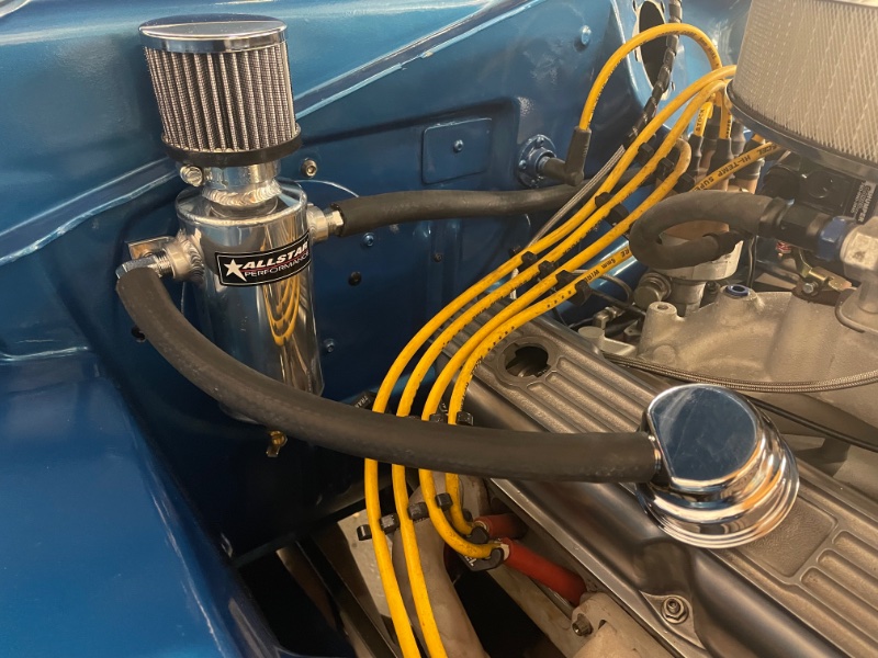

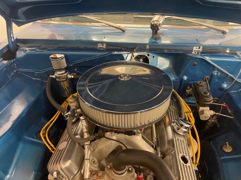

High time I fitted a decent breather system, so I did that Today. Waiting for clamps and new filler caps.
