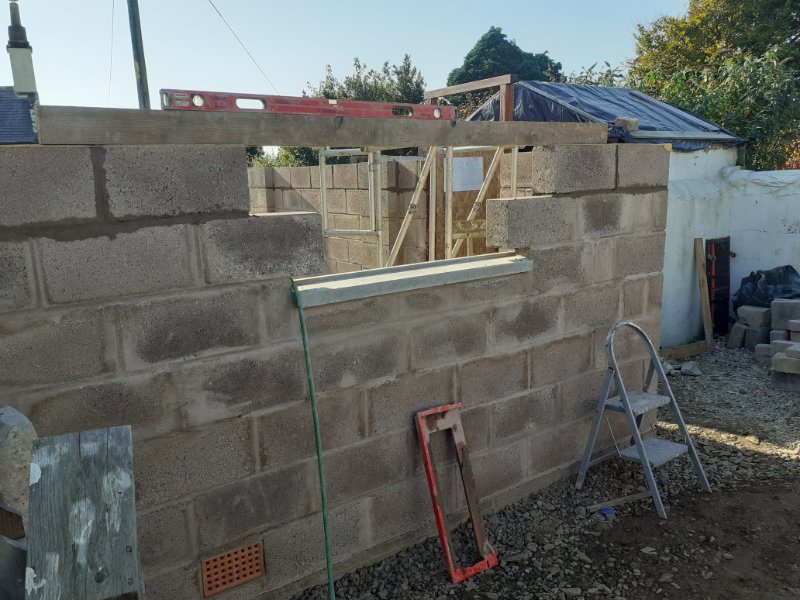

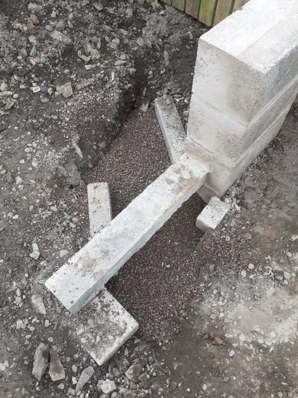

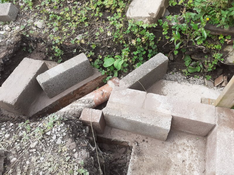

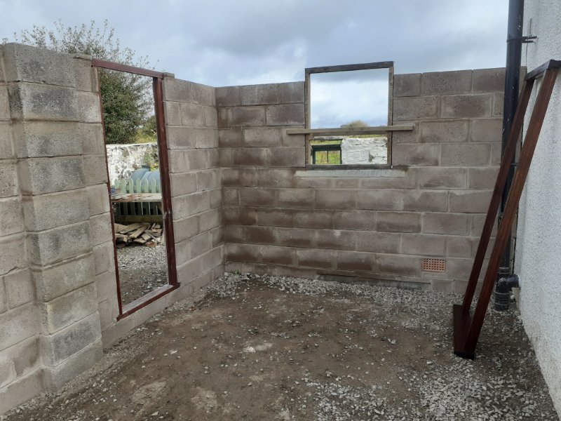

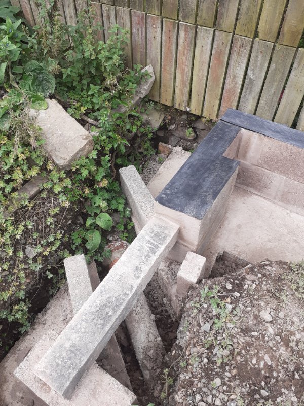

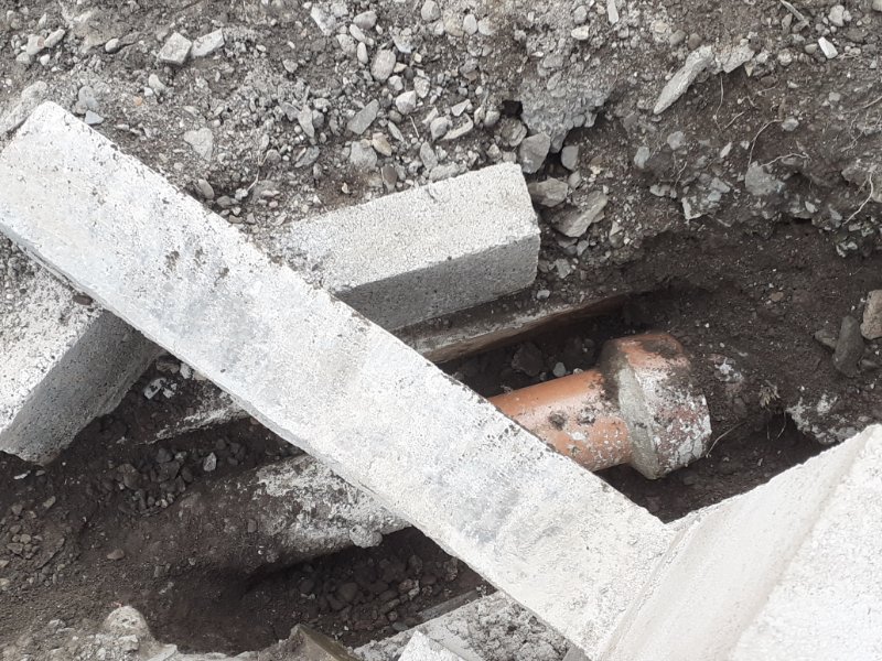

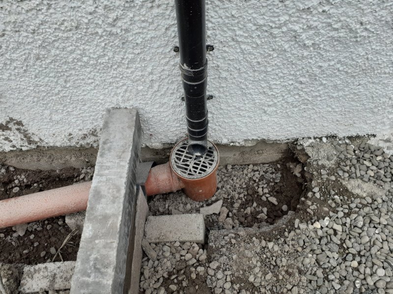

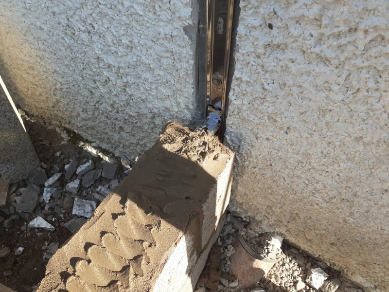

The lintels over the pipework went in ok. The one by the septic tank pipe was a bit overkill to be honest as the corner pillar by the door wasnt actually over the pipe. It was close though so I came down on the side of caution and put one in just to be safe. If that got broken it would be a nightmare to fix.

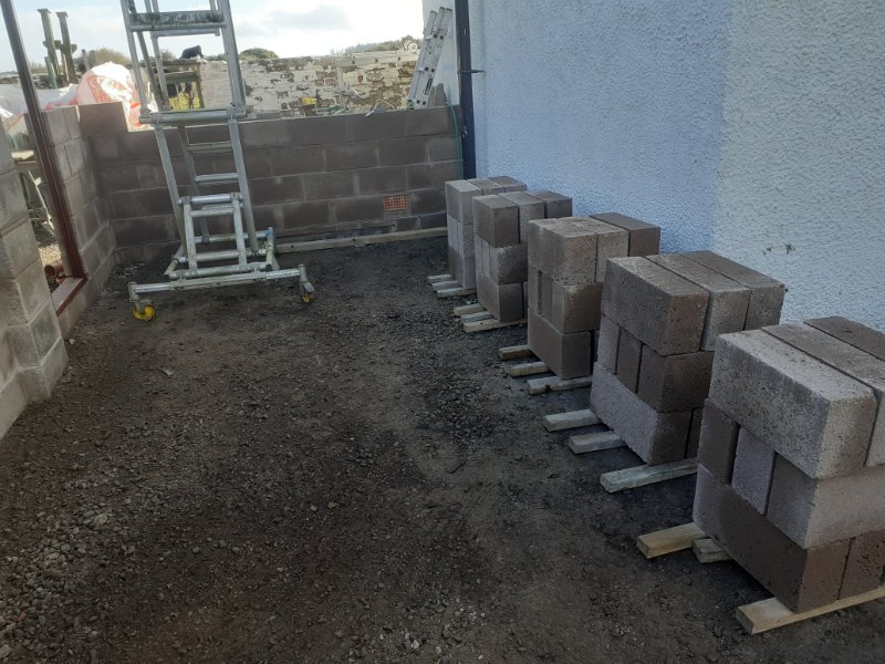

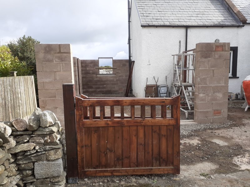

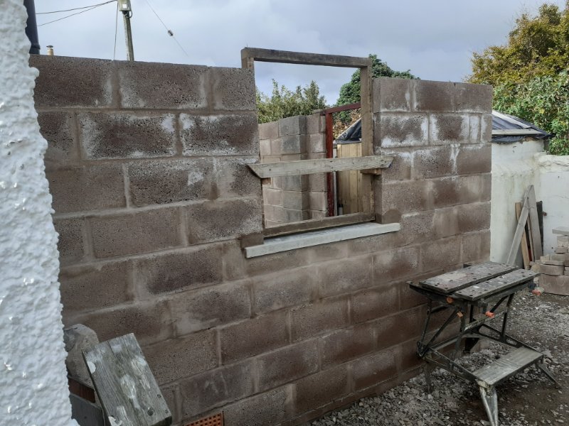

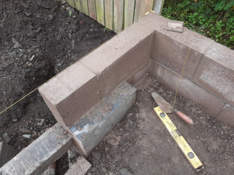

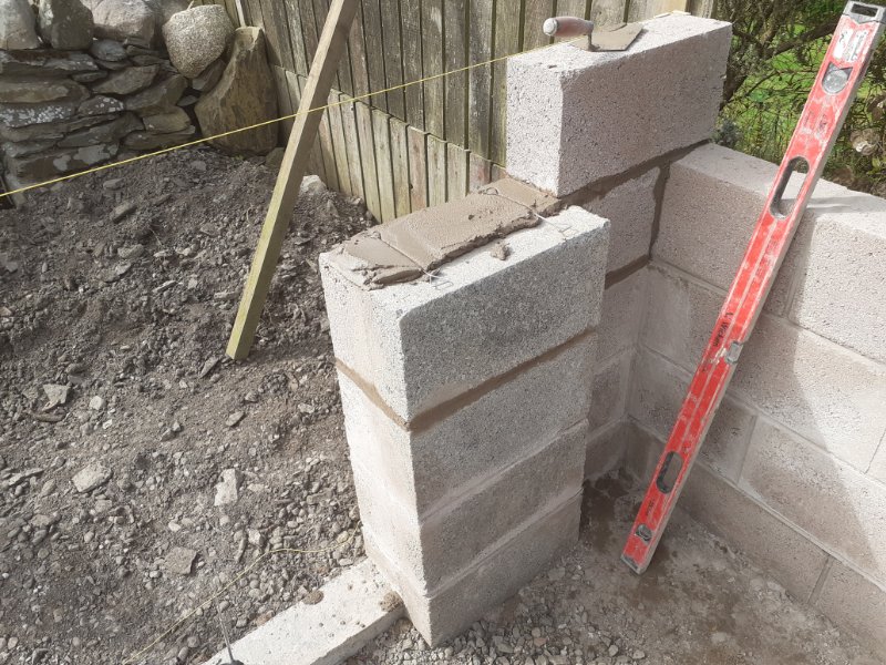

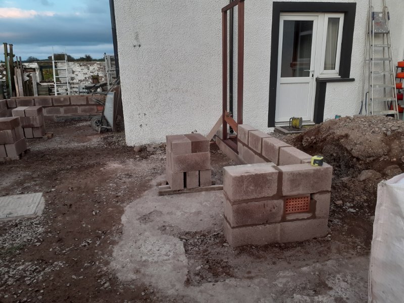

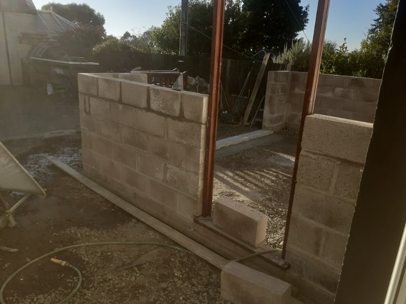

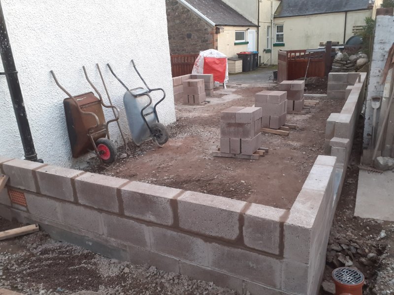

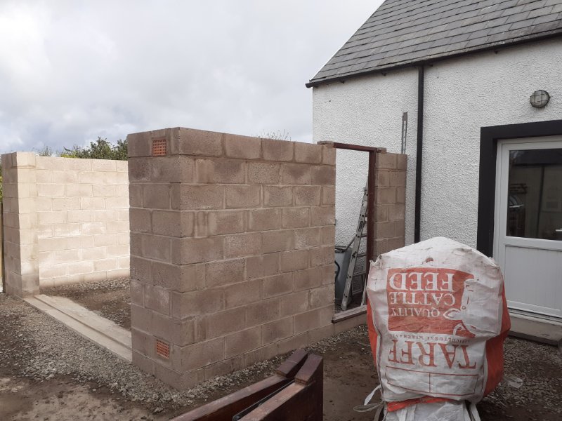

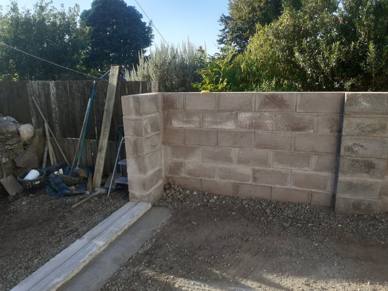

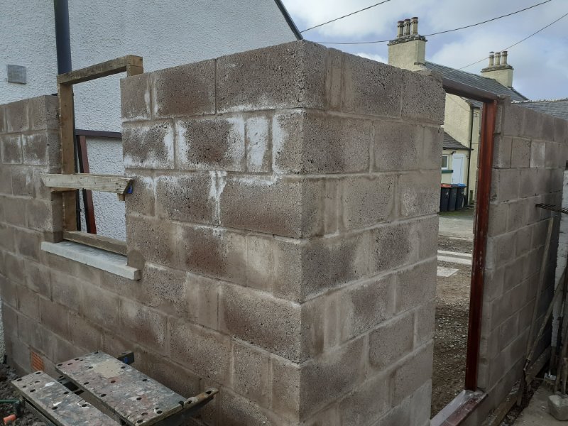

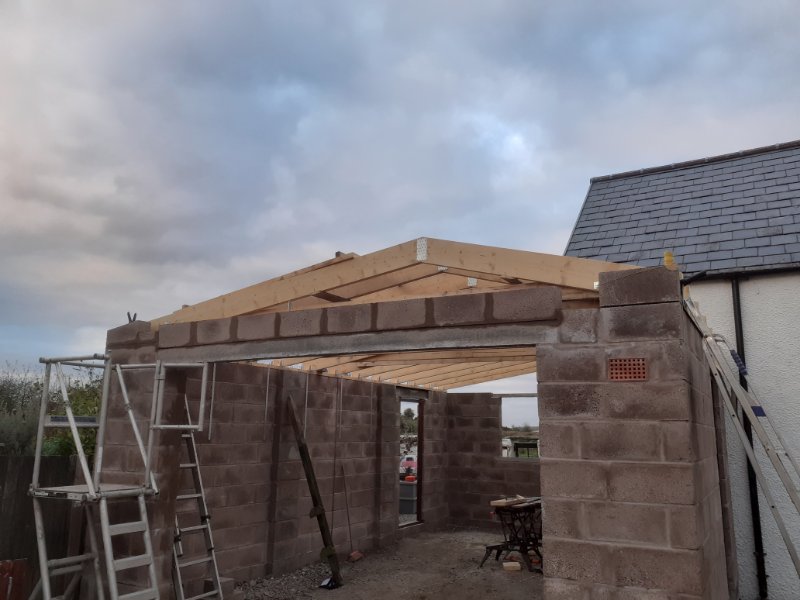

Wont bore everyone with rubbish about how I laid blocks, how sore my back was and how many times I clattered my fingers etc so heres a few pics of the process up to lintel height.....
Posts: 7599
Re: My Dream Almost Complete At Last!!
Few more....

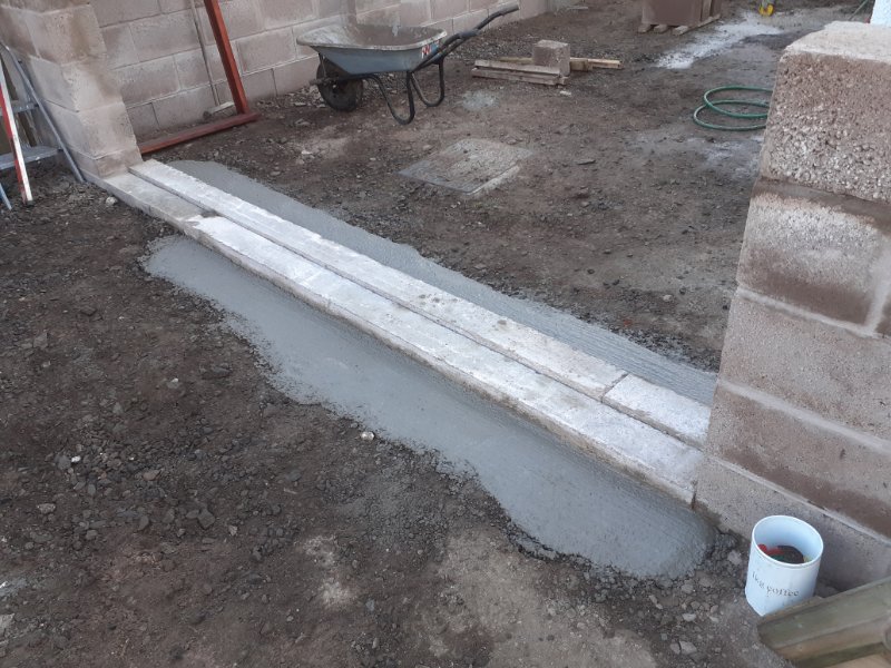

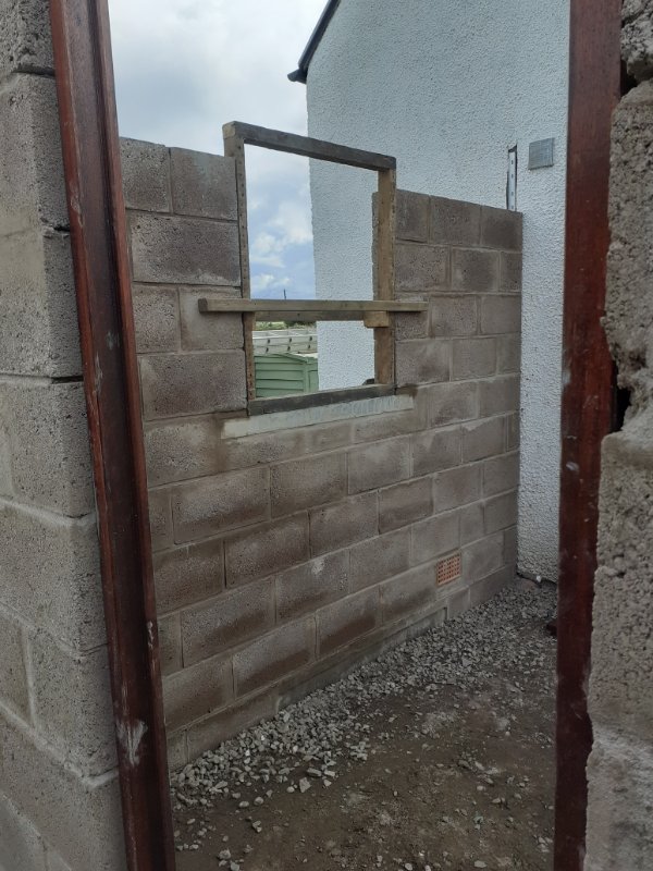

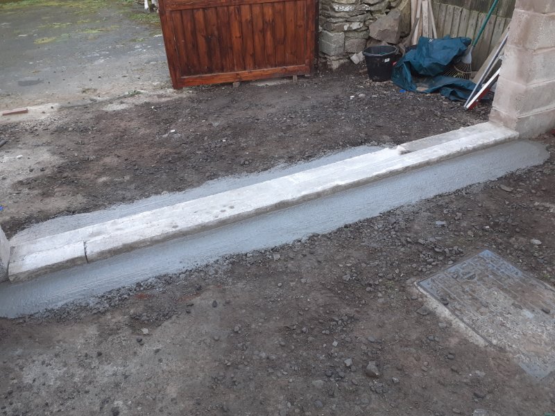

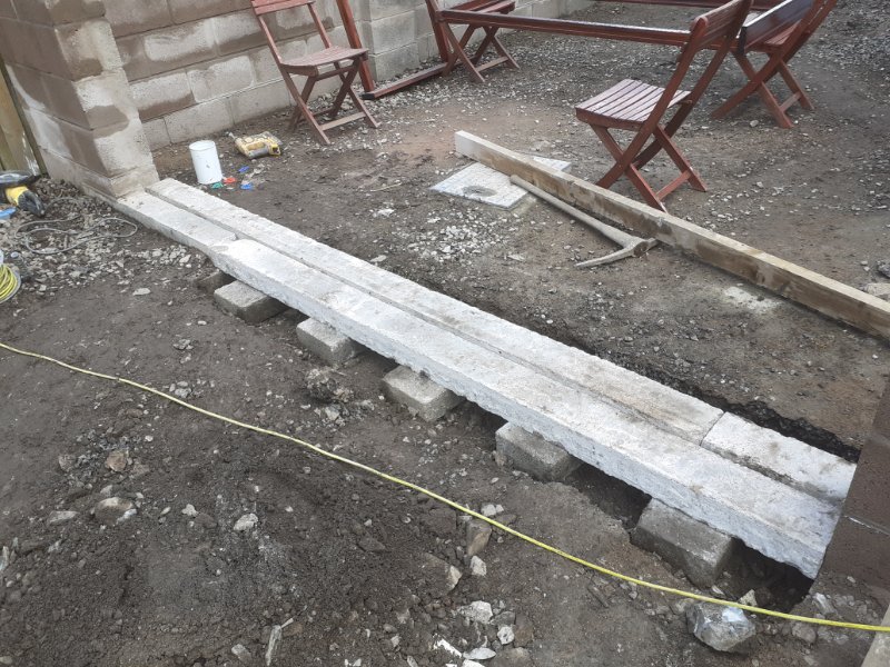

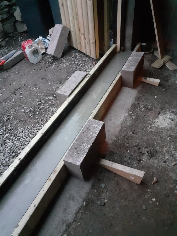

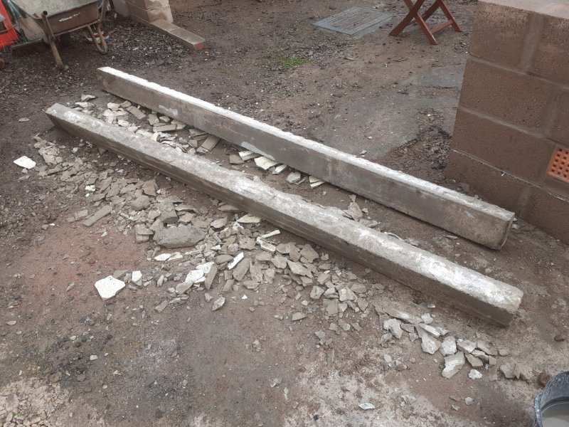

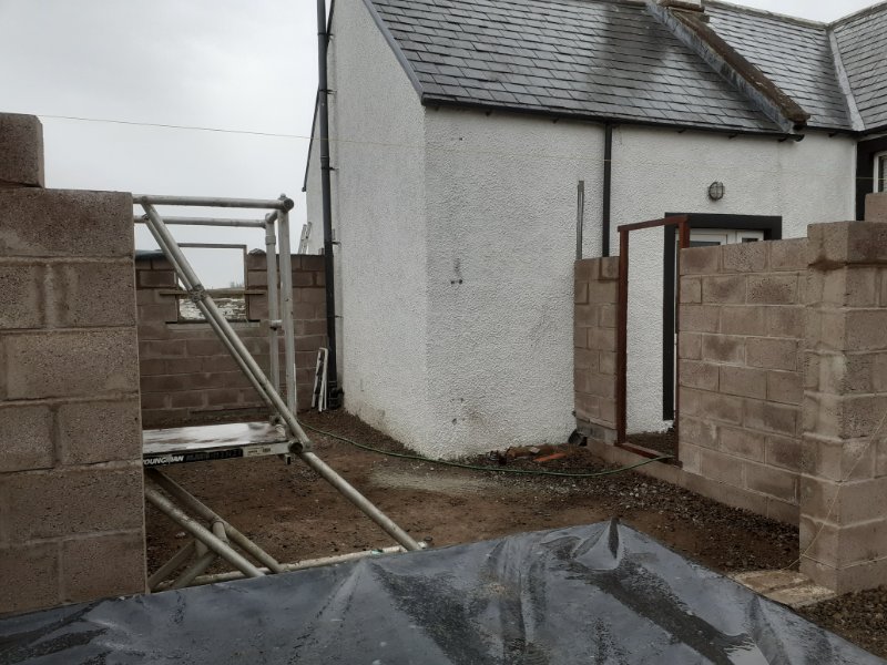

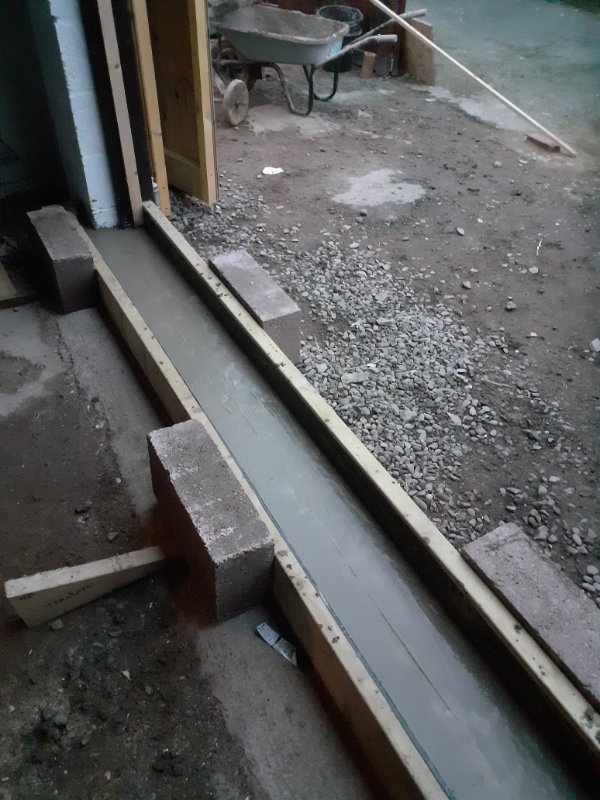

I was given a couple of used concrete lintels by a neighbour so decided to use them for a threshold for the main door. I offered to pay for them but he said he was given them by a customer when he did some work and the owner told him to just have them before his wife found a project for him to use them on :D
I decided to set them into concrete and it worked well....
Posts: 7599

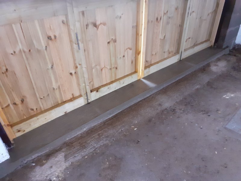

A bit out of sync but further down the line, I made some alterations to the profile of the threshold to allow the doors to seal neatly ..... sorry the pics are on end but Im not sure how to change that :roll:

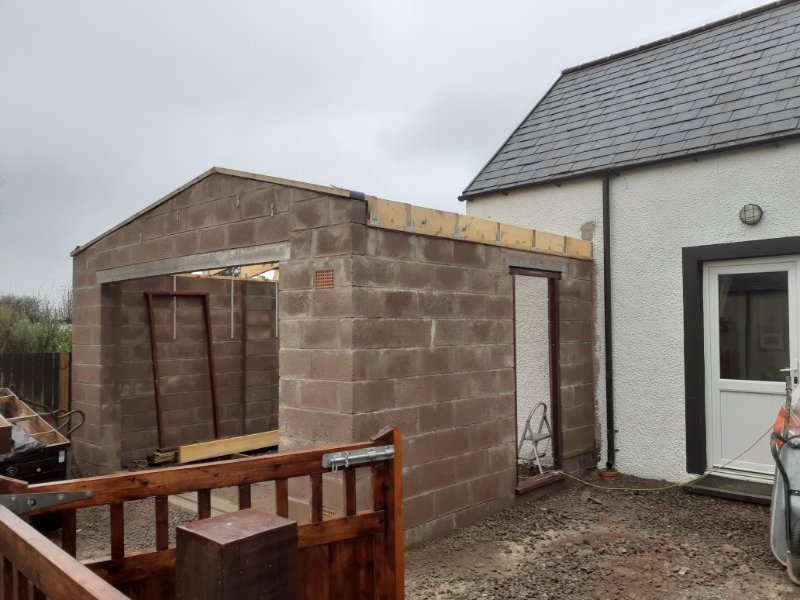

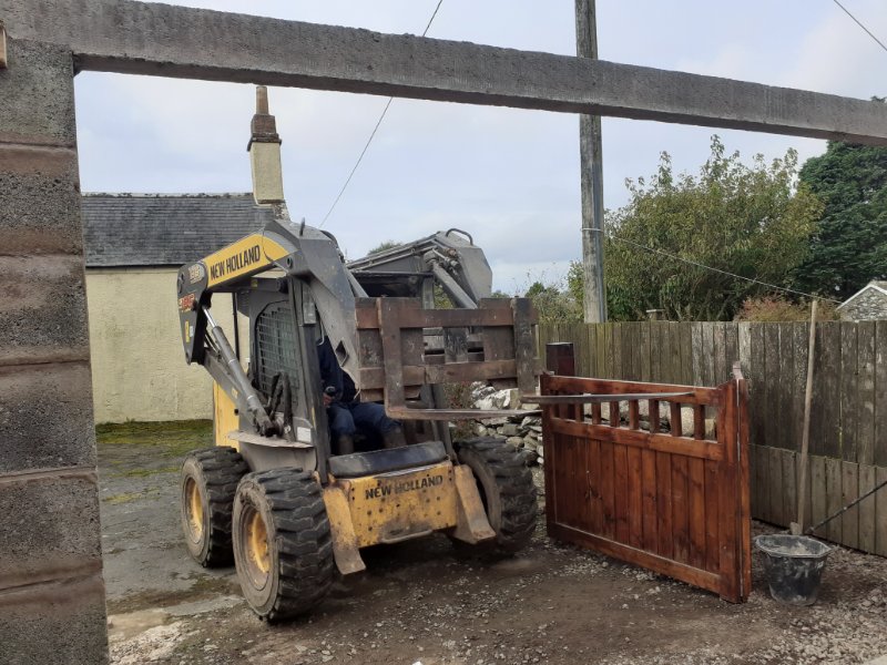

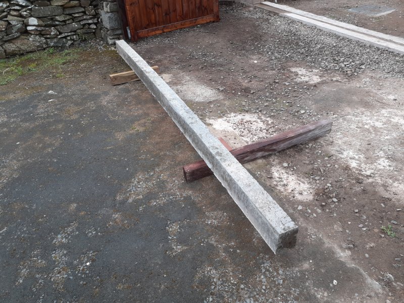

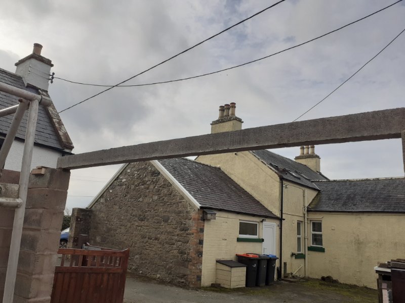

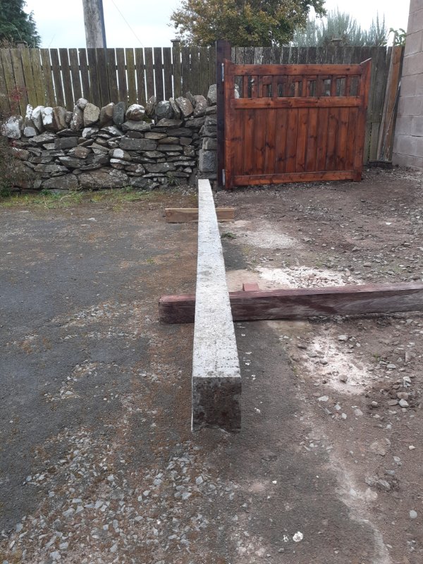

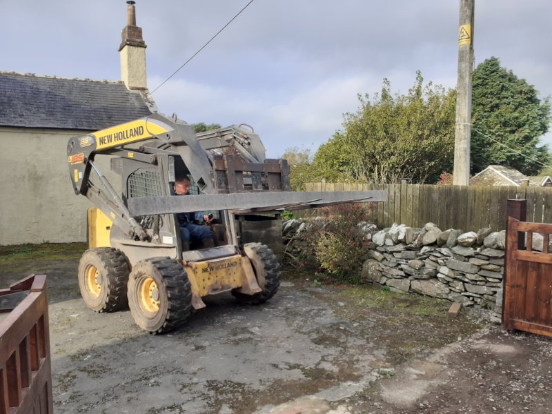

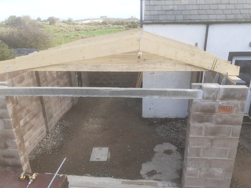

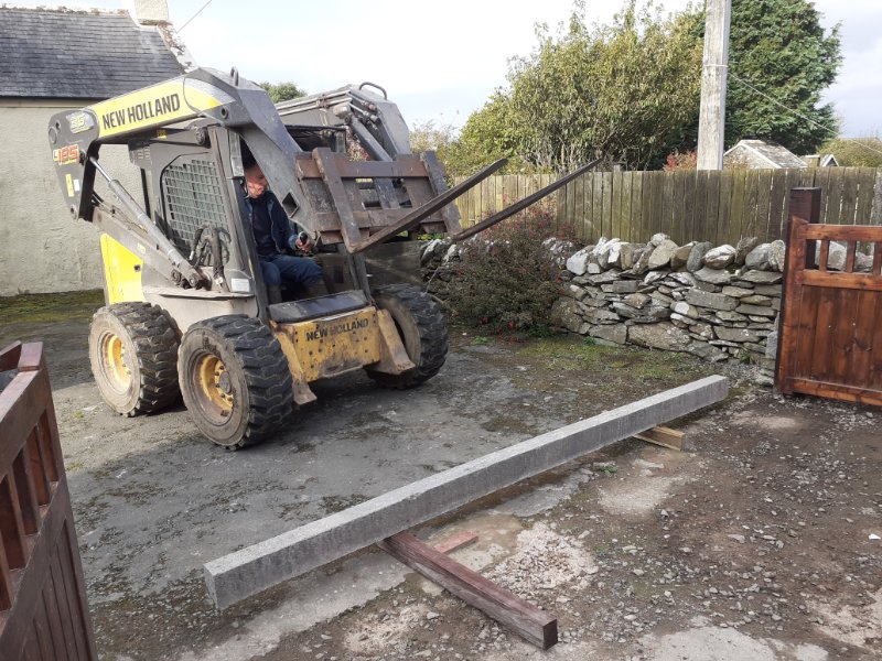

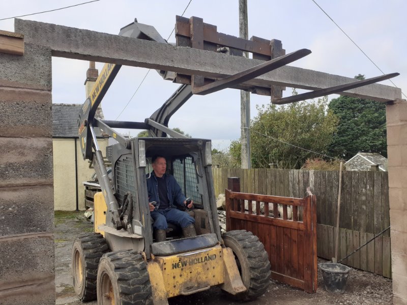

Finally for today, I had some very welcomed help from my farmer neighbour, Stuart, who had a very usefull bit of kit for placing the 3.6m concrete lintel above the door opening. I just couldnt have done this without help.

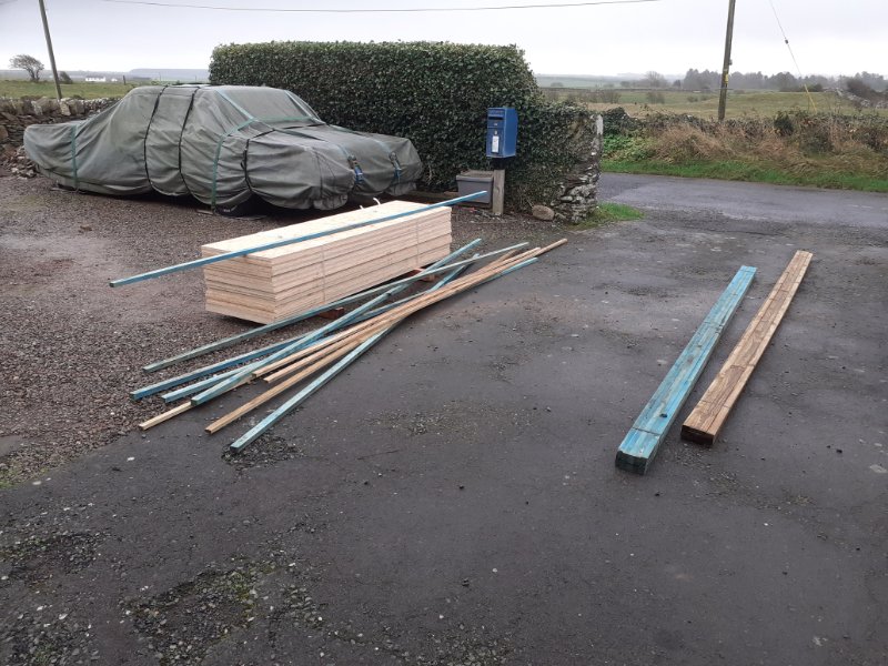

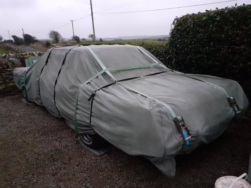

This is my current set up with the car. She isnt suffering at all but will be great to be in a garage. It takes ages to cover her back up after a run. When there is a spell of dry weather, I leave her uncovered to air :thumbright:

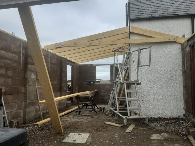

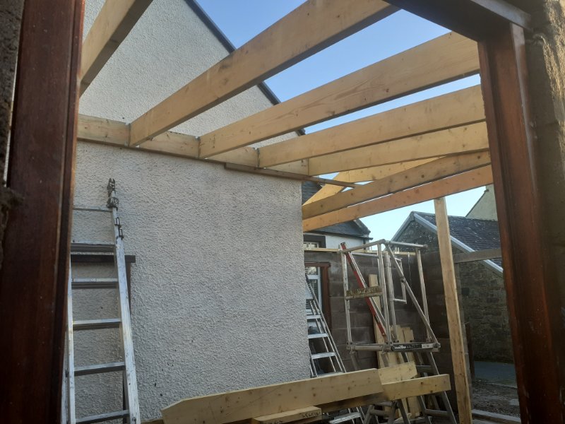

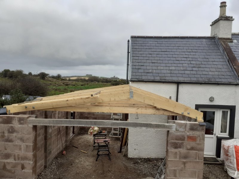

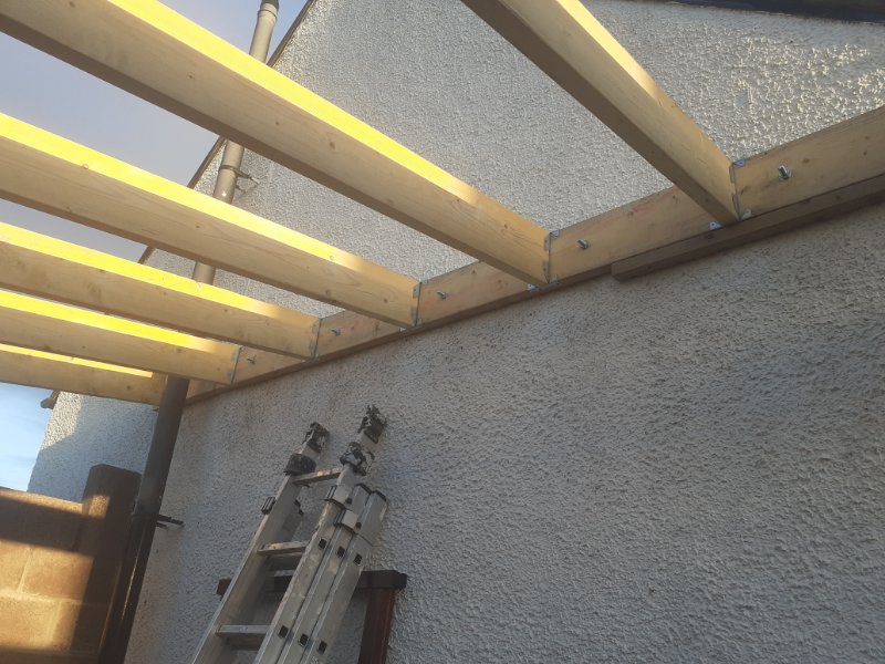

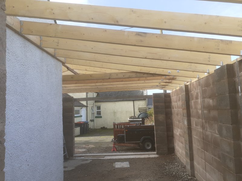

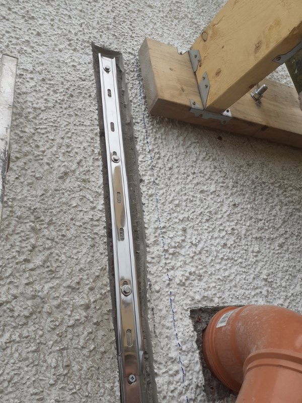

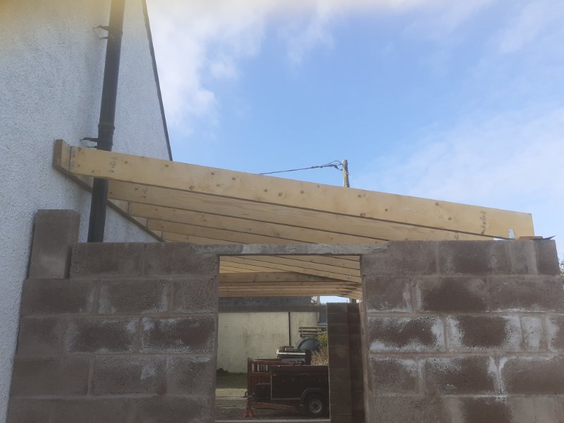

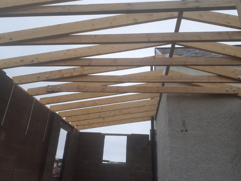

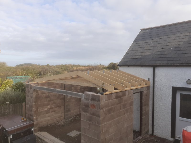

After I got up to lintel height, I started on the roofing timbers. I chemically bonded the studs into the house wall for the top plate and went slightly over the recommended timber sizes just to be sure it was strong enough....
Posts: 7599

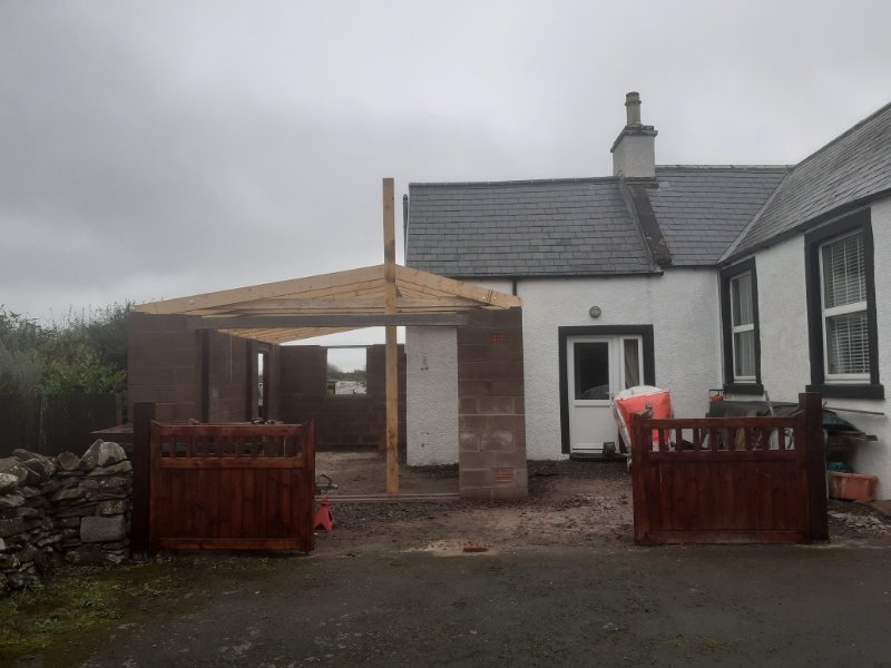

The single pitch side was easy enough but there was a bit of head scratching to work out the angles for the double pitch section....got there, eventually :thumbright:
I then started blocking up to the roof line on both ends
