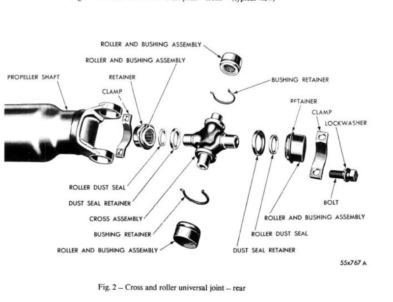

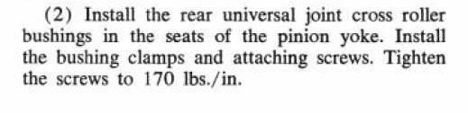

the caps and contour of the yoke take the strain, if the caps stay in the yoke these little bolts see little stress.
the straps are just there to keep the cap in position they are not in any way directly taking the load applied by the motor
Aussie service manual
small dodge UJ
pressed, flat strap UJ clamps 170 LB/In (inch not foot)
these are tiny bolts with an imperial size look to be some where in the 8 - 11 mm size range
on mine they are supposed to have split washers under. mine never have... one of them now replaced, it was a mess, had, had its head drilled for retaining wire. mis matched set originally on mine.. swapped out when the slightly bent axle pinion/yoke was removed and replacement gear set added 20+ years ago
if you are using the big dodge yoke with the wider cross and the bigger caps ... you'd probably still be fine with that or a little more
if you are using a custom one with U bolts that wrap right round the caps dunno... it would in theory be easy enough to do them up tight enough to stretch the U and put a dent in the cap... which you don't wanna do....
small dodge UJ
i am not yer man for drag race/ serious heavy duty focused U Joints and their U bolts as i don't have a motor that is heavy duty enough to warrant a swap. i.e when i run what i brung i brung nearly stock standard...

Cheers Dave.
Sounds like 15ft lbs could well be right, then.
