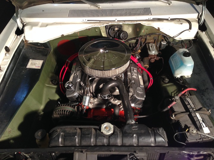

Covers on and a decent set of leads, misfire still present :roll: will deal with that another day. Spent a few hours today scraping off undercoating in preparation for the sawzall coming out....

Q. What's the red grommet stud thing you have installed inside on left on Ali tray ?
Posts: 14433
It's an MSD firewall feed thru for the coil lead,
http://www.msdignition.com/Products/Coi ... ,_Red.aspx
You can get something similar for the starter cable as well, which I'll probably use.
Very cleaver :thumbright:
looks like I will be taking my heater box back out :banghead:

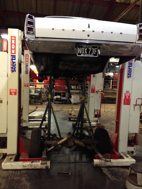

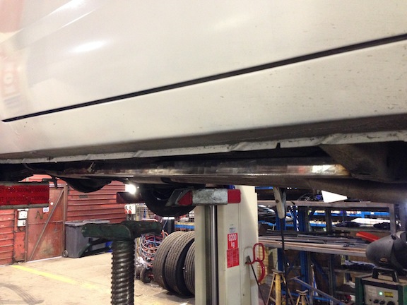

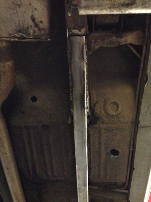

Long day Yesterday. Took the Valiant in to work at 6am for some chassis work, individual wheel lifts are great for this sort of thing, unrivalled access. Chassis ties in first, 2"x 2" box section. I tried something different this time, I cut a slot out of the bottom of the rear chassis section right back to where the spring mount is. The box section sits flush with the rear floor and hangs below the rear rail by about 3/4", making welding very easy. I had to grind down one of the ribs in the rear floor for a good fit and I can also weld the floor to the box section from inside the car.
Posts: 14433

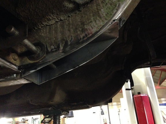

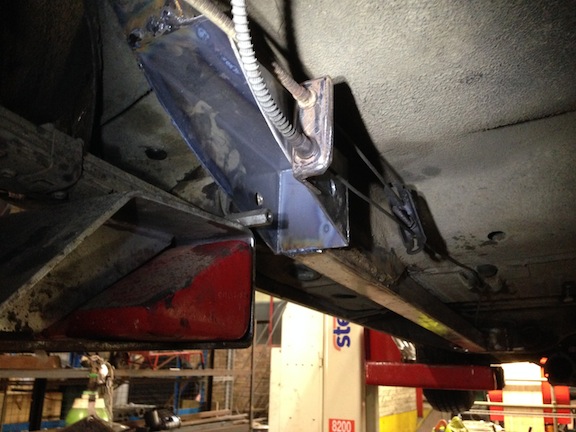

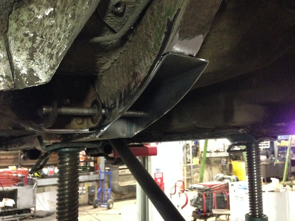

Dropped the axle out next complete with the wheels, springs, shocks the whole shooting match. Notched the frame for the spring relocation boxes leaving the outer side of the frame intact. I mounted the boxes a little lower than usual so they sat level with and butted up to the chassis ties. I shaped the boxes to match the original frame profile for a more stealthy look in these BIVA ridden times. By the time I've ground some of the welding flat and covered it in stone chip, it shouldn't look obviously modified to the untrained eye. Really happy with the way it turned out, so I slung it all back together and drove home at 4pm totally knackered...
I'm not ready to inboard the springs yet, but the prep work is done. More cutting this week....
