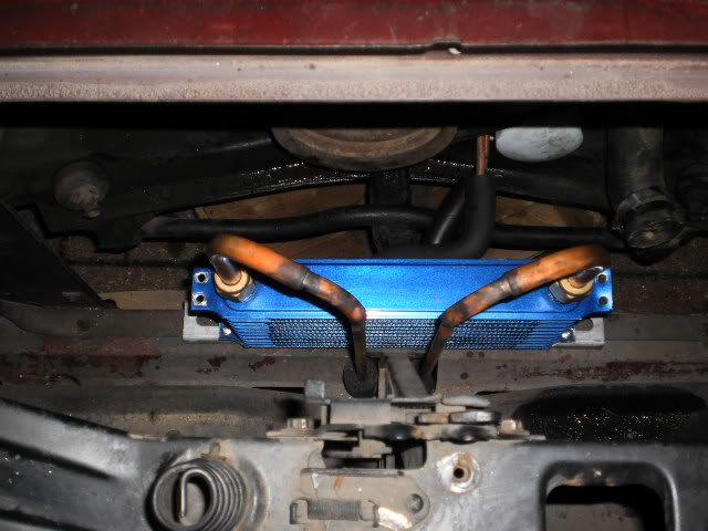

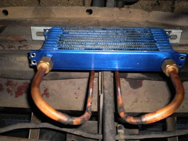

Pete spotted i had no gear box oil cooler at the show
I got and old engine oil cooler from a mates rice burner and my mate
(aircon man) made up some copper pipe work.
Will this be ok to keep my oil cool:?
<a href="http://photobucket.com" target="_blank"><img src="http://i73.photobucket.com/albums/i205/ ... sh/360.jpg" border="0" alt="Photobucket"></a>
<a href="http://photobucket.com" target="_blank"><img src="http://i73.photobucket.com/albums/i205/ ... sh/361.jpg" border="0" alt="Photobucket"></a>
Posts: 22109
Get some double jubilee clips on those pipes and jobs a good 'un :thumbright:
They look soldered to me Pete :scratch:
Posts: 22109
Other end, chap :roll:
That is the best kind of cooler you can fit and notice how it is not up against the radiator.
Take note others. ;)

Nice job looks neat !!!!!!

I told ya Will :thumbright: good job :D

Dave wrote:That is the best kind of cooler you can fit and notice how it is not up against the radiator.
Yup- got one o those off Dunc for my Truk. Still ain't fitted it tho... :oops:
Looks like it will be when the radiator's fitted :scratch:
Or am I missing something? :? :lol:
Pete wrote:Get some double jubilee clips on those pipes and jobs a good 'un :thumbright:
:oops: how did you see that :oops:
I have left a 2-3 inch gap between the rad and cooler.
(the rad in off set abit and does not sit flush so there is a gap )
As long as you have at least a quarter-half inch gap. More is better. But it looks like the rad will have that when in place? Didn't look like a 2-3 inch gap was possible though? :?
