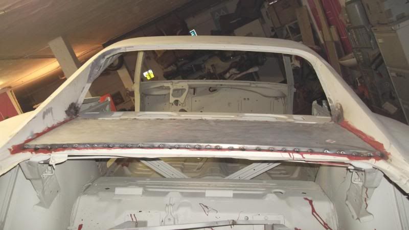

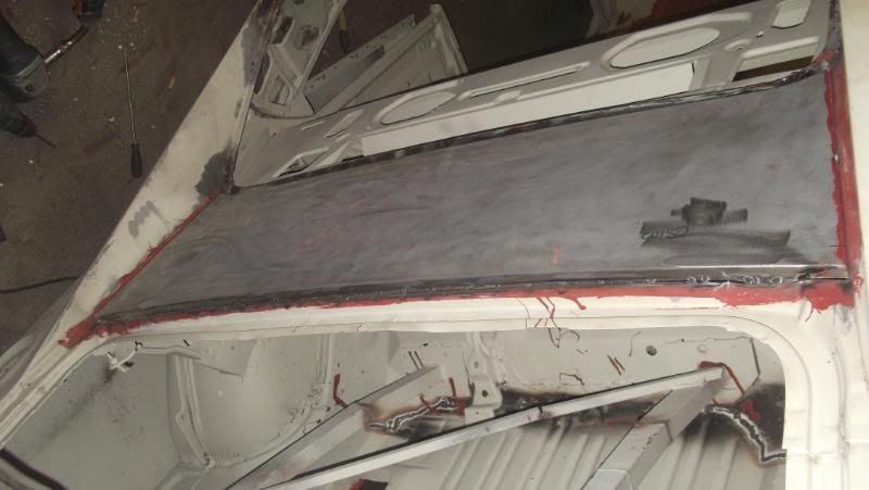

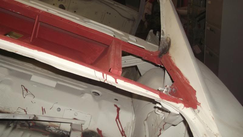

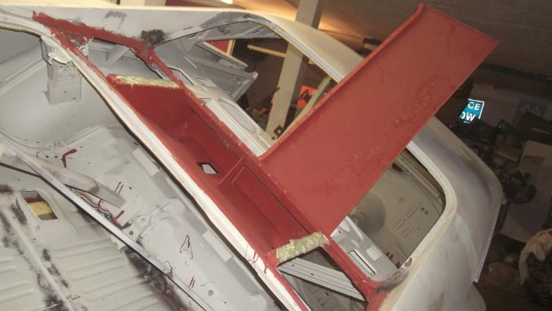

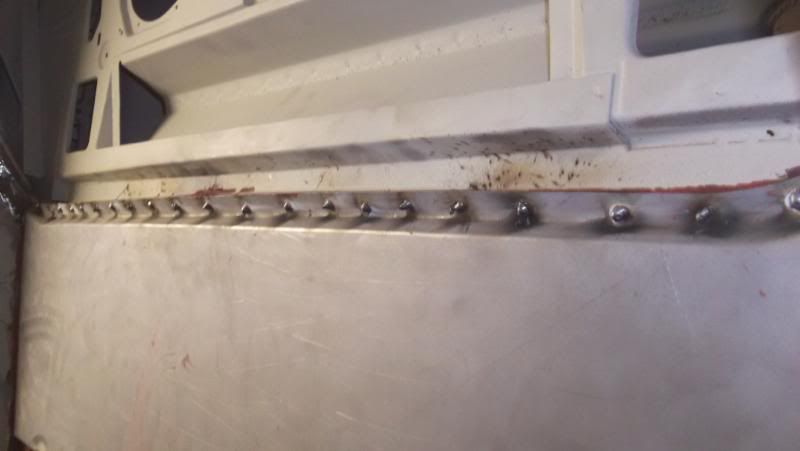

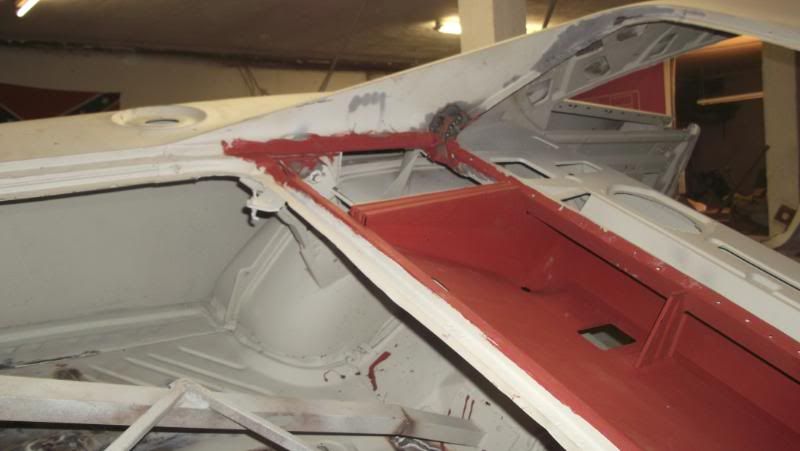

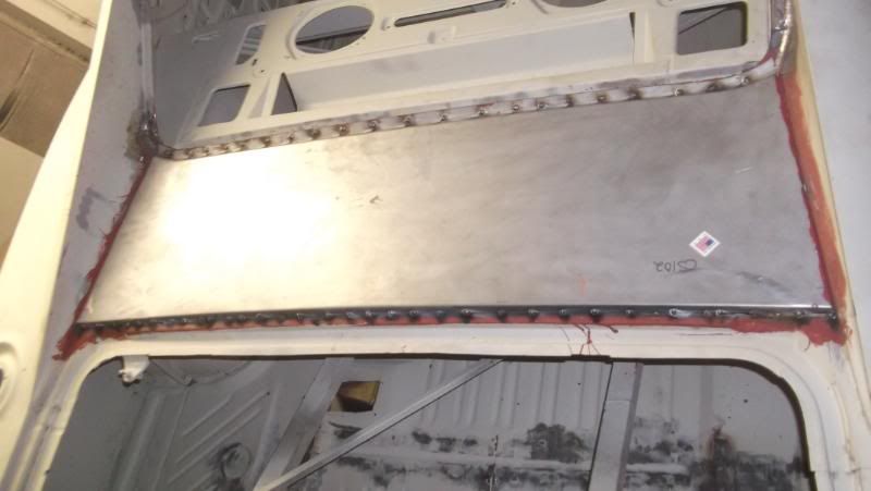

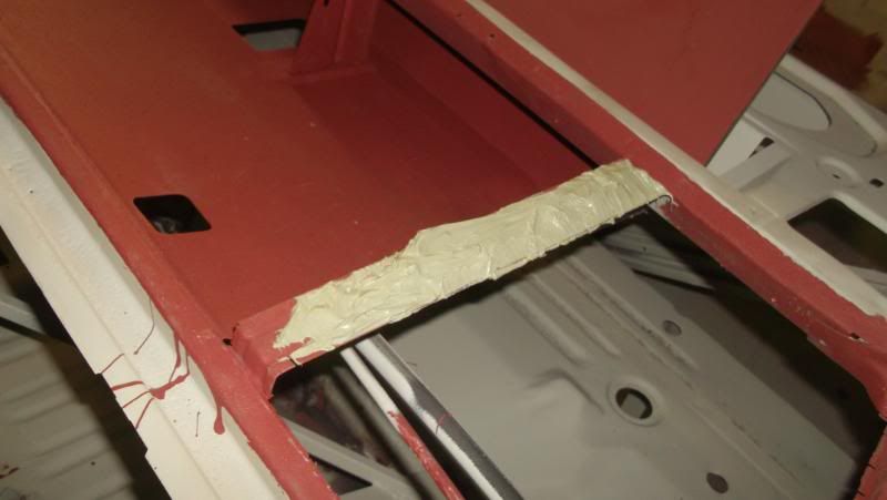

I final got the rear sail pannel on.
drilled holes
filled them with weld
some seam sealer stuff under to help with vibration
patched up other holes around rear window
201 days until moparnats must hurry up

drilled holes

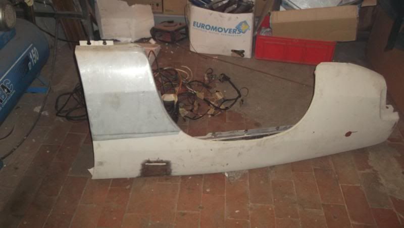

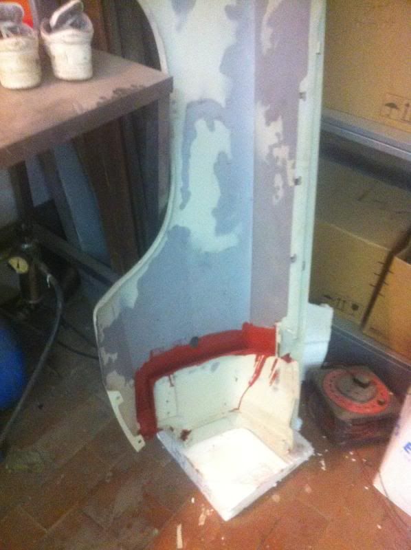

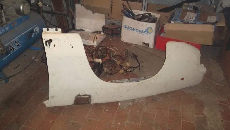

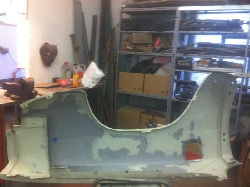

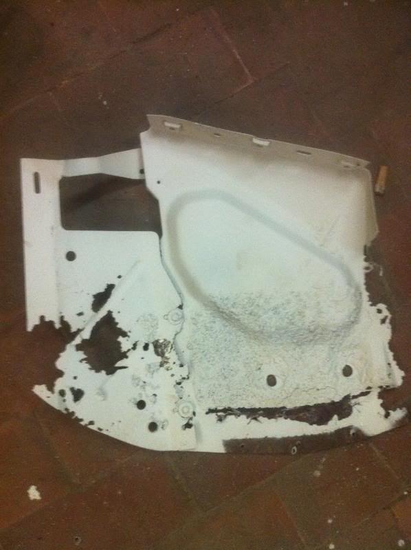

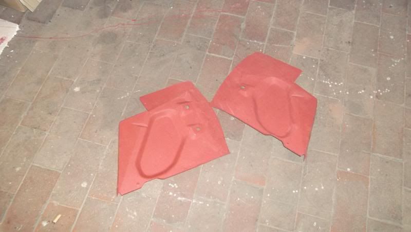

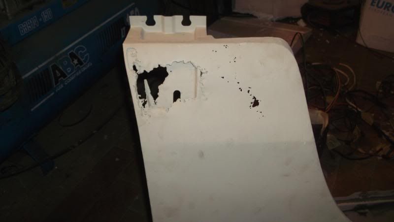

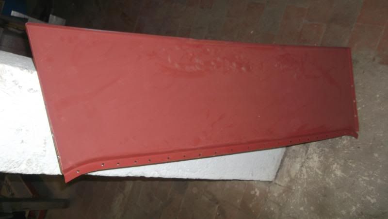

Next up the front wings
Mr Fiber Dale doesn't have molds so looks like I'm stuck fixxing these
Loads of repairs needed.

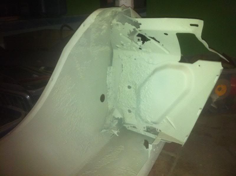

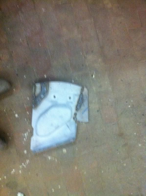

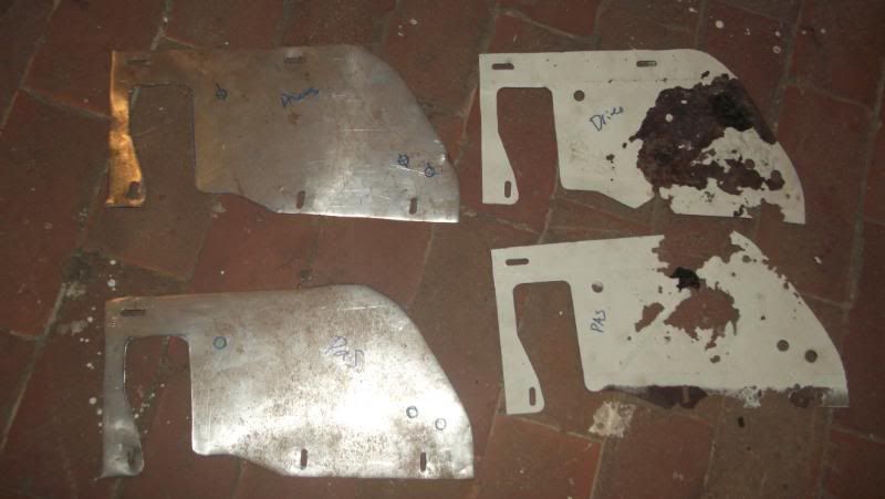

Still quite a bit of under seal on so i scraped it off and dropped it in the sand blasting tank and got it back to metal.
Removed front inside part and sandblasted inside cavity and painted

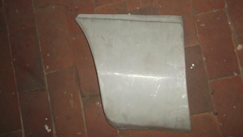

I have order year one lower repair panels how would you fit these.
Butt weld or overlap ???
Advice needed
Advice needed

Cut out the old. The repair panels from yearone seem to be pretty good based on the ones I've used.autofetish wrote:Next up the front wings
I have order year one lower repair panels how would fit these.
Advice needed
This may help you:
http://www.mopartech.net/showthread.php?t=3867

Oh. Tough one. I have done both in the past. Very hard to do on flat bodywork without distorting the steel.autofetish wrote:I have order year one lower repair panels how would you fit these.
Advice needed![]()
If it was curved I would use Intergrip welding clamps which leave a gap in the butt edges. But I think for a fender repair panel I would overlap. The extra thickness will help stop the panel distorting.
But you need a lip on the edge of the repair panel so that the front surfaces are flush.
