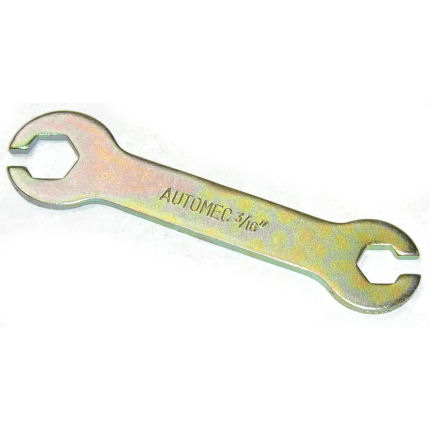

I had to do this to get my pipes off (replaced them all). However, you *may* get lucky with one of these. Gets a proper grip without rounding them off. Worth a go...Dave wrote:Cut the pipes flush with the fittings and use a socket to remove them.
Other than that, cut them off and a socket. I had to hammer one on it was so rounded !
- spanner.jpg (26.57 KiB) Viewed 387 times
