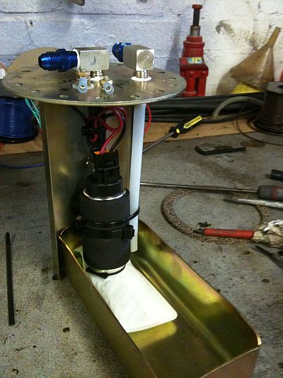

Fuel Tank completion and install
Finished assembling the Pump/pickup/sump
A bit of thread sealer on the fittings, and then fit the pump, filter screen , and return tube . Good to go . It turns out that all the mounting screws *were* included in the kit - I'd just mislaid them .

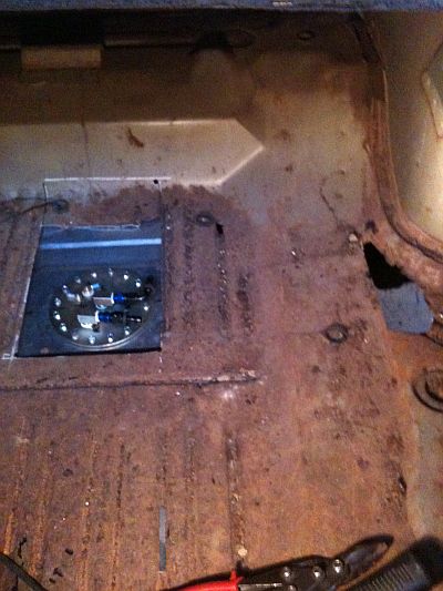

Boot floor marked for cutting . As previously mentioned, you could avoid this by recessing the pickup unit into the top of the tank.
You can see I'm not being too tidy with the boot floor here, as it's going to be replaced eventually anyway.

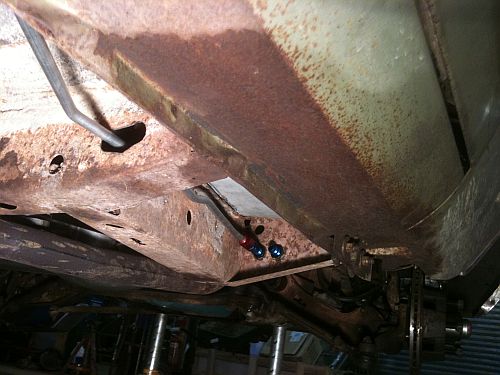

I was going to bring the send/return hoses out over the front of the tank, but discovered too late that the mount for the RH tank retaining strap is right in the way.
Decided instead to bring the hoses sideways and over the top of the chassis rail, before heading under the car through the hole you can see behind the rear wheel. Fortunately this route will actually make the hardline route underneath the car much easier.
The plumbing inside the boot will eventually be boxed in.

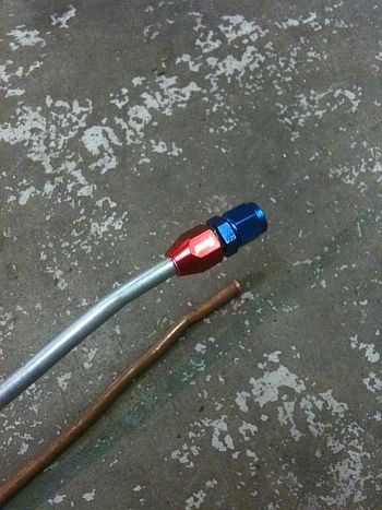

Running the hard lines, front to rear.
Bought two coils of 3/8" steel tube from Summit. Thought about using aluminium but didn't fancy it on a road car.
The -6 fittings attach to the end with a compression joint. Best to grease the threads & olive first.

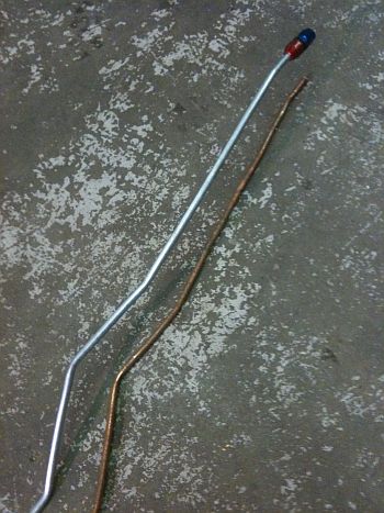

Bending long pieces of tube is not my favourite job . It's so difficult to get a sequence of bends in at exactly the right angles.
I hand-bent a couple of pieces of copper tube first to use as patterns. This helped a lot.

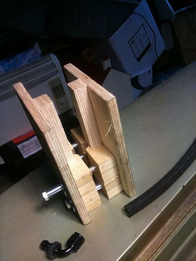

The flexible hose and -6 AN fittings supplied with the kit are made by Fragola.
The hose is meant to simply push over the two barbs on the fitting.
I heated the hose in boiling water, oiled the hose & fitting, clamped the fitting in a vice and spent ten minutes trying to wrestle the hose on. There was absolutely *no way* it was going over both barbs. No Way. And there were going to be about fourteen of these to make up.
So I made a clamping block with a cylindrical recess to hold the hose, and put the whole thing in the press . That showed it who was boss. Although to get the hose fully installed onto the 90-degree fittings you are right on the point of bending the elbow on the fitting itself.
