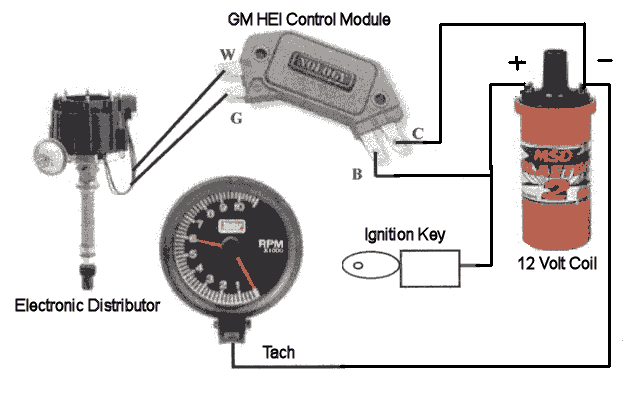

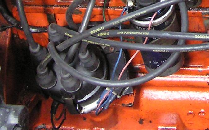

Posts: 9564
here is how i did it
aaa hei_pic.gif (19.87 KiB) Viewed 584 times
aaa hemi chev ignition.JPG (49.4 KiB) Viewed 584 times
Posts: 7465
Thanks Dave...I printed that off from a previous thread that you did and the photo is really helpful thanks
cheers Steve :thumbright:
