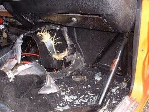

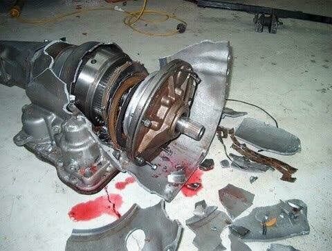

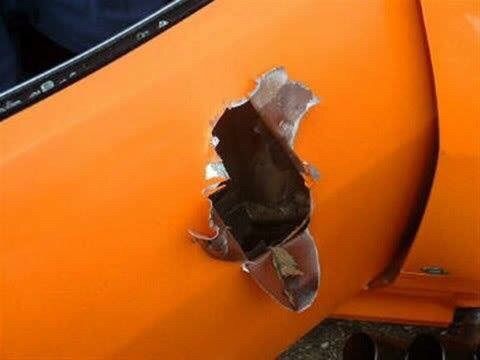

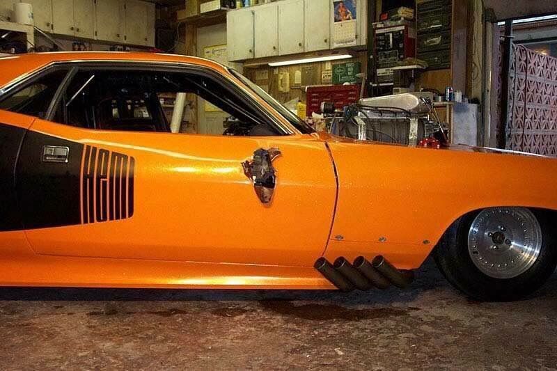

Guy told me that you never do a burn out in 1st, I can't remember why but something about things breaking. Why is this please?autofetish wrote:Burn out in 1st gear ?????
2nd is the only way
Honey, I blew up the trans...
- autofetish
- Posts: 5599
Yep.....remember a thread about this issue some years back. In some cases the trans has exploded in first with such ferocity it has ripped through the floor taking out legs and other gory stuff.Pete wrote:Correct, and then the front drum spins up to twice Engine speed and becomes a cast Iron hand grenade....
Trans shield anyone..........
