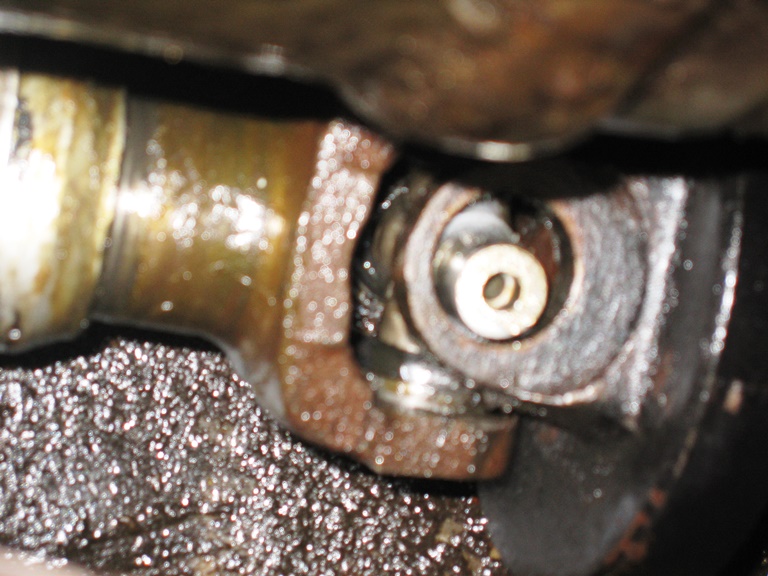

I first saw that the front bearings in the prop were gone.

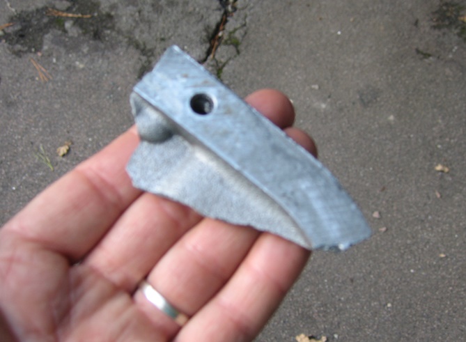

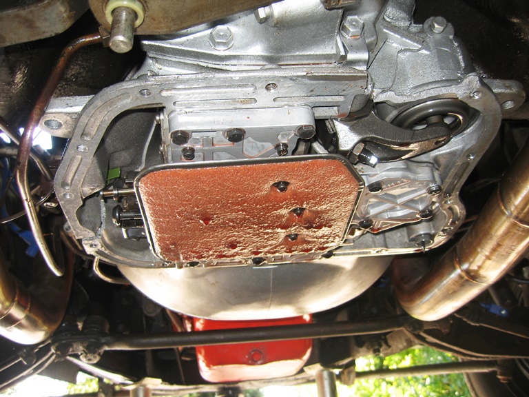

Then took off the oil pan and found the trans case has cracked from side to side :shock:
So that looks pretty terminal then.

i would think you have had something come apart in the trans to blow that case like that,
Posts: 14459
I had a 727 in some years back that had let go on a rolling road. The case had split into 3 pieces. There was no other damage inside and nothing I could find that might have caused it, I thought maybe it was a casting flaw.
Posts: 9570
might just be 40-50 year old aluminium....you don't know what previous owners did to it :)
the cast wheels on my car have a life of 6 touring car races according to Chrysler (obviously big tolerance in that, how long is a piece of..... erm Race) before they were supposed to be scrapped...
road use had no use-by date due to using road tyres road suspension and road shocks.
but stressed aluminium does tend to get minute cracks in it
penetrant dye on a different case makes sure you get a goodun

Why would the UJ go on the prop if the box had let go?
:shock:
Prothed
Posts: 480
Location: Dave of Bexhill
Post by Prothed »
It's a mystery. Once the trans is out it might be clearer whether the UJ is the chicken or the egg...

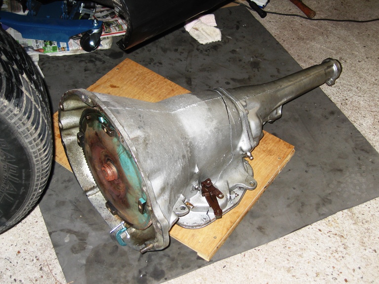

Well I got the trans out, and I think it has definitely had it :shock:
When I have time I'll look inside (not difficult now!) and see if there is any clue as to what the cause was.
In case anyone is wondering - Can you drop the trans yourself after a working life spent behind a desk? Yes. Do you want to? No you don't.
Posts: 22137
Well done, and yes, they are a heavy beast....
I think the warranty on that one has expired.
Posts: 14459
That looks to have split pretty much in the same place as the one I mentioned, across the rear servo shaft hole, round the case and across the selector shaft hole.
Burn out in 1st gear ?????
2nd is the only way
