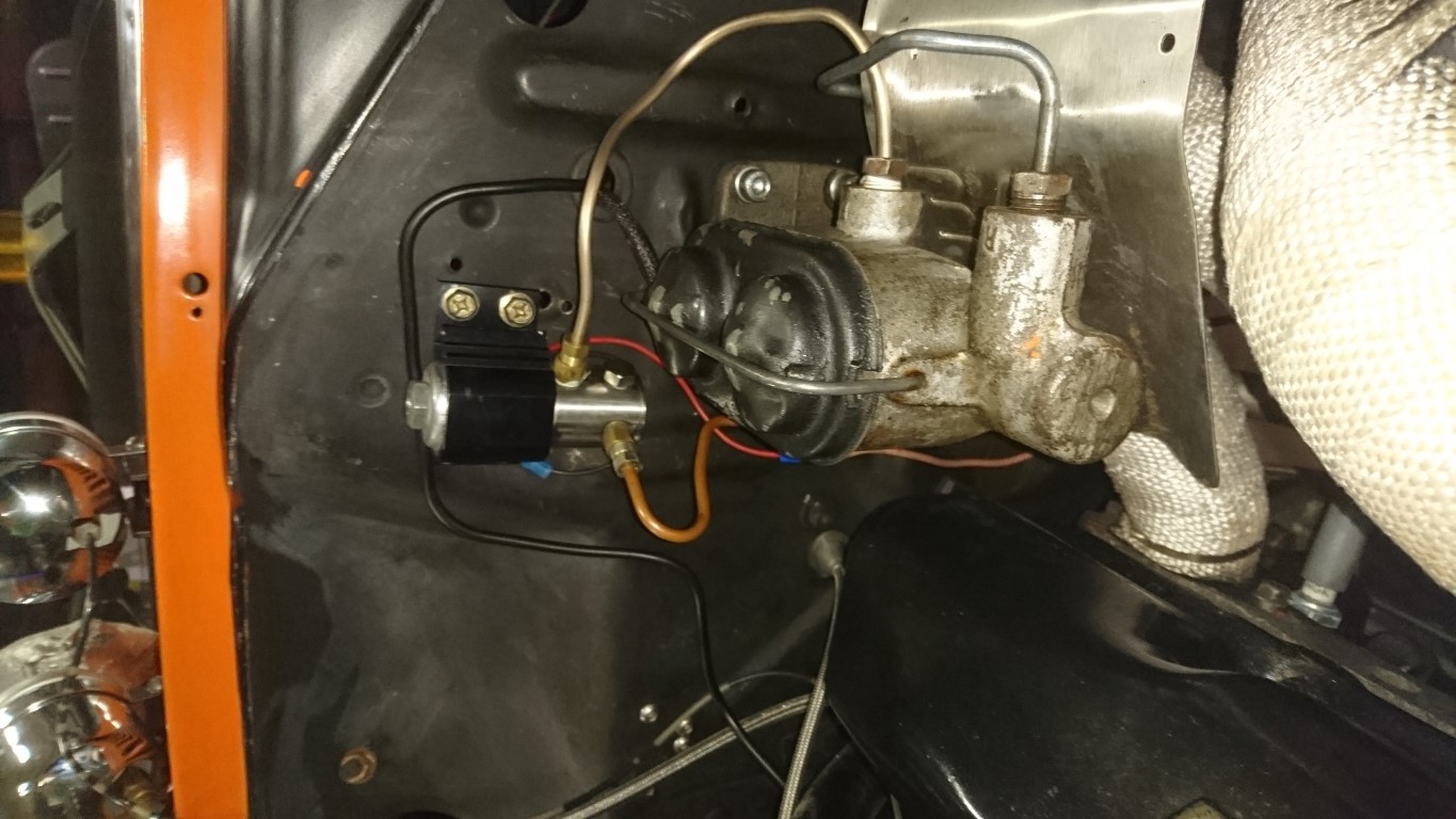

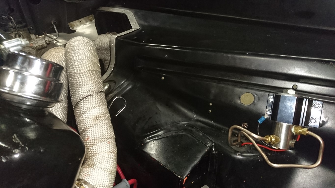

I've now finished the Line Lock solenoid move so it's further away from heat sources and now below the master cylinder level.
This, along with bleeding the master correctly
:oops: (which I didn't appreciate fully or do) should help hold the fronts and stop me rolling forward on the line when I bring the revs up.
....... all settled in a new home.
LINE LOCK MOVE 05 (Medium).JPG (237.75 KiB) Viewed 7362 times
........and there it was, gone.......
LINE LOCK MOVE 04 (Medium).JPG (255.5 KiB) Viewed 7362 times
New pipe routing
New pipe routing
LINE LOCK MOVE 03 (Medium).JPG (229.35 KiB) Viewed 7362 times
Old location above the reservoir
LINE LOCK MOVE 01 (Medium).JPG (227.11 KiB) Viewed 7362 times

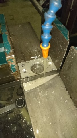

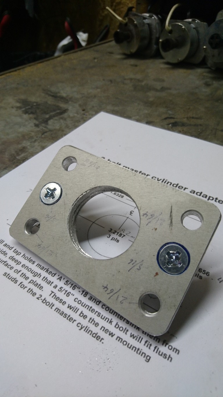

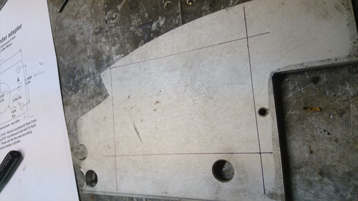

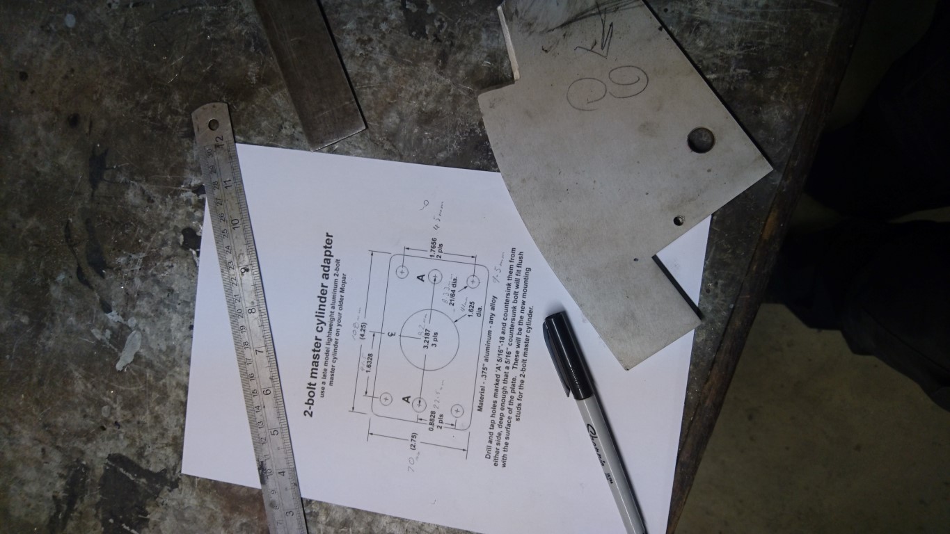

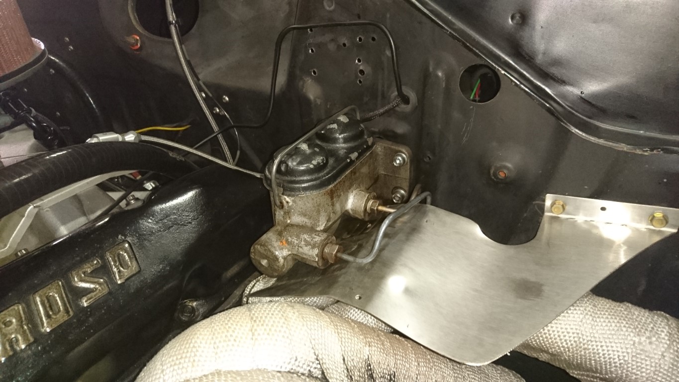

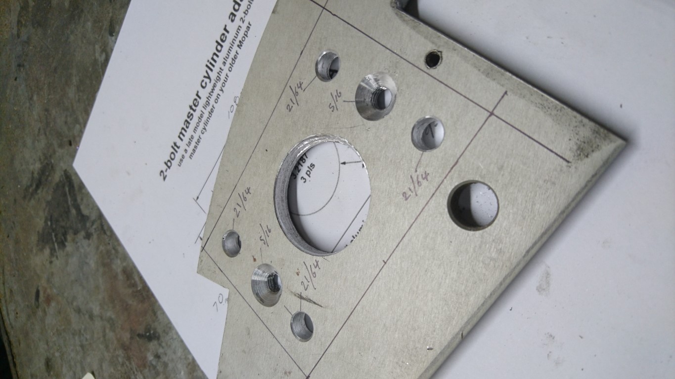

So I have now replaced the leaky master cylinder with a Strange unit from Hauser Racing, jolly decent chaps :thumbright:
I decided to fabricate my own adaptor plate and adjustable push rod to screw onto the push rod that comes with the cylinder.
I now have a much firmer feel and the pedal no longer sinks after a few seconds :thumbright:
The heat shield might need an update though as this unit is longer than the old one.
Master Cylinder adapter plate (6) (Medium).JPG (196.87 KiB) Viewed 6946 times
Master Cylinder adapter plate (5) (Medium).JPG (210.05 KiB) Viewed 6946 times
Master Cylinder adapter plate (3) (Medium).JPG (233.38 KiB) Viewed 6946 times

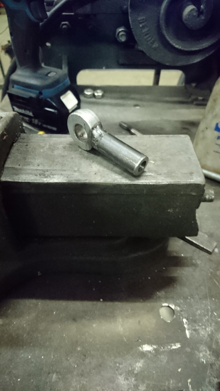

Making use of an old ally motor plate off cut.
Master Cylinder adapter plate (2) (Medium).JPG (206.98 KiB) Viewed 6946 times

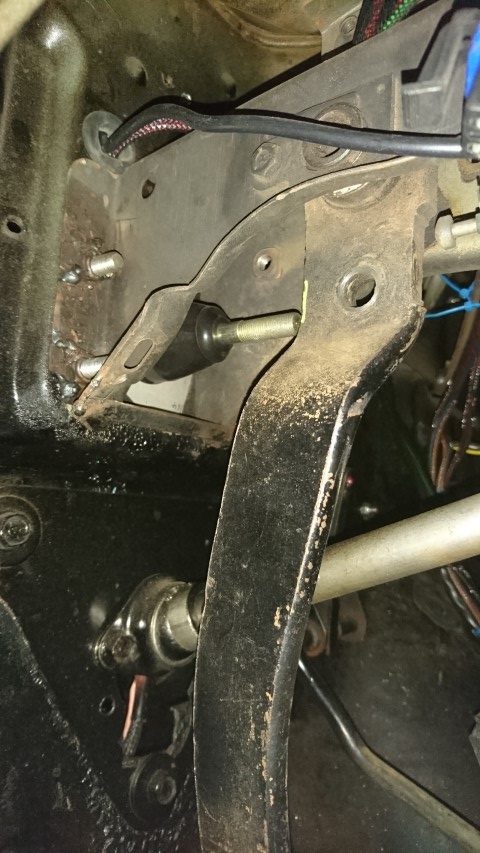

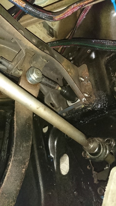

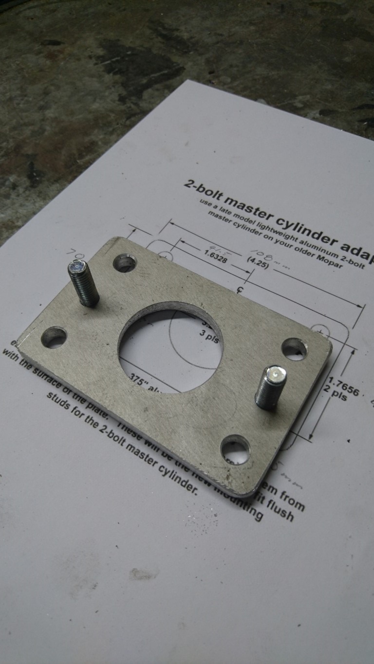

Finished plate and the push rod to pedal connector :)
Adjustable push rod (5) (Medium).JPG (218.17 KiB) Viewed 6939 times
Master Cylinder adapter plate (1) (Medium).JPG (227.29 KiB) Viewed 6939 times
Master Cylinder adapter plate (7) (Medium) (Small).JPG (62.29 KiB) Viewed 6939 times
Master Cylinder adapter plate (8) (Medium).JPG (216.83 KiB) Viewed 6939 times
Adjustable push rod (7) (Small).JPG (169.48 KiB) Viewed 6935 times
Adjustable push rod (5) (Medium).JPG (218.17 KiB) Viewed 6935 times
Adjustable push rod (1) (Small).JPG (167.76 KiB) Viewed 6935 times
Nifty, I did something very similar on the Valiant, except I used a rose joint 'cos I'm fancy like that...
Demon James
Posts: 1062
Post by Demon James »
:lol: that was the plan, believe it or not. But I used my last 4 up making the transmission braces to the cross member.
I wanted to get it done today so I went a bit "scrap heap challenge" style, it's ended up ok though, nice smooth action with no friction and with the money I saved I'm going to have a pint ;)
