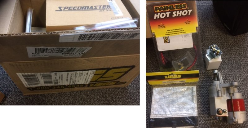

Ordered this on Sunday. Look what postie just brought ! Thats not bad is it ? 2days from the USA ! True, I bought the wrong starter motor and accidentally got a hot-start-kit but hey - I'm gonna go with it. It'll be better than the one I've got. So, starter, heat wrap, new relay and *maybe* the painless hot-start-thingy. Job should be a good 'un...

whats up with the starter
looks like a denso to me....
if the wires don't fit you can get a range of attchments that bolt on to whats there and present the connectors at a different angle to the cable
might keep it away from the headers...

Oh its fine; it looks to fit. attachments are the same.
I meant to buy the $120 one and bought a $63 one instead as part of a pack (heat shield, painless and starter). Hence I dont know if I will do the painless thing or not. If it works, its cool...

yeah it will be fine there will be little or no difference between the 2 motors
regardless of cost, all the bits inside are the same size and shape
one can only presume, in the more expensive ones that there has been some kind or materials or bearings upgrade
or maybe the paint for the case is damned expensive
unless its obvioulsy a custom job with multi mount front on it i really can't see what they do to this starter to make some of them $400+ and some of them $68.
the same starter was used on petrol diesel and industrial/plant engines like generators trucks and cement mixers
each engine type was probably accommodated by slight variation in the gearing inside the motor and the number of turns in the windings of the motor
It would not surprise me if any starter sold as a hi torque version for a mopar is a denso with the motor windings and gearing of a diesel or plant starter motor.
therefore the only thing the seller has done is paint it a nice colour add the appropriate attachment and cover to the terminals to orientate them to where the wires come from and away from the exhaust and fit an appropriate pinion for the intended application. those wire terminal kits are about $20 off a denso agent, the pinions are $15-25 and to fit one with the correct denso tools is a half hour job.
maybe my cynicism is unwarranted and the people who sell this stuff work very hard to make a better product than the original denso design, created by a large multinational corporation that most probably finances its research and development to a great extent.
A motor which was used in millions of vehicles across most continents throughout the 80's 90s and 00s and maintained a good reputation from the arctic to the sahara..
:) i'll shut up now :)
i think you made a good purchase
