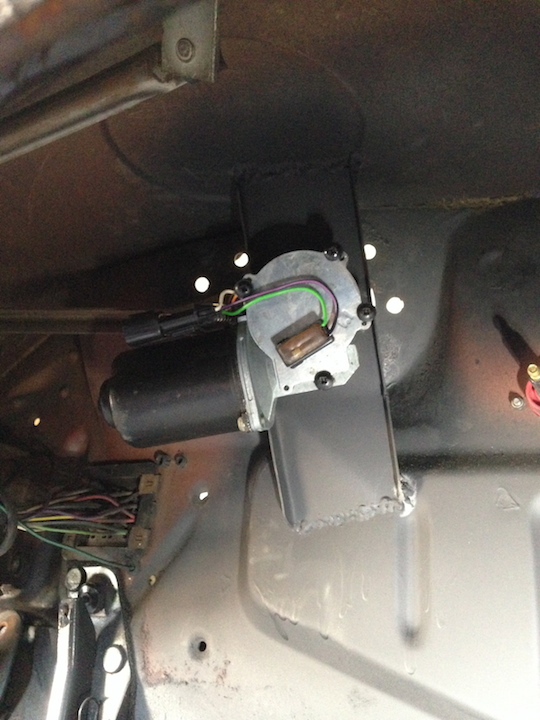

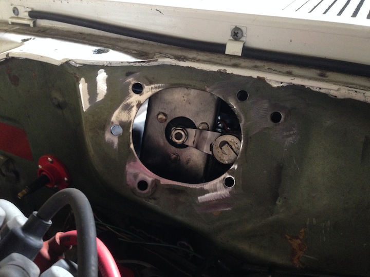

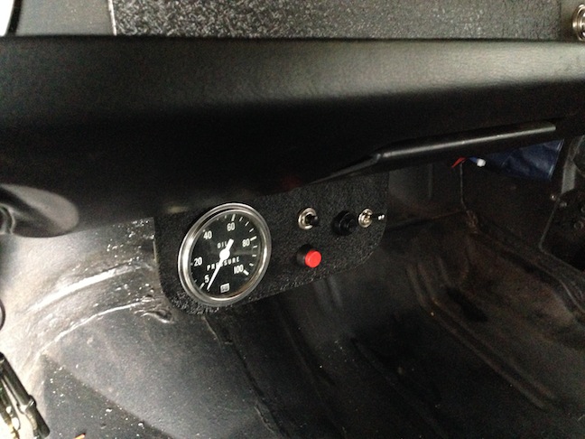

I had to get Dave 999 to figure out how to work the Astra wiper motor from a toggle switch as it has weird park wiring, a couple of relays sorted that out, cheers Dave! Made up a panel to hold the wiper, horn,washer switches and an oil pressure gauge, this is a temporary fix for now. Well pleased with the results and I saved 2lbs into the bargain...
Posts: 14431
Loadsa room!
It was me who questioned the sale of your old bits Blue.
Now I know why.
Great idea to move it all inboard to create room for working on the engine.
And save a bit of weight !!! ;)
You can always empty the bag for racing as well !
very clever :thumbright: :thumbright: :thumbright:
master at work

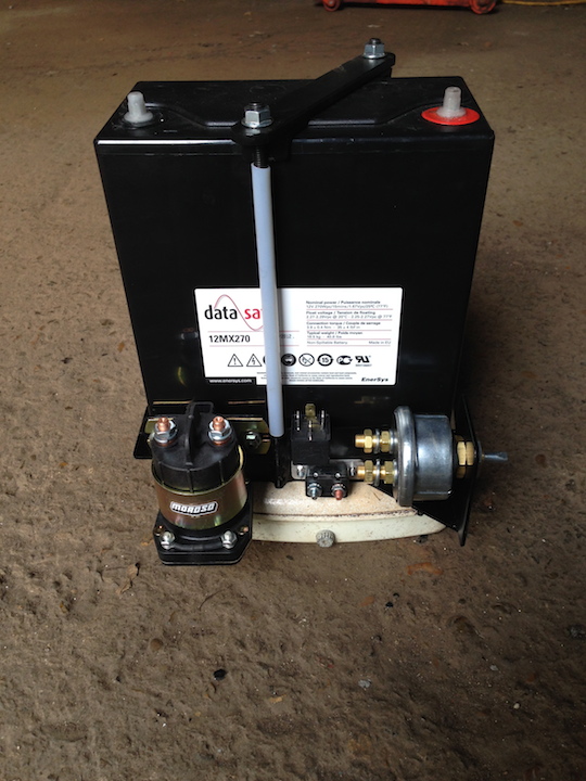

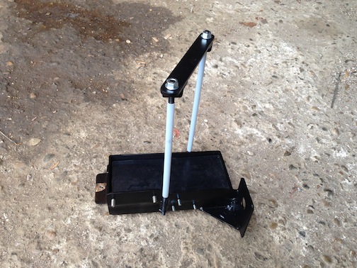

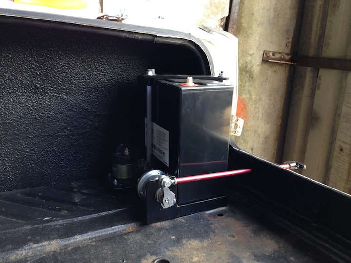

Made a battery tray that also holds the other electrical gubbins I need to have in the boot. The battery is a power vamp gel which has a hefty output for it's size, then there's an alternator cut off solenoid, fuel pump relay and circuit breaker and the master shutoff switch.

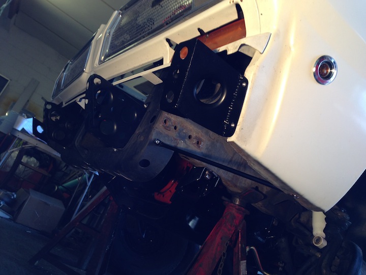

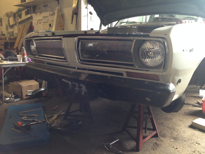

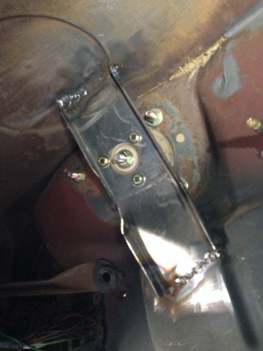

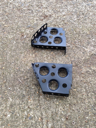

Front bumper brackets, they weigh 4 fifths of not a great deal so I think that's light enough. Bumper is a very used fibreglass item which will be fine when I've repaired it, it's held on by 4 Dzus fasteners, and the whole shooting match weighs a little under 3 lbs, so that's a 25lb saving over the original item. I also replaced the solid steel wing stays with ally tube.

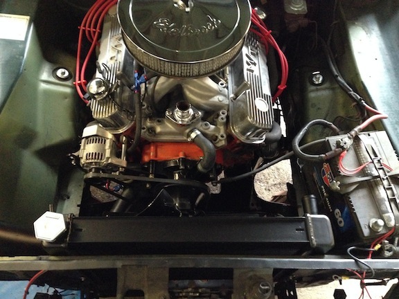

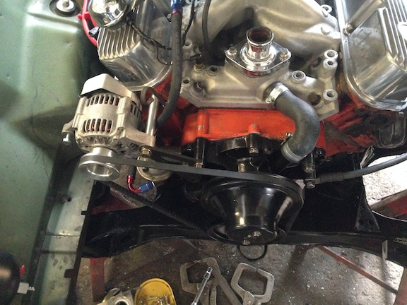

Denso alternator fitted, needed a spacer and a custom offset pulley for everything to line up, Trev can now supply these parts, just need to wire it up now, in fact a general tidy up of under hood wiring is long overdue. Fan, catch can and rad all fitted back in, need to find a suitable top hose next.

Liking the battery tray very much :thumbright: What type of paint did you use for your ally rad?
Posts: 14431
Painted the rad with Eastwood black satin radiator paint from Frost.

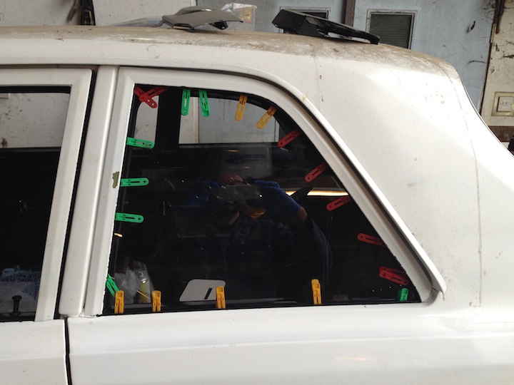

Fixed Lexan rear side windows in. All attempts to bend the lexan over the original glass and get it to take a set failed miserably. I resorted to fitting it into the original rubbers and wedging in plastic pegs from the back to force it into the correct profile. I then carefully masked up the frame and the lexan leaving just the gap where the rubbers and window whiskers are, I filled that with black mastic and smoothed it off before removing the tape. I left it a couple of days then removed the pegs, it's fixed and retained it's shape so job done.
Nice work Blue.
How much glass will be replaced by Lexan ?
I imagine you could do all apart from front screen ?

small stuff you can do in the oven. i think 160 (you will need to experiment as too high the lexan will bubble) degrees is the temprature it will go soft.
i did the S800 rear screen by just bolting a flat sheet to the tailgate and it took the natural shape.
lots of nut serts and countersunk allen bolts. doesn't cost much with ebay stuff.
