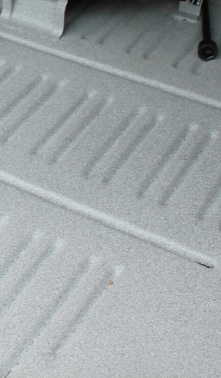

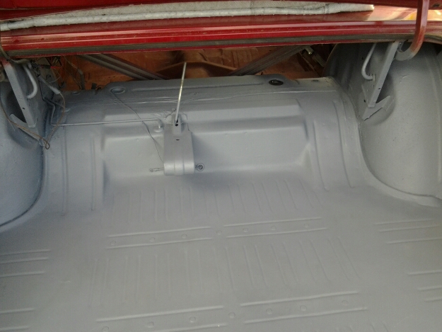

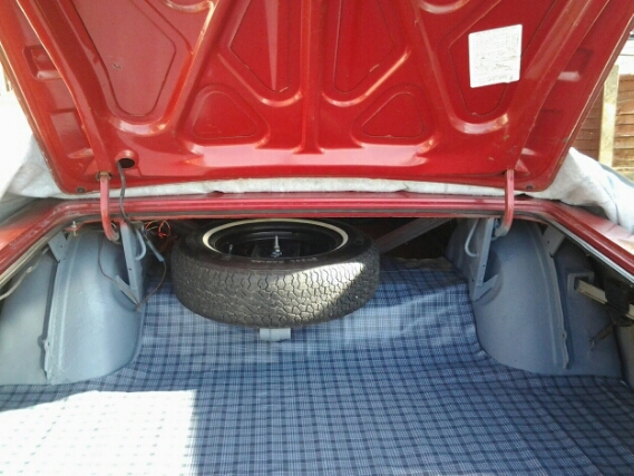

Finished the trunk off, all painted and new trunk mat in etc. Pleased with the results, and solid as a rock now :thumbright:

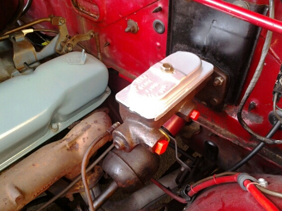

Took the old single circuit master cylinder out and put the new dual circuit one. Bit fiddly getting to the plunger to disconnect it from the brake pedal but got there minus a bit of skin on the old knuckles. Swapped the old plunger and spring etc over into new one. Fixed the brake light switch while I was there.
Will sort new brake pipes this week hopefully then on to bit of lighting wiring.
cheers Steve :thumbright:

steve considering all the effort you put in to that trunk i would sure as hell cane it in red 2k much sweeter to open it to show it off either for your self or come sale time,,,,,,
Posts: 7454
Im keeping her original where possible Dunc so have gone down the grey stonechip route. Its got the same texture as original, but is the wrong shade of grey. Eastwoods do the correct darker grey with white spatter in it but it is very delicate and not waterproof. When I get some, I will cover it with matt laquer to seal it :thumbright:
Steve wrote:Im keeping her original where possible Dunc so have gone down the grey stonechip route. Its got the same texture as original, but is the wrong shade of grey. Eastwoods do the correct darker grey with white spatter in it but it is very delicate and not waterproof. When I get some, I will cover it with matt laquer to seal it :thumbright:
thats good steve, but joe egg on a buttie wont know any of that nonsense when you come to sell it, a nice shiney trunk you can wash down any staining is far better than that grey stuff, it will look so much better in gloss red paint, most mopars are painted body color in the trunk,,,,,,,
Posts: 7454

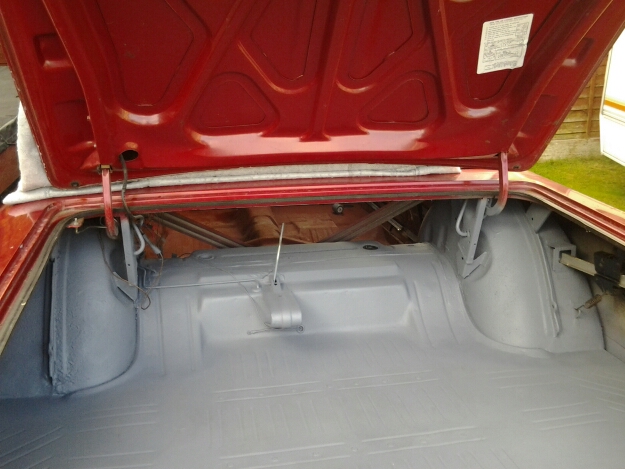

I hear ya big fella but sticking with original where possible at the moment....Ive got the engine bay back to stock looking and am enjoying doing it as it was (ish) from the factory. The mat is perfect for the bits of the original mat that were left and here are a couple of pics of what Im aiming for. Second pic is more like the colour mine should be from the original stuff left prior to resto but first one shows the white spatter in the paint as it should be :thumbright: Appreciate your thoughts and input as always Dunc....
