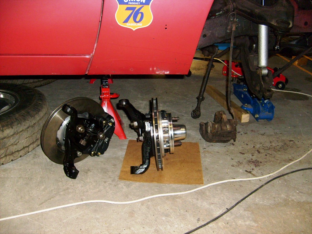

Fitting the new wheels, discs and calipers today and weighed the new ones versus the old ones.
Old wheels + old discs + old calipers = 39.5 kg
New wheels + new discs + new calipers = 23.7 kg
Overall weight saving = 31.6 kg ( 69.5 lbs )
And that`s just one mod.

My Wilwoods had to go on a drum brake spindle, rather than disc spindles. Perhaps that is the difference?
Loving the build 8-) 8-) 8-)

These spindles I made from the old disk spindles that were on the car.
Shame you`re not still around ... could have had a bit of head to head Valiant racing.
