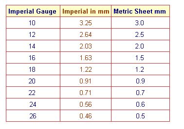

Technical Question
Before i go and buy sheet metal to patch rebuild this car can someone confirm if im correct.
I will use 1mm thick for the floor and front wings ect
and use 2mm thick for the chassis rails.
will this be ok :? :? :? :? :?
Measure the thickness of the existing steel? :?
I have and im getting around 2mm on rails and 1 mm on pannels
Just want to ask to see what others use :?
Posts: 13002
Hey Will, if my memory serves me correctly, the B body panels in 1968 will be 18 gauge and the chassis rails 14 gauge.
Gauge i had to googgle that :oops:
Perfect thanks
2mm
and 1.2mm :thumbright:
Sheet Metal Gage Gauge to mm Conversion Table - Windows Internet Explorer bereit_2011-11-04_11-26-42.jpg
Sheet Metal Gage Gauge to mm Conversion Table - Windows Internet Explorer bereit_2011-11-04_11-26-42.jpg (23.02 KiB) Viewed 2269 times

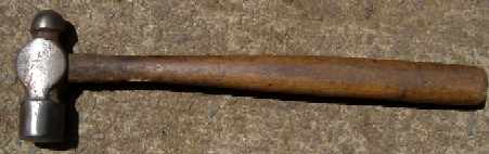

Think i will go with Dave hammer vice route to save some money :thumbright:
Mr Ball-peen and me have always had a good working relationship. :D
