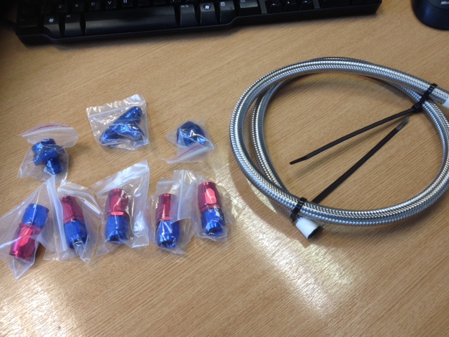

More new on that front - fittings arrived today. Looks good - will get them in this week.

Bling is proving troublesome - braided hose does not readily fit into the adapters. May have to ditch it and go rubber... Will try properly at home.

Braided hose is a real git to assemble until you've done it a few times, then it's just a git....
Yes you must stock up on Elastoplasts before you start. :thumbright:
Yep, you also need to tightly wrap with tape before you cut with a thin cut off wheel or Dremel. Don't set about it with a hacksaw, you'll end up with a horrible frayed mess. I only do brake, fuel and oil pressure lines in braided these days, and that usually ends up in bloodshed :lol:
I have all this to come
Thin Alu disks on a grinder
And loads of Electrical tape that you cut though
Any tops tips let is know

I used electrical tape but it melted, I found masking tape ok , many turns and tight as possible. ;)
I used a hacksaw with fine blades but it took patience!

Oh. Now I am concerned. I did it all last night before reading this and it seemed to go well. Usually when you guys say easy it take me weeks. Now you are saying hard and I manage it in an hour or so. That doesnt seem right... (masking tape first, fine blade hacksaw. The fittings I had were cut with a reverse thread in the sleeve; holding the pipe gently in a vice, holding the sleeve in a set of grips I managed to keep my hands away and get the pipe seated. After that it was just screw in the actual fitting... )
I should have taken a picture but I think I am all done.
Of course at the moment I have not run fuel through it (so it could spray everywhere) but I dont think so). I put fingers over the fitting ends and sucked the pipe end onto my tongue and it hung there without losing vacuum... I figured that probably meant it had sealed...
Will bolt her up tonight.
If it makes you feel better I drew blood a couple of times BEFORE working out that I could achieve the correct torsion using a set of grips end on.
I am not describing this very well. I will take a pic tonight.
Some are easier to assemble than others, the trick is to get the hose into the coller at the right depth so that you can assemble it without pushing the hose out of the coller as you do so, and ensuring you have no ragged edges of braid to gall up the threads. I've never managed to get a clean cut with a saw. If it's all assembled ok it will be leak free.
