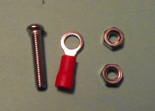

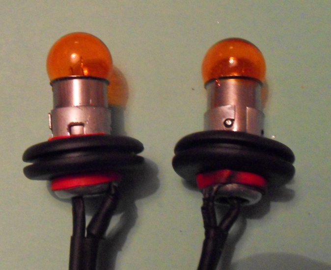

Next, I have run new single wires from all four corners to the area where the switch connects into the cars wiring ready to be joined to switch when replaced.

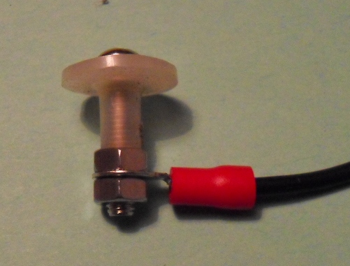

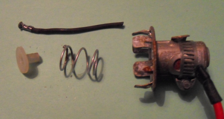

Didnt want to use the old fittings in the bulb holders so I snipped the wire, released the spring and plastic plunger that contacts with the base of the bulb. Put a small, snug fitting bolt through the plunger and put a single plain nut on the back. Next, put a ring connector onto the main wire from the switch, crimp, then strip off the plastic insulation. If you leave it on, it makes the new connection too thick and the spring wont depress enough to allow the bulb to stay in.
Next, put the ring connector onto the bolt, attach it with another nut, then bend the ring connector down onto the side of the nuts. Slide a piece of heat shrink up over the nuts and onto the plunger and now you have a new wire directly to the bulb which is insulated from the casing (earth).
I then attached separate earth leads to the outer casing of the holder to run to an earth point on the trunk next to the bulb holder housing. To test the earth lead, put a bulb in the holder, then do a continuity test from the side casing of the bulb and the end of the earth lead. If it beeps, the earth is good. Final test, continuity test from the bolt head that will contact with the nipple on the bottom of the bulb and the end of the wire to the switch....
Finally, I have had to make up some front indicator bulb holders as per pic. The insides are same as described above, with a bolt replacing the original dodgy connector.
The earth lead pic is just for illustration, I will wire wool the casing clean before final installation to make sure of a good earth.
Next job...fit it all when I get a dry day!!!
Cheers Steve

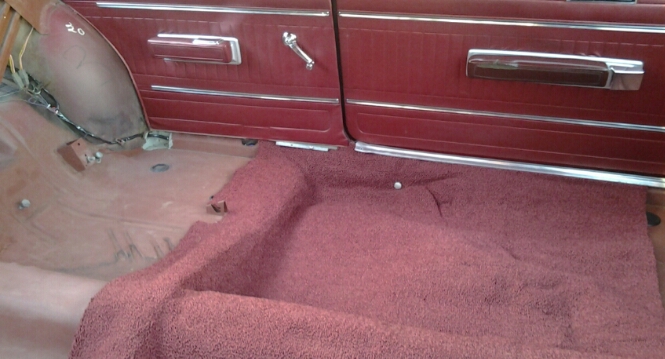

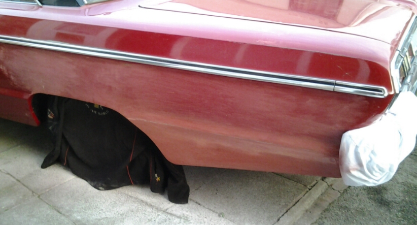

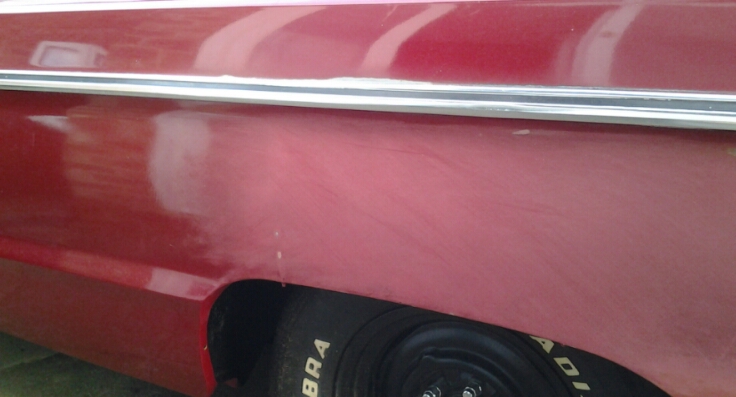

Managed a few hours on the Fury this weekend....after loads of messing around, Ive had to bite the bullet with the indicators. New switch on its way from the States.
While I am waiting, I finished off all the vapour barriers on the doors and rear passenger area, finished fitting new fuzzy strips on the door cards and re fitted them. I have also started fitting the new carpet. Finally, changed plugs, flushed cooling system and refilled with antifreeze and made a start on getting the crazing out of the paint on the drivers rear quarter.....
Quite a productive weekend
cheers Steve
cheers Steve
