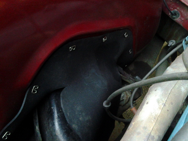

Had a couple of hours free today so made and fitted some new rubber splashguards for the inner fenders. Used some nice rubber matting thats used on old landrover floors that I found at a military show.
Cheers Steve :thumbright:
They look great
Did you have the old ones as a template ?
Posts: 7454
Thanks Gaz...got a spare set for the Polara that I used as a template. All of the 65-68 C bodies are the same :thumbright:
