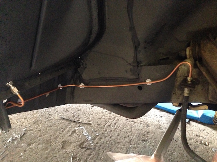

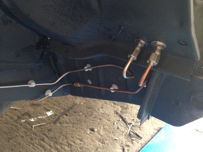

As requested, showing bulkhead fittings where the brake lines pass through the er, bulkhead....

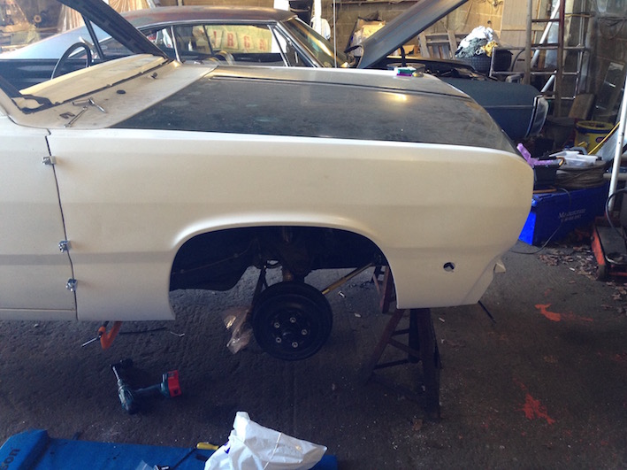

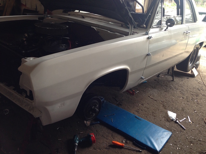

Enough of that, time to save a bit more weight! 'glass front wings, made by Dale so required very little fettling. They practically bolted right on, and are a nice fit.

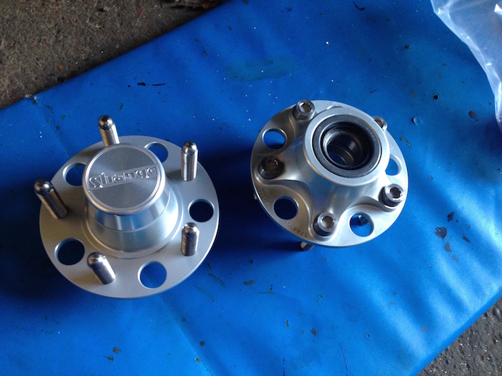

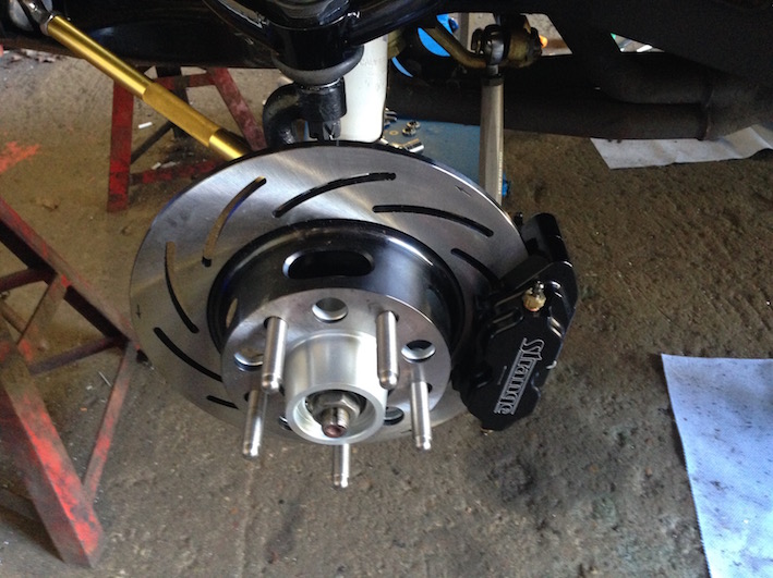

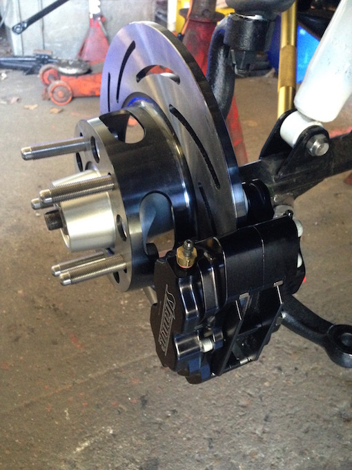

Brakes today! Searched long and hard for the lightest aftermarket brake kit available, this is it made by Strange, it's a lovely bit of kit.

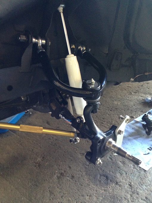

I used the lighter 9" drum spindles which I had to ream out to take the large balljoint chrome moly tubular upper control arms.
Everything fitted well although setting the camber and caster took a good few hours but it's all done now.

Looks good Blue
I can`t see what`s going on at the front end ... did the hubs / spindles come from Strange ??
What UCA are they ??
Weighed it yet ???????

What about steering rack ... type and position ??
Posts: 14459
Yes Jon the hubs come with the brake kit. The spindles are standard 9" drum spindles, the upper control arms are by Magnum Farce, the lower arms and struts by QA1, the tie rods from Hotchkiss. This ones not getting a rack.....
Posts: 6740
Looking good Blue, some nice choices of parts :thumbright: I'm biased though & partial to Strange equip ;)

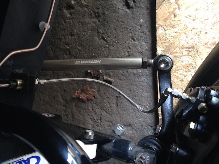

Here ya go Pedro, new braided hoses!
Posts: 22139
That's the way to go for a nice firm feel!! :shock:
Are you sure those big old school front tyres won't rub on the chassis rails and pipes?? ;)
Posts: 14459
Yep, all checked and clear sir!
Posts: 22139
What tyres have you gone with, and size; chap?
Posts: 14459
My usual 7.10 x15 Moroso Drag specials. Might need to trim the front edge of the outer arch a bit but I expected that, no big deal.
