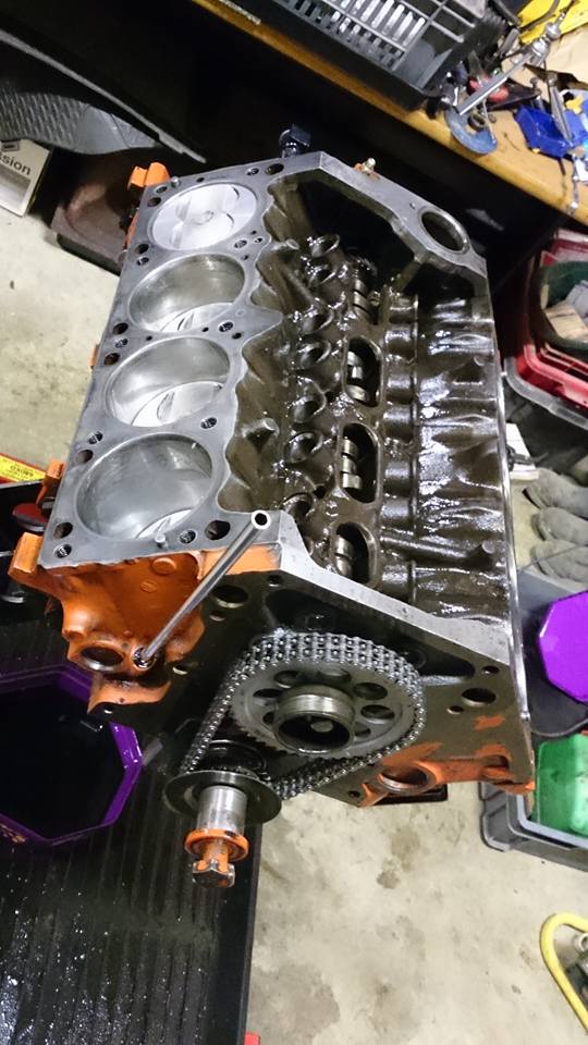

Mixing threads a bit so I'm just bringing this back to my main car one :)
Having now damaged a bottom compression ring on piston #7 I have decided to refresh the lot. The reason I didn't before was just down to bores looking good and all existing ring gaps being around the 0.023-0.026" range.
I have just noticed on the earlier picture of my pistons lined up the #7 happens to be the first in shot. It looks like the 2nd compression ring is damaged or a burr sticking out? I Certainly didn't notice this on removal and there isn't even the slightest mark in the bore :dontknow:
I also went home and dug out last years compression test results and #7 is around 20-30 psi down on all the others which I had forgotten about. On the bright side I guess it's a good thing this ring failed now and not after putting it all back together :shock:

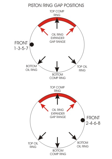

I have also drawn up where I understand the ring gaps should go (this is how I set them last time) but there seems to be different advice floating about on this. Does my drawing make sense and how important is it to get the correct locations?

Posts: 9561
you will be fine with that.
mind I had fun with rings
More important to get them in right way up. :)
if the instructions make no sense or contradict everyone else's advice....ASK
do you need to hone the bores?
do you still have a cross hatch pattern?
if you need to borrow a flex hone? I have one for 3.8-4.?? diameter holes.
its like a brush dipped in cement made from wet and dry paper abrasive coating
oil it
oil bore
spin it mighty fast in drill
waaazz it up and down as fast as you can
clean block, and your face and the wall because grey oily gunge goes everywhere
do ring gaps.
i.e that crank and all of the bearings will need to come out first.
your ring gaps seem quite big? take advice from others with big pistons
mine are small

Bores honed and new rings in this morning, no more work until tomorrow as I have a 70th birthday this afternoon (not mine [-X :lol: :lol: ) But hopefully back together enough tomorrow to maybe put the motor back in [-o< :working:
Any tips on 340 small block head refitting, I have new gaskets and it's all very clean :thumbright: :read2:

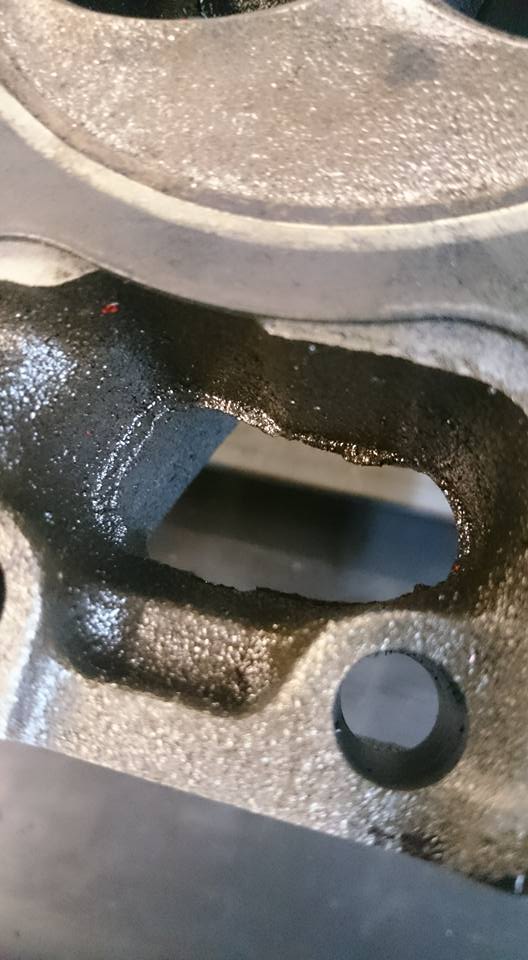

I de-burred the oil drain back holes in the heads when they where apart too. Seemed only right seeing as someone had done the block in the past but not the heads. Paranoid about grinding dust and dwarf so a lot of time was spent cleaning and cleaning again before rebuilding the heads :thumbright:

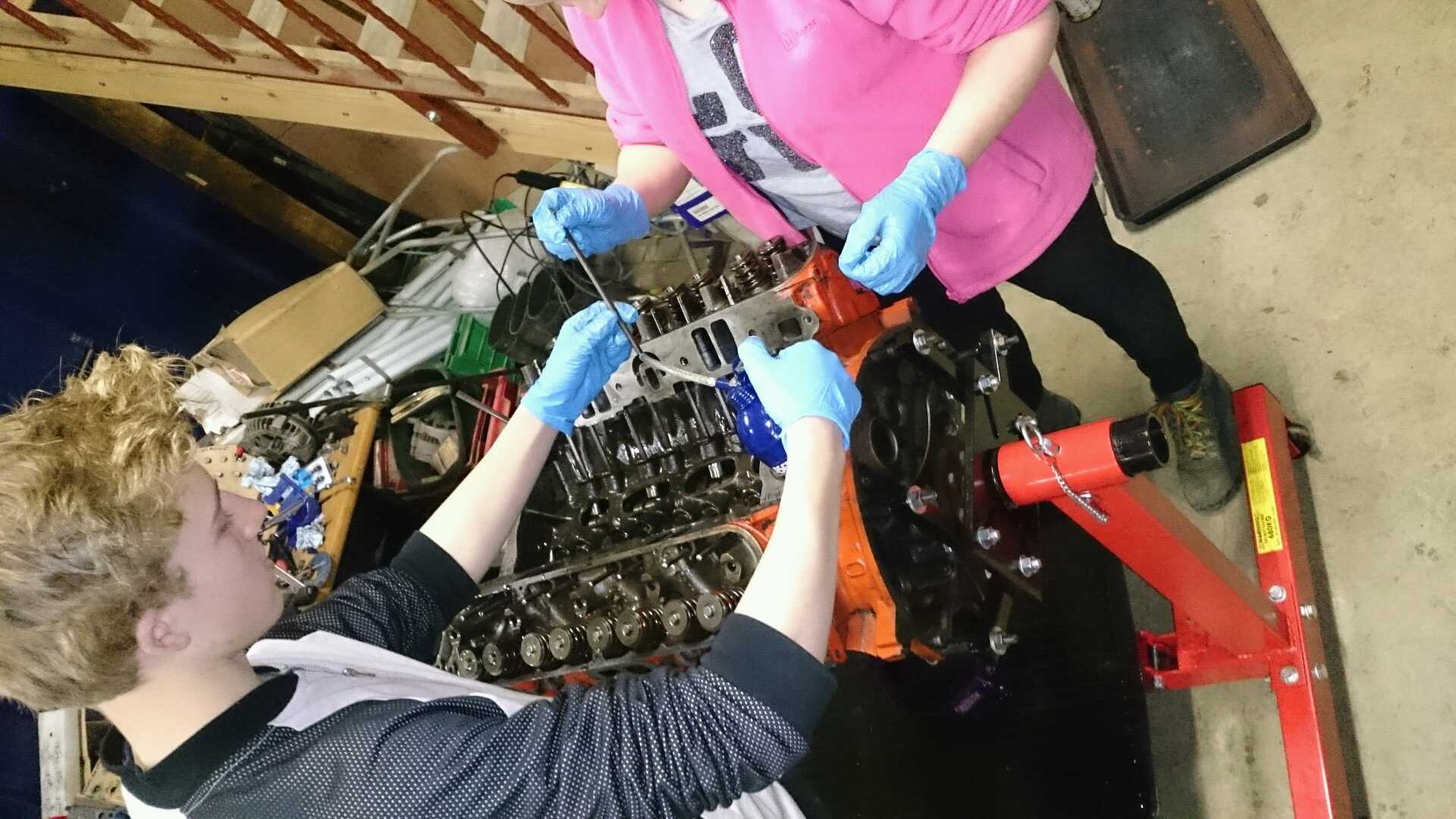

My band of eager engineers reciting the valve train :)
In tne market for a nice 750 Vac Sec now?? ;)
Posts: 1674
looks good it'll soon be back in :)
