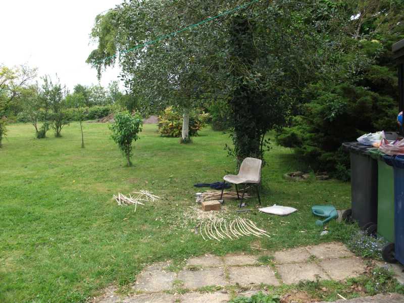

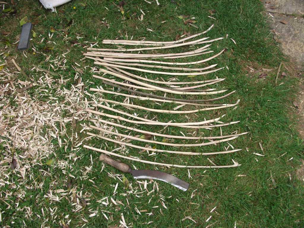

Well, a bit of progress, and I think I have spent more time working on the Thatcher's TATA pickup than he has on thatching (sort of......).
Seriously, there has been progress made.
I am now more qualified and I have finally advanced from straight sticks to bent sticks.....
These are actually used around Window openings and other adornments where the thatch is curved. You make these by soaking overnight and sharpening one end and then breaking the back of the Spar every 2 inches or so to make it curved......
Bent Sticks 2.jpg (178.6 KiB) Viewed 1176 times
Bent Sticks 1.jpg (91.49 KiB) Viewed 1176 times

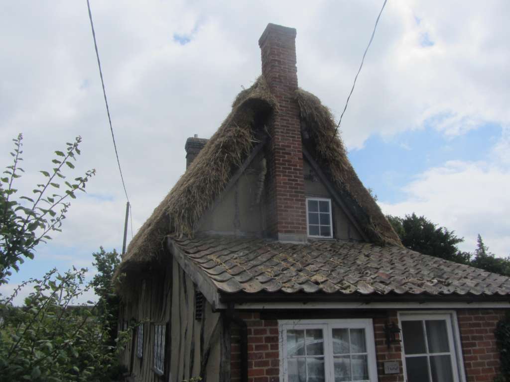

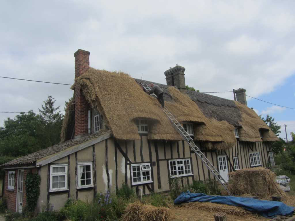

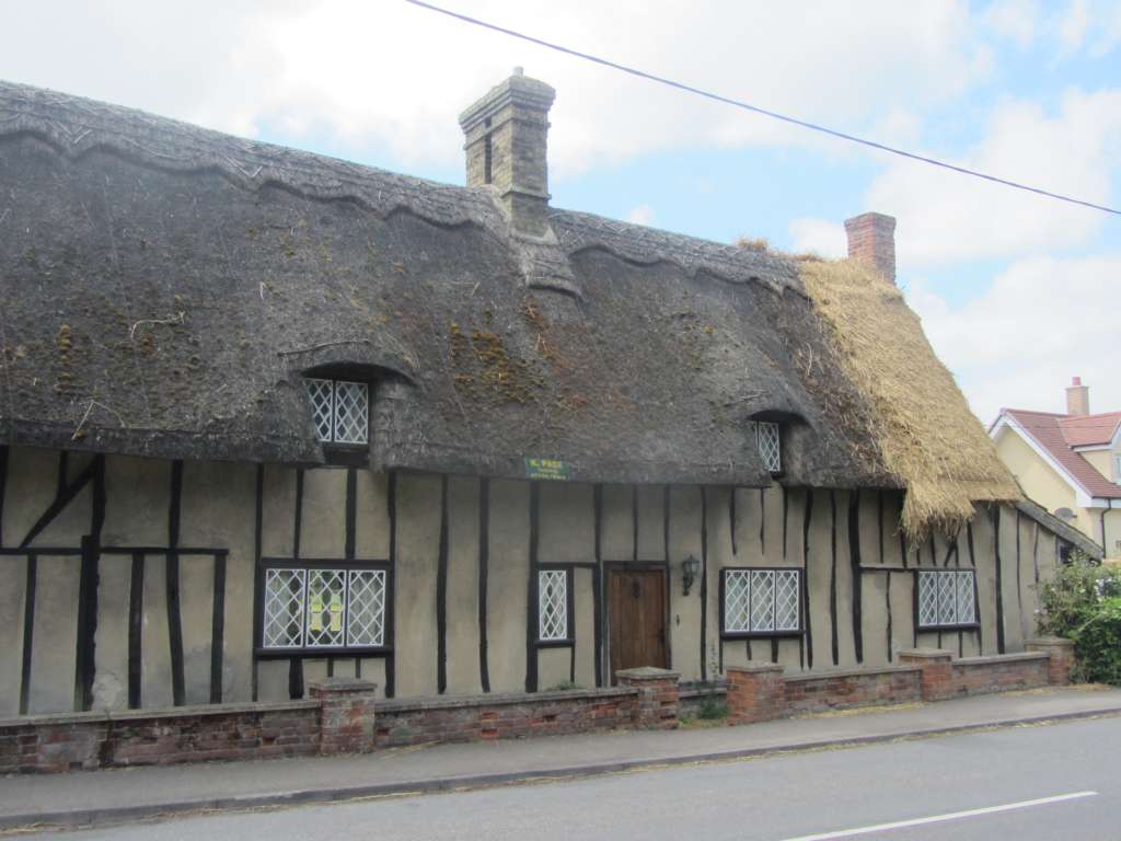

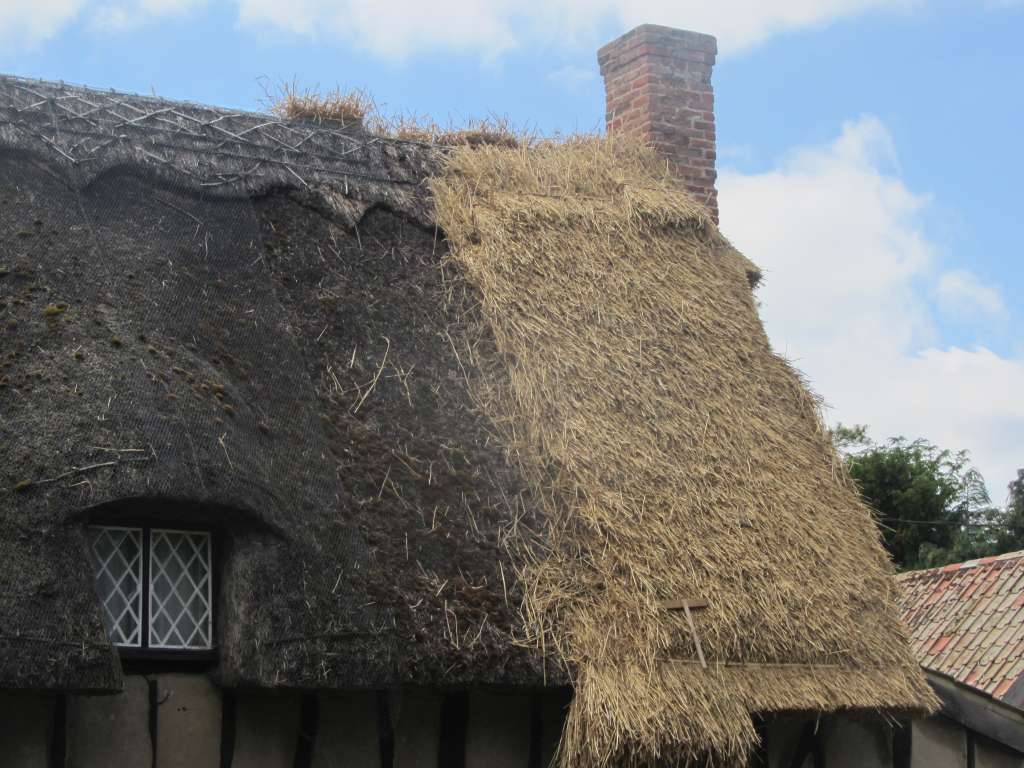

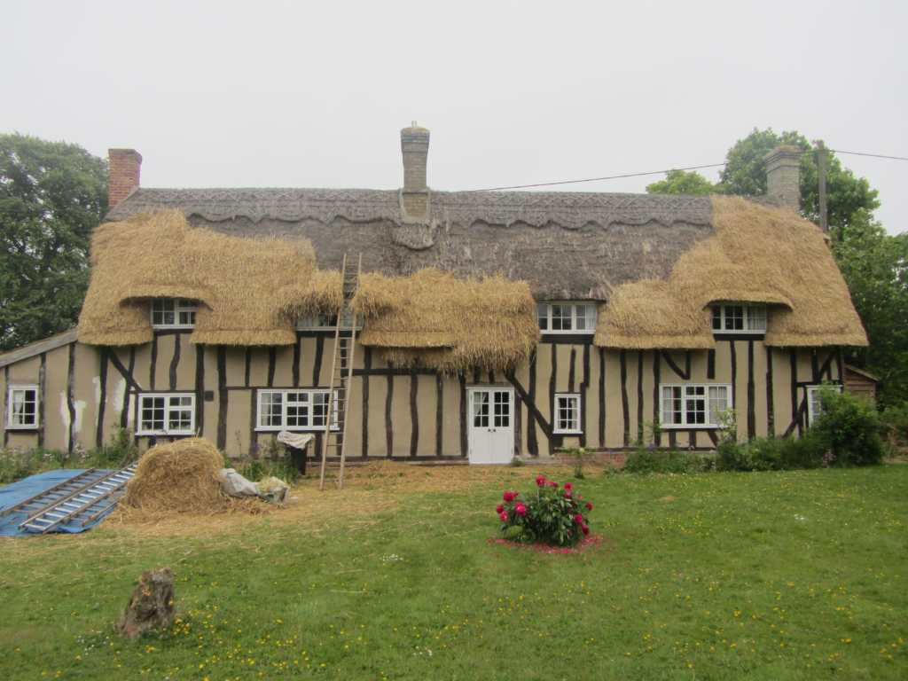

..And general progress on the back of the cottage...
The Thatcher has started on the Front Elevation so that he can then work down the roof on the Ridge. I was surprised at how much material he has had to put on the front......
June Progress 4.jpg (74.17 KiB) Viewed 1171 times
June Progress 3.jpg (168.09 KiB) Viewed 1171 times
June Progress 2.jpg (85.45 KiB) Viewed 1171 times
June Progress 1.jpg (75.05 KiB) Viewed 1171 times

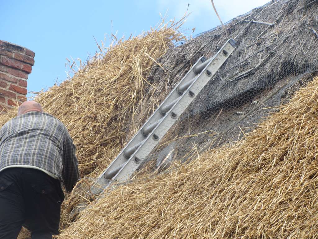

Posts: 22109
Last lot:
June Progress 6.jpg (83.49 KiB) Viewed 1166 times
June Progress 5.jpg (114.62 KiB) Viewed 1166 times
Wow a ton of work ,good thing for the handy chicken wire ;)
Posts: 22109
That wire is coming off, Drew.
The Thatcher thinks that we will end up using 6 tons of straw....and then shed loads of Chicken Wire going back on to keep the birds off!!!!
