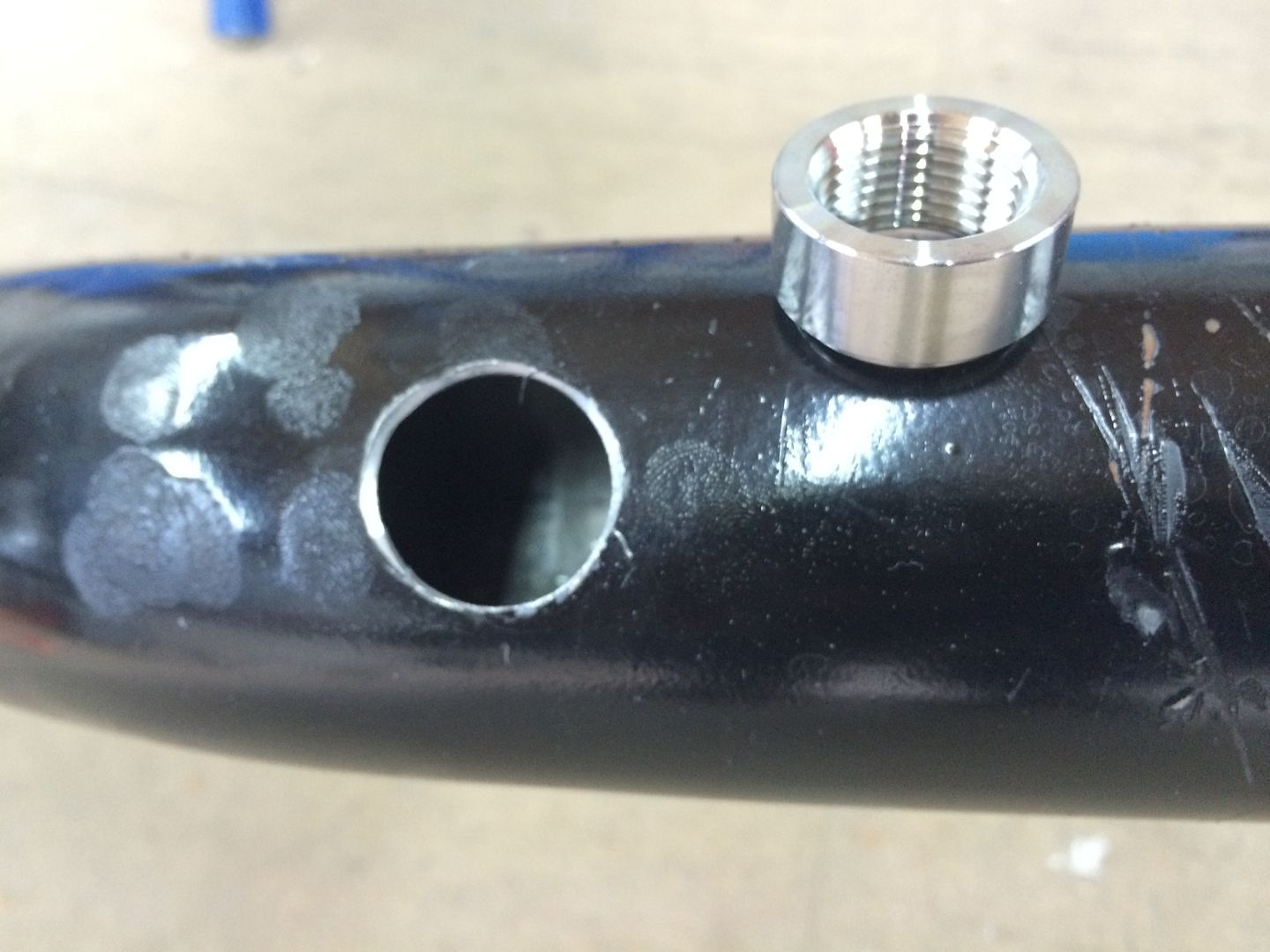

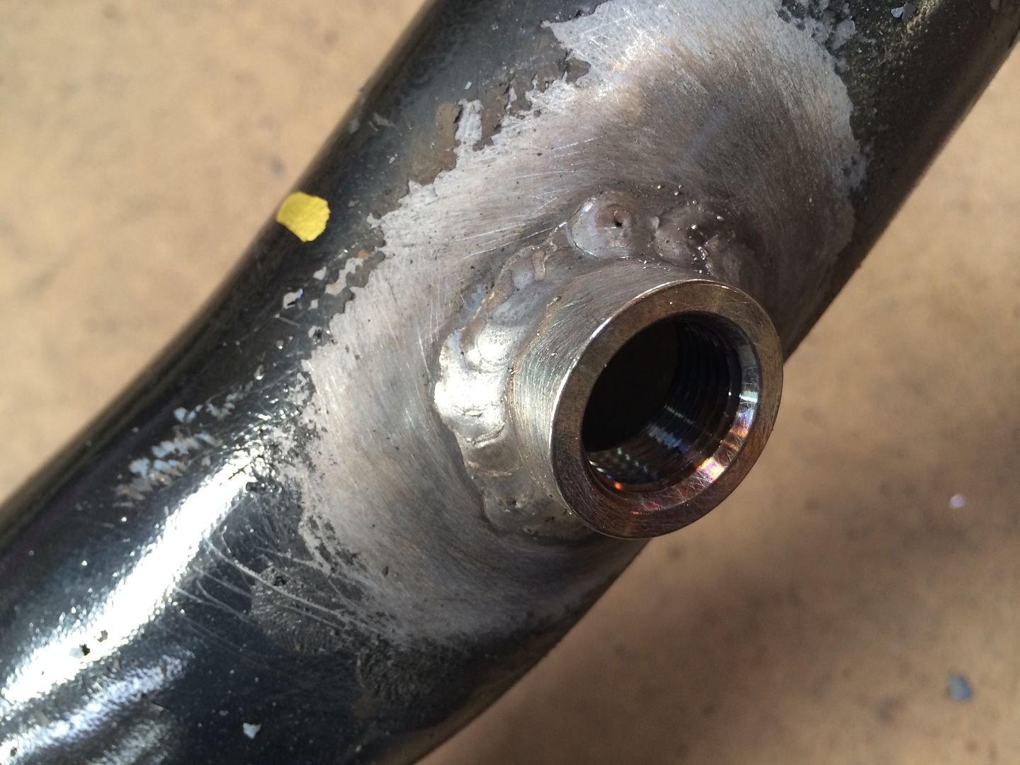

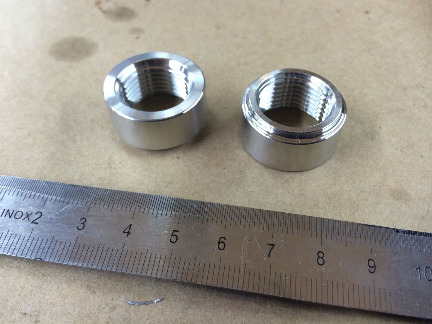

Next up I welded exhaust bungs into the exhaust.
Into these I will screw in lamda sensors.
These will give information to the ECU (electric control unit) if the engine is running to lean or to rich.

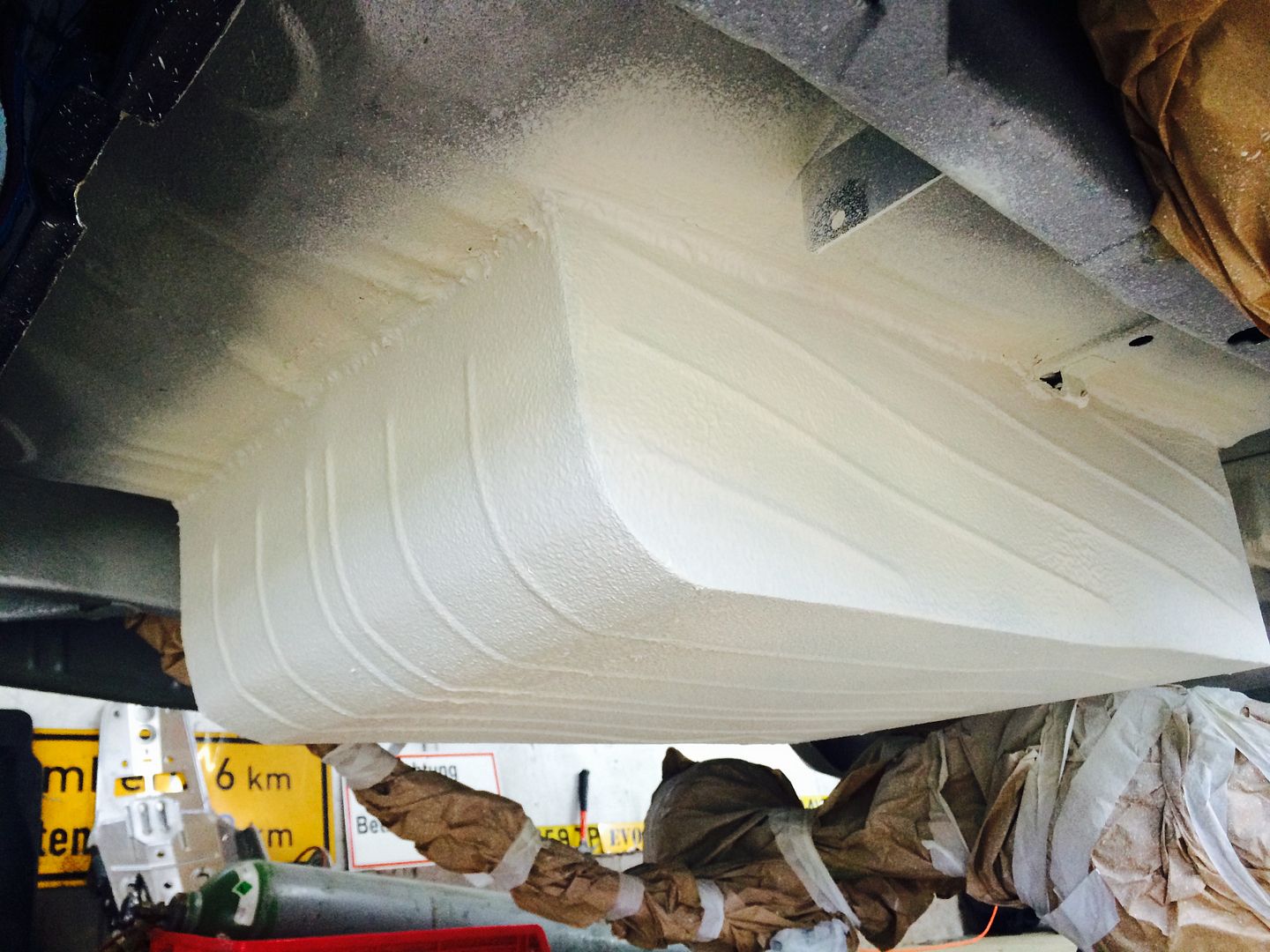

Fuel tank I went with a pre built all in one unit from aeromotive
Specs
20 US Gal
A1000 pump submerged
Pre filter
Efi baffled sump
Return line into sump
Rollover ball vents
Fuel sender
Sprayed the boot floor with my favourite stuff ( raptor spray truck bed liner)
I will use camping foam mats cut to size around the tank and make some straps to go over tank

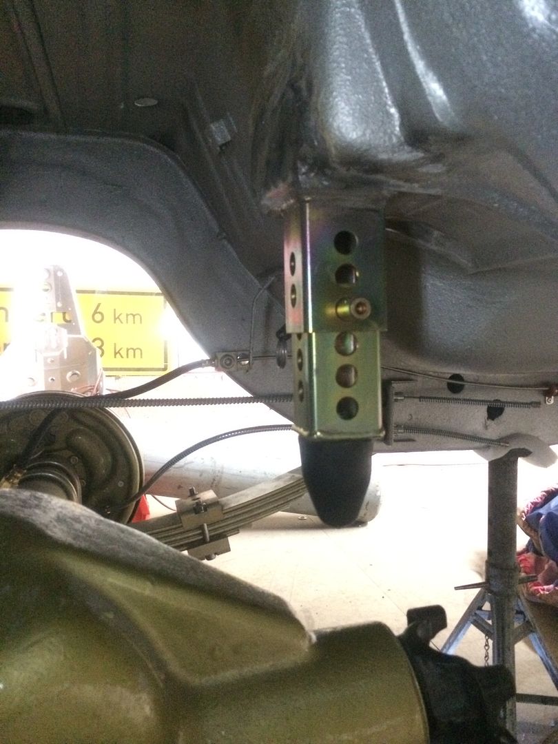

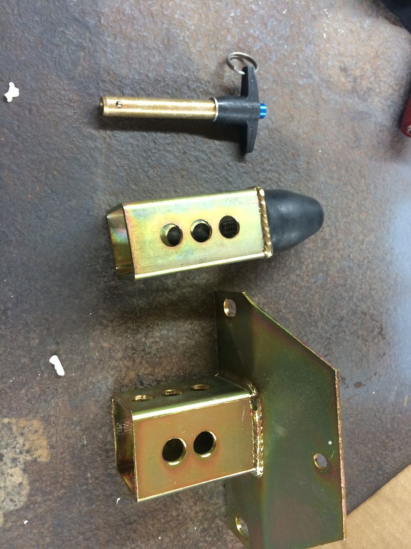

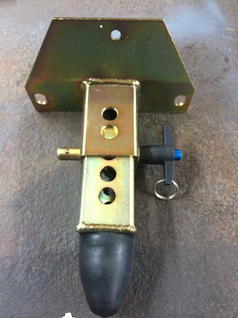

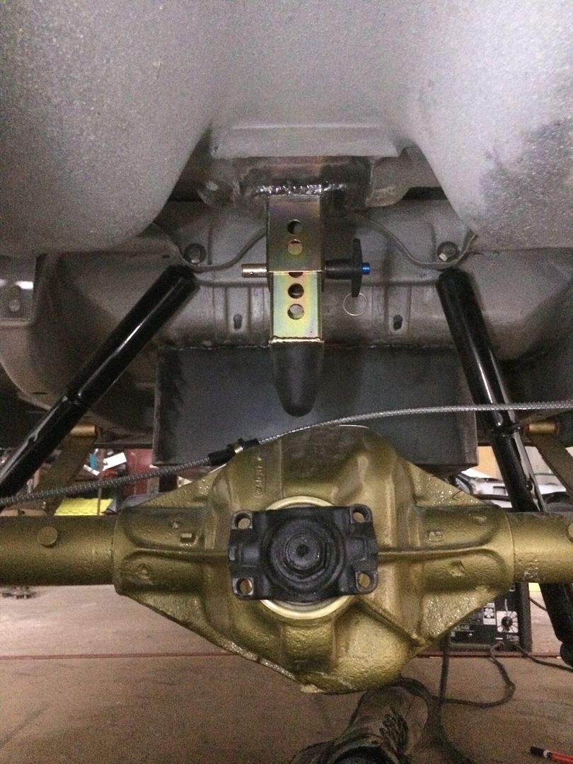

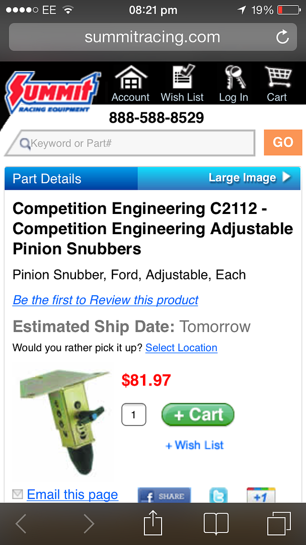

Pinion snubber Dana 60
A "real" car Dana 60 casting has a provisions for a snubber to be installed
<a href="http://s73.photobucket.com/user/autofet ... o.jpg.html" target="_blank"><img src="http://i73.photobucket.com/albums/i205/ ... j3tayo.jpg" border="0" alt=" photo A6B39D5D-0849-4790-9468-1D63B7CC639A_zpsfqj3tayo.jpg"></a>
<a href="http://s73.photobucket.com/user/autofet ... k.jpg.html" target="_blank"><img src="http://i73.photobucket.com/albums/i205/ ... s2eokk.jpg" border="0" alt=" photo E61F76B6-8EB9-4800-90B7-771CEDB9D472_zpsjxs2eokk.jpg"></a>
Truck Dana 60 are plentiful a lot cheaper but have no provision for a snubber.
As mine is a truck casting I got a snubber cut it bent it and stuck it to the floor
<a href="http://s73.photobucket.com/user/autofet ... g.jpg.html" target="_blank"><img src="http://i73.photobucket.com/albums/i205/ ... 9rpstg.jpg" border="0" alt=" photo B6494531-13EC-4205-9585-9547AABD6D71_zpskf9rpstg.jpg"></a>
<a href="http://s73.photobucket.com/user/autofet ... t.jpg.html" target="_blank"><img src="http://i73.photobucket.com/albums/i205/ ... sjnxbt.jpg" border="0" alt=" photo 5B4A9F70-F3A6-4B0B-B234-2659BCCC9D51_zpsomsjnxbt.jpg"></a>
<a href="http://s73.photobucket.com/user/autofet ... l.jpg.html" target="_blank"><img src="http://i73.photobucket.com/albums/i205/ ... r7u5sl.jpg" border="0" alt=" photo AF4792AA-8901-4195-BDB2-AFD53DF6C20A_zps6jr7u5sl.jpg"></a>
<a href="http://s73.photobucket.com/user/autofet ... v.png.html" target="_blank"><img src="http://i73.photobucket.com/albums/i205/ ... 9qokiv.png" border="0" alt=" photo FAC90BB6-F9E4-4480-B1CE-128FA968B784_zpsen9qokiv.png"></a>
<a href="http://s73.photobucket.com/user/autofet ... 1.jpg.html" target="_blank"><img src="http://i73.photobucket.com/albums/i205/ ... fsceg1.jpg" border="0" alt=" photo 0D0957D9-341C-475E-A15C-43D12BB2D3BB_zpsvbfsceg1.jpg"></a>
<a href="http://s73.photobucket.com/user/autofet ... b.jpg.html" target="_blank"><img src="http://i73.photobucket.com/albums/i205/ ... lc8qpb.jpg" border="0" alt=" photo DF164EB0-0930-45BF-BBAA-10A1AE6B4015_zps6plc8qpb.jpg"></a>

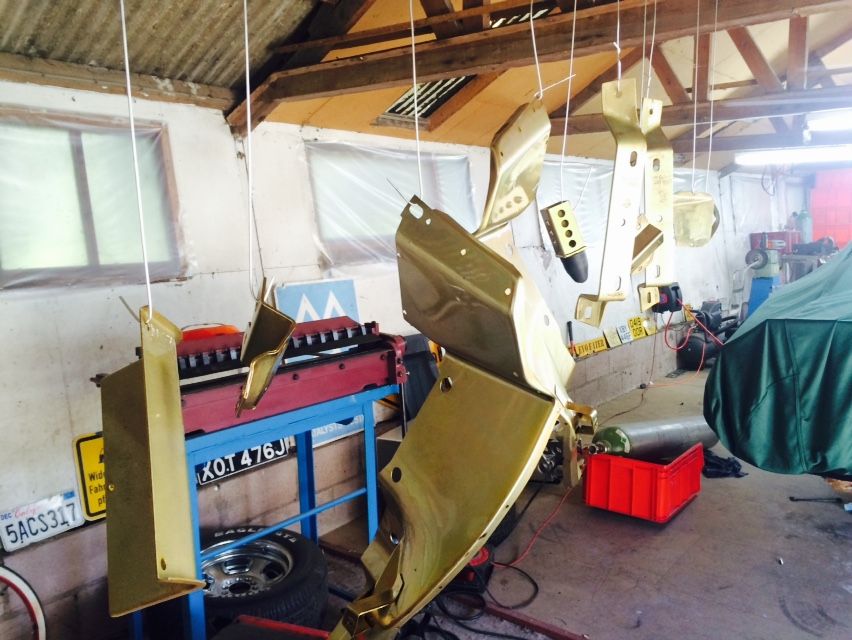

Painted floor and turned more parts into gold i love it

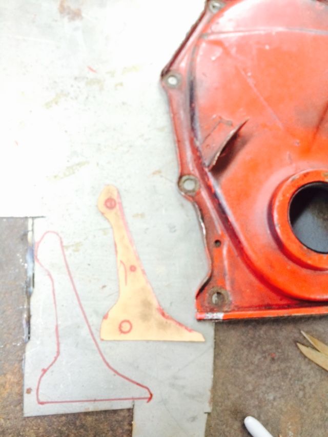

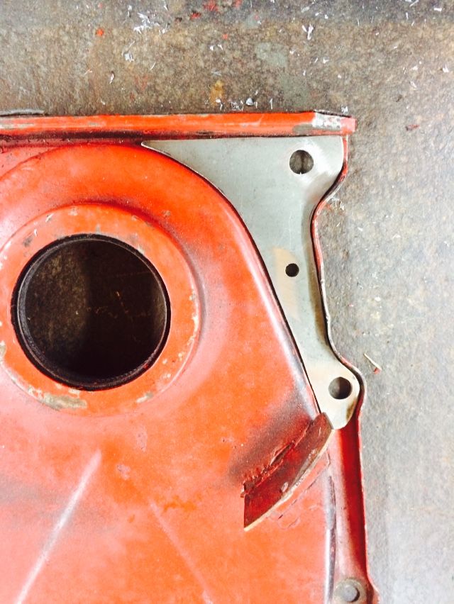

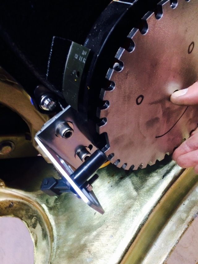

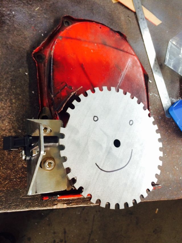

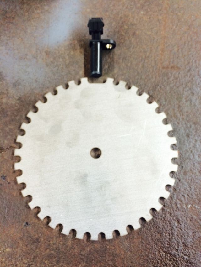

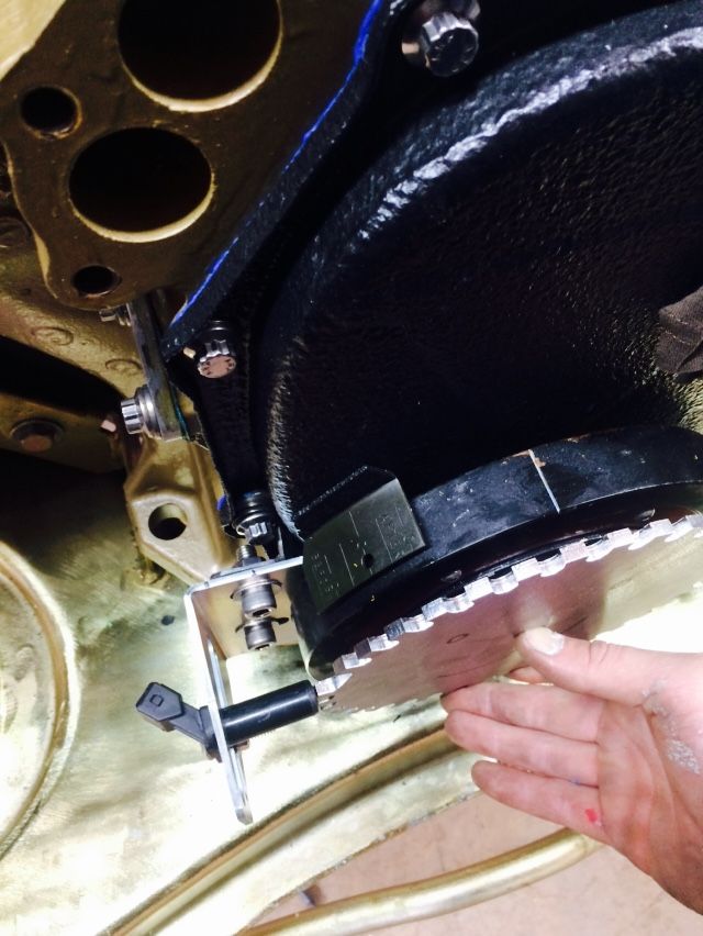

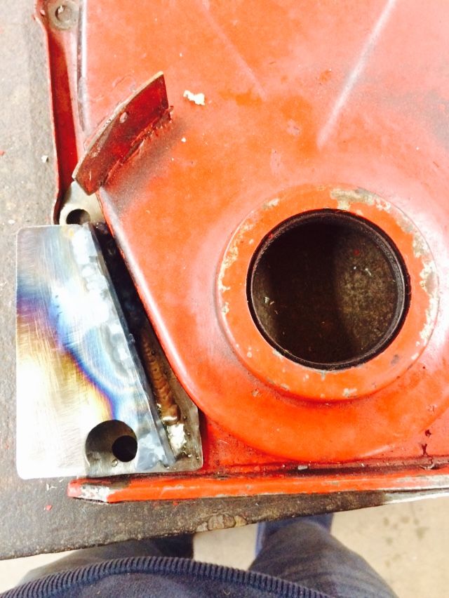

Engine position
The ECU (engine control unit) needs to know what position the engine is at.
The easiest way is by using a 36/1 (36 teeth with number 36 removed) crank trigger wheel with a crank shaft position sensor mounted next to it.
If your clever you could
on bottom timing gear with sensor in front cover
a giant wheel on ring gear.
buy harmonic with the tooth cut into it.
100 ways to skin a cat
<a href="http://photobucket.com/" target="_blank"><img src="http://i73.photobucket.com/albums/i205/ ... fbmqmt.jpg" border="0" alt=" photo 5235C20D-864F-4C77-B9D2-FD8FFD19D534_zps0ifbmqmt.jpg"></a>
<a href="http://photobucket.com/" target="_blank"><img src="http://i73.photobucket.com/albums/i205/ ... 6zbc6h.jpg" border="0" alt=" photo 2D7FC52D-5F22-4ED3-A349-B29D416DDB69_zps8r6zbc6h.jpg"></a>
<a href="http://photobucket.com/" target="_blank"><img src="http://i73.photobucket.com/albums/i205/ ... czpjau.jpg" border="0" alt=" photo 5EECF13D-2C57-412E-A10F-7853DFDDC9F3_zpsffczpjau.jpg"></a>
<a href="http://photobucket.com/" target="_blank"><img src="http://i73.photobucket.com/albums/i205/ ... eskjxa.jpg" border="0" alt=" photo 8B74E9B8-DEDC-4ADF-A61E-8BEF4DF5C7AB_zpss7eskjxa.jpg"></a>
<a href="http://photobucket.com/" target="_blank"><img src="http://i73.photobucket.com/albums/i205/ ... anxohp.jpg" border="0" alt=" photo A67F98E8-36F0-40CE-BBA4-45CBED3386EC_zpsjzanxohp.jpg"></a>
<a href="http://photobucket.com/" target="_blank"><img src="http://i73.photobucket.com/albums/i205/ ... 8krzr8.jpg" border="0" alt=" photo 033DCCF4-698A-4413-A7F1-6500DF888E07_zpscx8krzr8.jpg"></a>
<a href="http://photobucket.com/" target="_blank"><img src="http://i73.photobucket.com/albums/i205/ ... uhhutj.jpg" border="0" alt=" photo DA2F8989-722D-434B-AFF9-7A823F08184B_zpsixuhhutj.jpg"></a>
The bracket i made allows for full adjustment of the sensor
