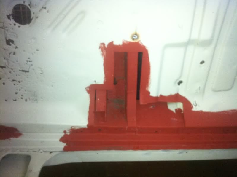

[quote="steveo also Will , you prolly seen it on your original inner back panel but make sure you make a re- enforcing plate where the tank straps go through ,

4mm plate

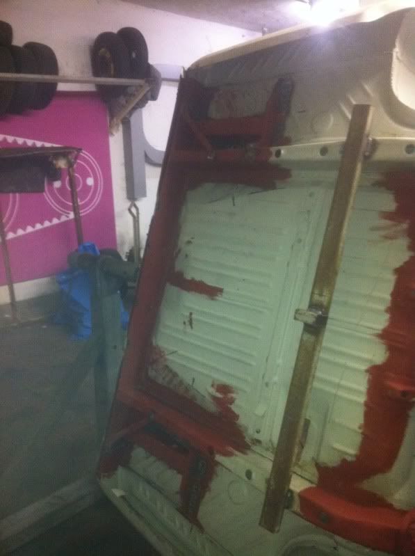

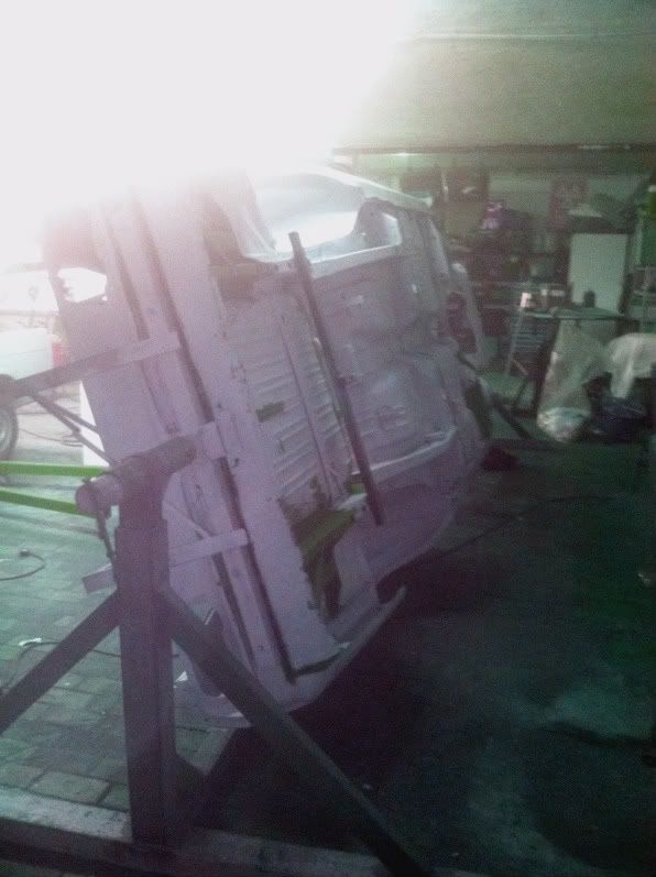

Got the spring hangers on and car back on rotisserie
<a href="http://photobucket.com" target="_blank"><img src="http://i73.photobucket.com/albums/i205/ ... ure175.jpg" border="0" alt="Photobucket"></a>
<a href="http://photobucket.com" target="_blank"><img src="http://i73.photobucket.com/albums/i205/ ... e176-1.jpg" border="0" alt="Photobucket"></a>

Superb Workmanship there Will!
For a Novice welder you sure do good some good work!!!
I've seen cars from 'pro workshops' that were nowhere near as good as this.

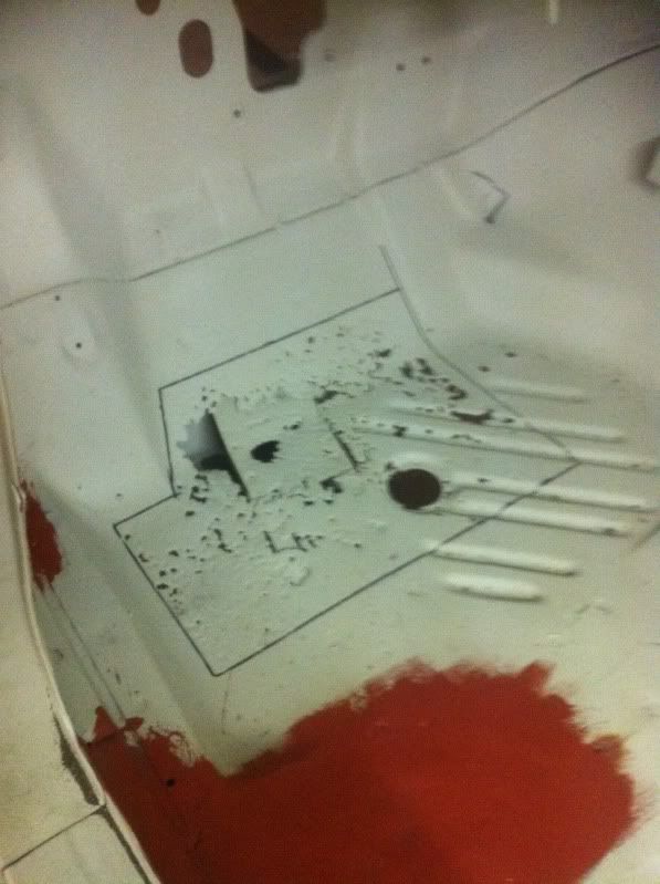

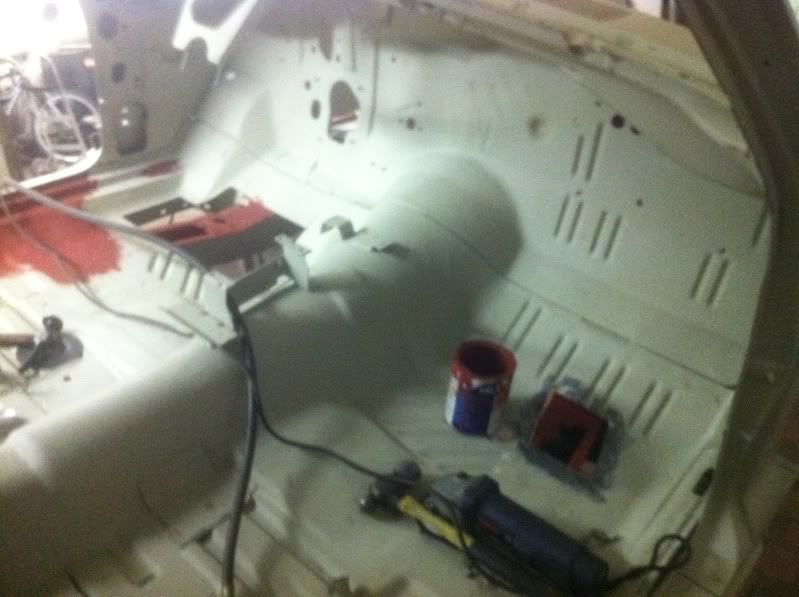

So last night was this Little hole in my drivers side floor pan
<a href="http://photobucket.com" target="_blank"><img src="http://i73.photobucket.com/albums/i205/ ... ure180.jpg" border="0" alt="Photobucket"></a>
<a href="http://photobucket.com" target="_blank"><img src="http://i73.photobucket.com/albums/i205/ ... ure181.jpg" border="0" alt="Photobucket"></a>

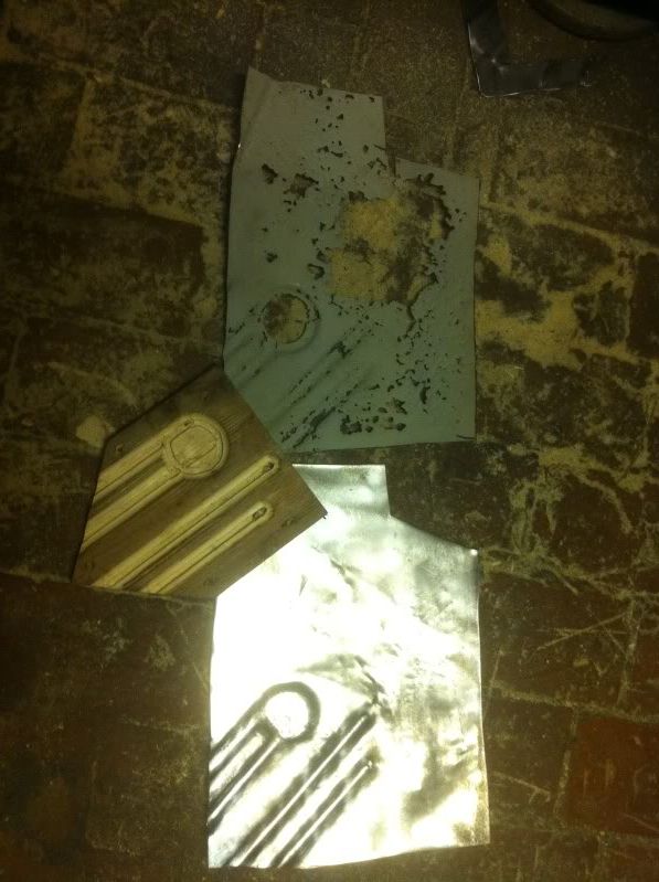

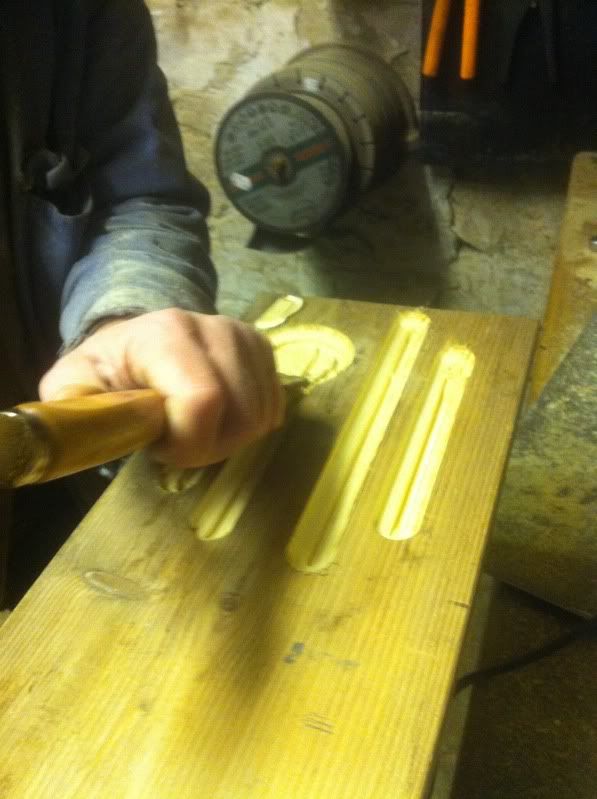

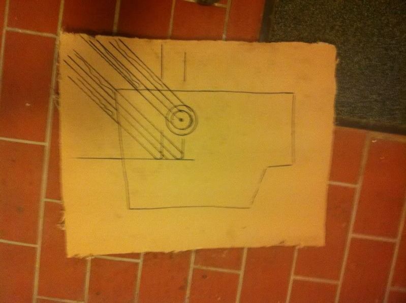

Q. The next area i need to hit is the main part of the drivers floor.
It has indentation in it the pro shop would have a swagging machine i dont. Is there anything i can do to make these groves. Hammer and make a wooden mold
What would you do ??

- latil
- Posts: 12076
- Joined: Tue Feb 01, 05 10:37 pm
- Location: Steve Pearson MMA/014. East Grinstead and Carmarthen.
I routed out a piece of hardwood with a rounded groove to suit the profile of the underside of the indent. Then find a piece of steel bar that fits the curve of the topside of the indent,mark out repair patch,place wood under and bar on top and either hammer down to make indent or for more even accuracy,I used where there was enough room,a pair of carver clamps. The limit with those is the jaw depth as to how far across the plate they will reach. I was very pleased with the results

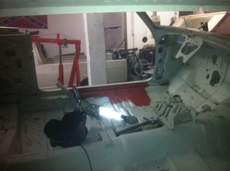

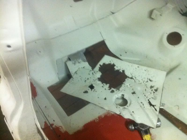

Still a little more hammer work to be done
<a href="http://photobucket.com" target="_blank"><img src="http://i73.photobucket.com/albums/i205/ ... ure182.jpg" border="0" alt="Photobucket"></a><a href="http://photobucket.com" target="_blank"><img src="http://i73.photobucket.com/albums/i205/ ... ure183.jpg" border="0" alt="Photobucket"></a><a href="http://photobucket.com" target="_blank"><img src="http://i73.photobucket.com/albums/i205/ ... ure184.jpg" border="0" alt="Photobucket"></a><a href="http://photobucket.com" target="_blank"><img src="http://i73.photobucket.com/albums/i205/ ... ure185.jpg" border="0" alt="Photobucket"></a><a href="http://photobucket.com" target="_blank"><img src="http://i73.photobucket.com/albums/i205/ ... ure186.jpg" border="0" alt="Photobucket"></a><a href="http://photobucket.com" target="_blank"><img src="http://i73.photobucket.com/albums/i205/ ... ure187.jpg" border="0" alt="Photobucket"></a><a href="http://photobucket.com" target="_blank"><img src="http://i73.photobucket.com/albums/i205/ ... ure191.jpg" border="0" alt="Photobucket"></a><a href="http://photobucket.com" target="_blank">

Wil
Well done fella for getting stuck into it
