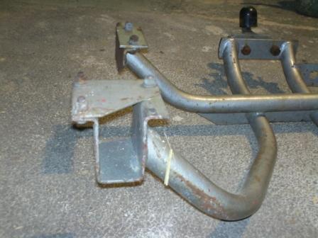

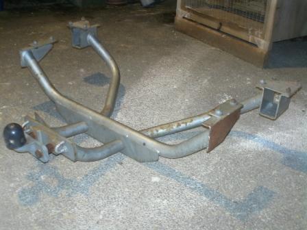

Posts: 5895
John R has one on his Barracuda I think, and I have a Valiant Charger one here which is 1973 A body, but came off a 69, so is probably the same as what you need. Its quite substantial.
paolo_mangusta
Posts: 592
Joined: Tue Aug 10, 04 1:34 pm
Location: Paul, London
Post by paolo_mangusta »
cheers Matt, that's a really useful pic. I haven't any way of bending tube so I might have to make something similar by cutting square tubing but really useful to see how it mounts

JohnR
Posts: 876
Location: burstow ,near Gatwick .
Post by JohnR »
yep have one on the car and made it myself will get a pic now that it is off , very simple to make just a couple of bits of angle bent in the right place and some flat plat mine fits under the bumper irons and comes down to fix under the spare wheel well quite strong if you put a plate in the well
